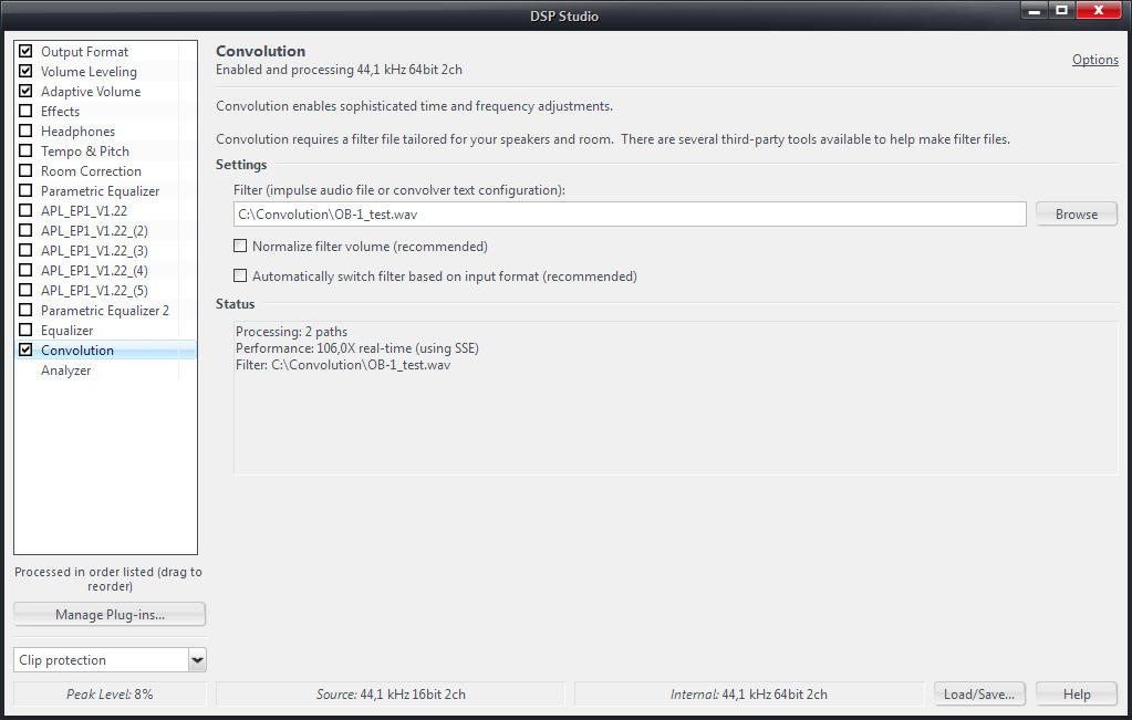

Great to hear it can work for others too and thanks report back because is bit sorry can't document better (expensive head phone measurement gear) other than show in simulation that reverse curves work right, and yes it takes more than a few songs to get used to especially if one hasn't speakers that are calibrated to more or less close to curves used in studios.
Have tweaked a bit more on OB-1 correction curve twocents listened after thinking over that Harman curve is to replicate curve from a good speaker in a good room, it means two more IIR (minimum phase) correction points plus one FIR filter moving phase curve little bit over broad range towards HF. For me OB-1 now play bass notes the closest to real real world personal ever heard in a head phone domain and also transfer listener much closer into recording room environment. Correction is attached below as one convolution file that when is loaded will correct all the 27 IIR and 1 FIR filters for OB-1. File is 44,1kHz so suggest play mostly tracks based this rate.
Would be nice if twocents ( xrk971 when time allows) will check it out and for help see below how to turn on this OB-1 correction in JRiver pointing to one file that has all the bits and pieces of correction included.

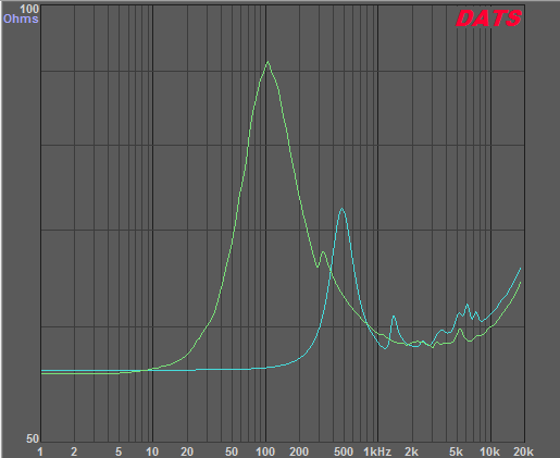

Seems nothing shall be easy in impedance sweep OB-1 reveal left channel is kind of Monday model, hope can fix it myself in when connecting a 1,5V battery it looks stroke is limited so could imagine when glued that some glue or acoustic foam is sitting in a wrong position. It plays music fine so in that manner can easy pass mass production quality test, but after problem was discovered then testing with same mono signal to both channels it is clear right channel have lower sonic reach.
You might want to contact company. They are all about customer service. They are a small company and I can get you contact info as they are down the street of a PCA customer who works with them on promotions. Are your wiring mods reversible otherwise they might claim it's the wiring that's causing problems.

Thanks help X and yes wiring is reversible but think is responsible myself to have no rights anymore but lets see, think have just find the culprit which is the small driver where either voice coil is little off center or there was some fragments down in gap before assembled. In owner at Status Audio sent me a email when ordered at amazon and again after received i talked to them before mod, asking for manual how to get them apart and also i shared EQ settings with them in this conversation, so even guarantee is gone hope they think alright we send him that little driver, after all even it was working it was broken to ever perform as expected.
Ok, convolution appears to be working as it shows it in the music path. I forgot how to have a way to quickly turn it on an off. First what is noticeably different is that with it on, the bass went way way down - like it was too bass bloated before. The mids and vocals now standout much more clearly. Sounds closer to my DT880-250 without convolution.

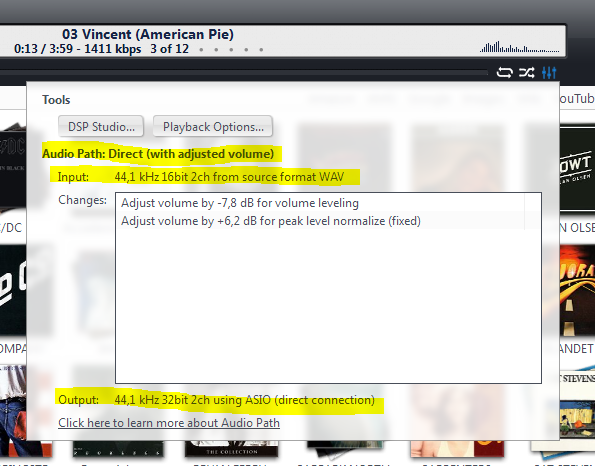

...Jriver seems to have problems when I switch between different file formats. My files are a mix of Flac's and Wav files and the Flac's are at different bit rates. It sometimes hangs and says bit rate not supported by WASPI or ASIO, etc. and I have to manually switch. I think you warned that the convolution was only valid for 44.1kHz bit rate to be bit-perfect?...
Messages as those bit rate not supported by WASAPI or ASIO i only get when two programs try have exclusive access to sound device and makes sense, as example if REW is open and set up to ASIO it locks on its settings even it don't use sound card to sweep right now, JRiver is different in it don't lock sound card in exclusive mode if it doesn't play but simply just is opened. Hope above makes sense and help to your situation.
To check JRiver have exclusive control and playing track to sound card as it was meant to be place mouse over the three arrows rightmost up at the top, info there will reveal track data and output data and if not right look into setting that then must be set wrong somewhere.
