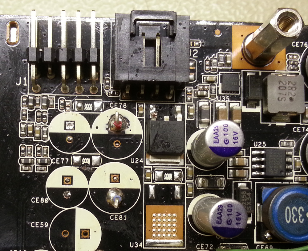

If one was to inject -12V regulated at u34 (?), the unregulated -12V first has to be removed from the design...do you see a way of doing this?
I think if you remove the molex power and add external 12V to the 7812, then the -12V would also get power...?

Okay...so where do I want to add external power then? At pin 3 of the 7812 and where the 7912 was designed to go?
Do you have a pic of the beads that have to come off?

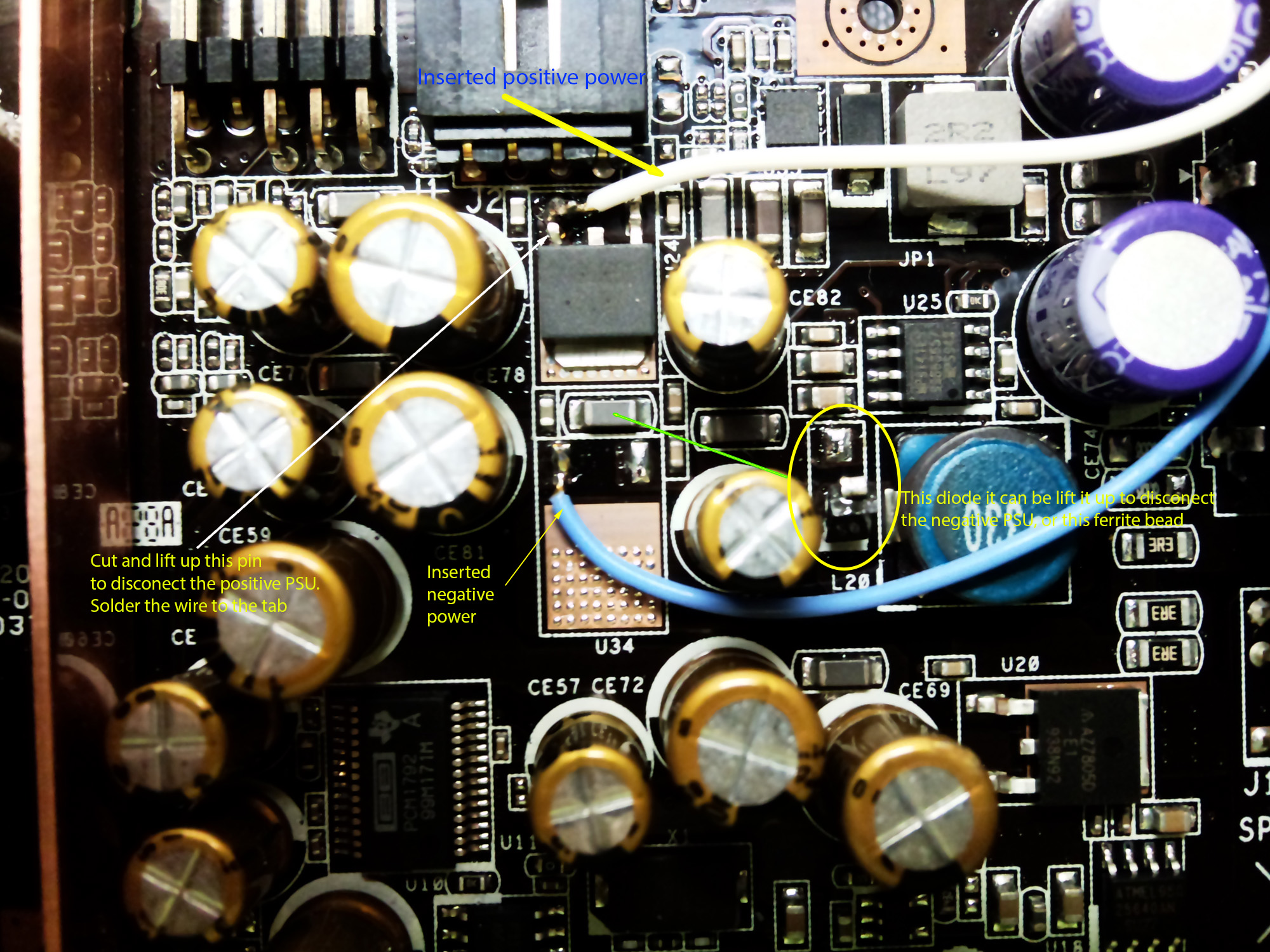

I do hope the pic here by can explain....
Nice! Thanks!
It looks like the diode would be the easiest to unsolder....?
Where is your ground connected to the board? I think my regulator has separate grounds for the - and + power...would it be best to connect my reg grounds to the center pins of the 7812 and 7912 spots (or the big case pad).
And to be sure, you DO still need the +12 and +5V molex connected even after adding -+ external power?

You may connect together the GND of the positive regulator with GND of the negative one and solder the common ground as shown in picture.
In the same point it should be also connected the whole GND of your new double PSU (mid point of the transformer, the GND of the filtering caps, GND of the regulators. The connection have to be shortest as possible, using a quite big section wire.

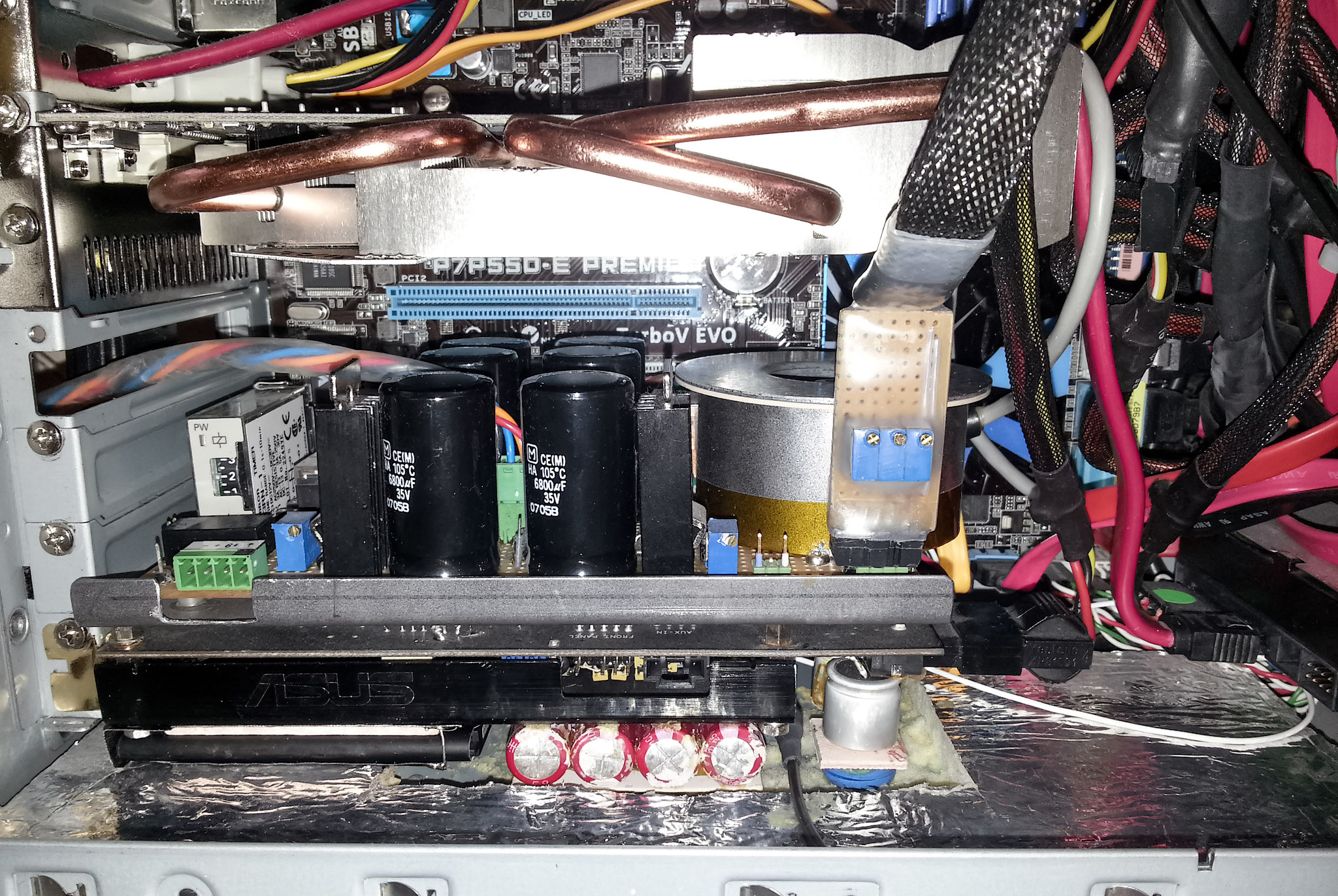

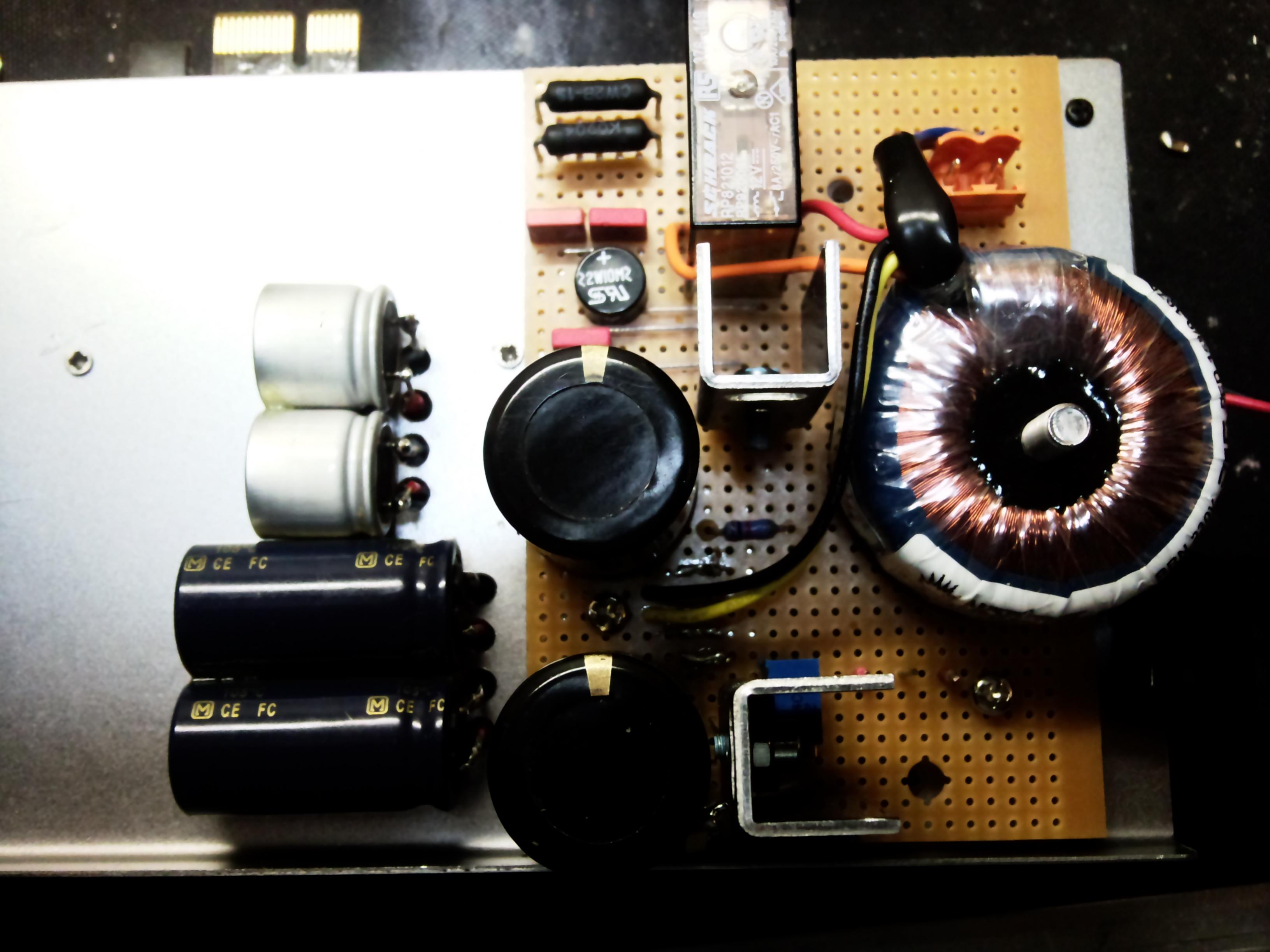

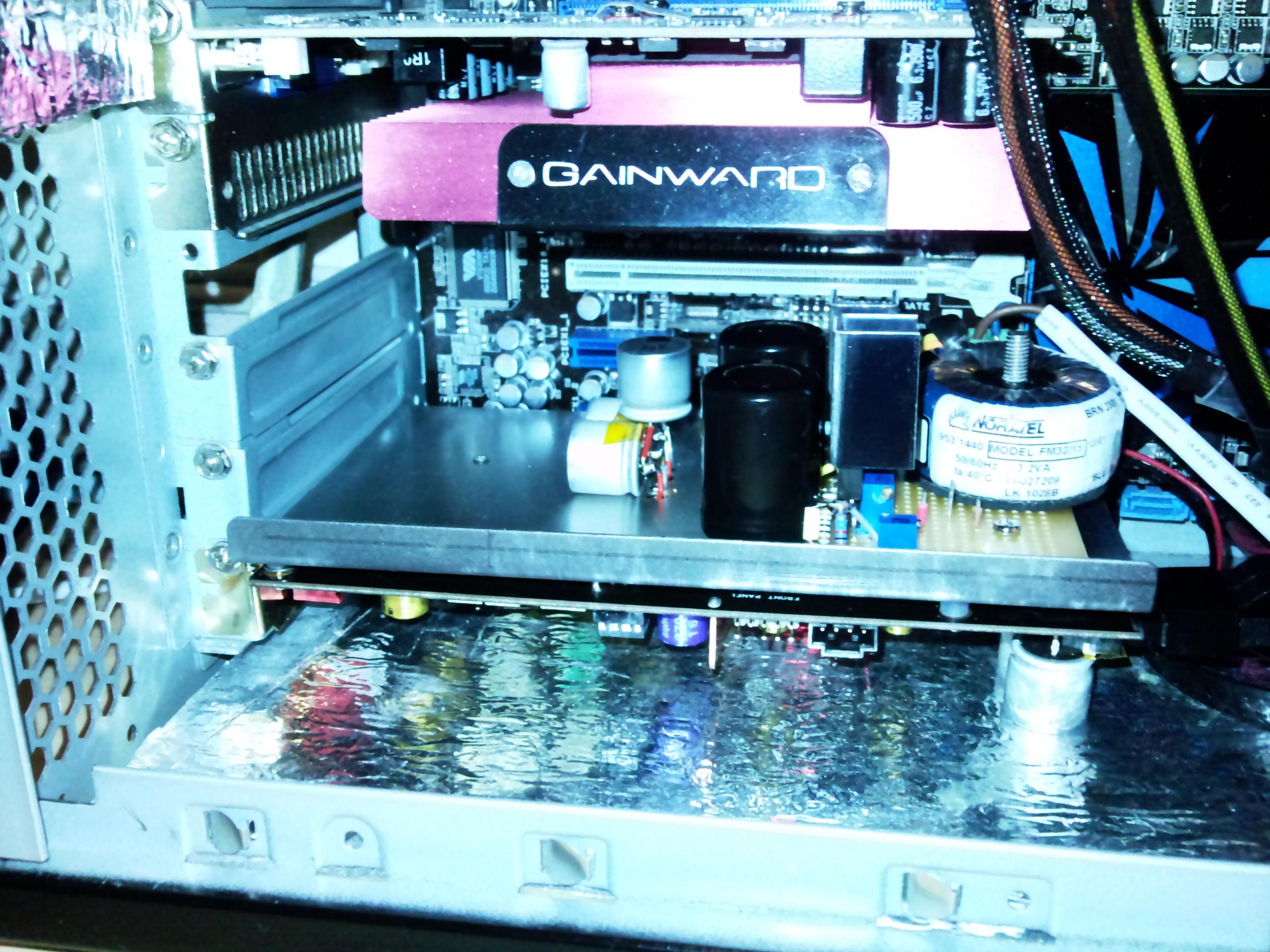

As an inspiration, I show here too the picture of my previous moded STX with the external PSU on the back of the board...

I'd love to hear more about your PSU...
Did you build that one yourself? I'm still a little fuzzy on the grounding...
You connected your ground to both - leads of those caps, or is just the one fine? They seem to be in series...?

Well, well...
Your PSU it may be good, but how it looks its PCB is quite huge... To be honest, I do not think one may use such complicated (regulated) PSU for this task. If you will use a double PSU for the whole board, then is not needed more than 300mA per rail. If you use the PSU only for the DAC analogue post processing, then the needed currents are under 100mA. A very small (easy) toroid transformer will deliver enough power for the task. A rectifier bridge per rail, filtering caps, some +/- quite ordinary adjustable regulators will be enough to get a good double PSU for the propose. Yes, I have build it by my self that PSU on a prototype PCB, as you may see in the picture. As I sayd, my PSU is enough complicated because I designed it to switch the power on battery use, then control all the system when the batteries should be empty, and so on... Quite complicated. It works well for me, but normally, one may not need all these things. Just a simple double regulated PSU placed as near as possible to the sound card. The shortest ground connection is very important to get good results...

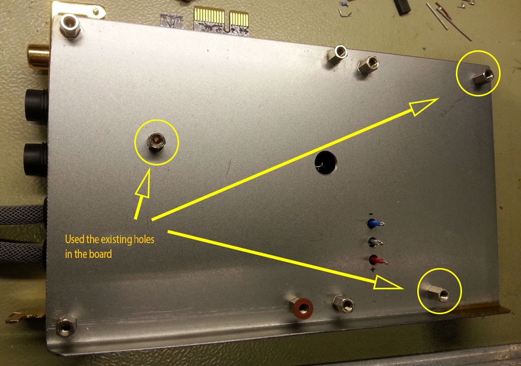

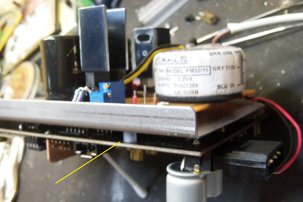

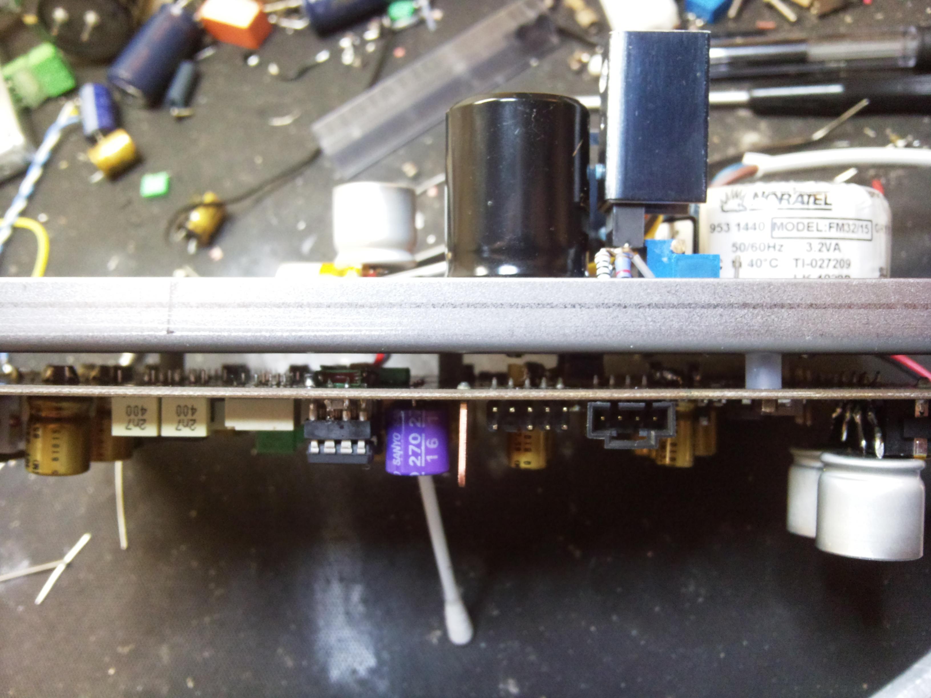

I have used a steel plate to have a mechanical platform for it, and a good magnetic isolation for the transformer. with some spacers I have used the existing holes on the sound card to mount the metal plate on it.
Do not forget the mechanical aspects when about an external PSU (like you intend to build). The whole system it may fit the place inside your computer enclosure. If you think to have your external PSU outside the computer, it may not be very fortunate... because the quite long connections involved
There are some standard dimensions inside a computer, one may care about to not come in conflict with another devices/boards. There is not very much place anyway. The whole sound card system may not create mechanical tensions when the card is in its PCI/PCPIex slot in the mother board. It have to be not heavy at all. This is quite important to not destroy the motherboards delicate traces/connections.
So, one may think at quite many aspects when start a such project...

Some more pictures of my (earlier) modded sound card (and the last edition - pic 3), as inspiration for those interested...
My regulator board is sophisticated, yes...and large. But I might be able to use a lower quality external PSU to feed it, and let the regulator smooth and regulate the power.
Perhaps even a 20V/4.5A laptop power brick? Integrate a relay for power up in sync with the PC...?

Your pics are indeed inspirational!! Awesome work!!

Coris
thank you for shots
Is your last edition psu regulator better than older - It looks simpler I guess It Is a serial regulator are you using LM317 and LM337
what about shunt regulator
I like Noratel trafos very much but consensus Is that EI type and particular r core and split bobbins are better - Hammond and Block making last mentioned
what type are your caps are they Pana FC
thank you for shots

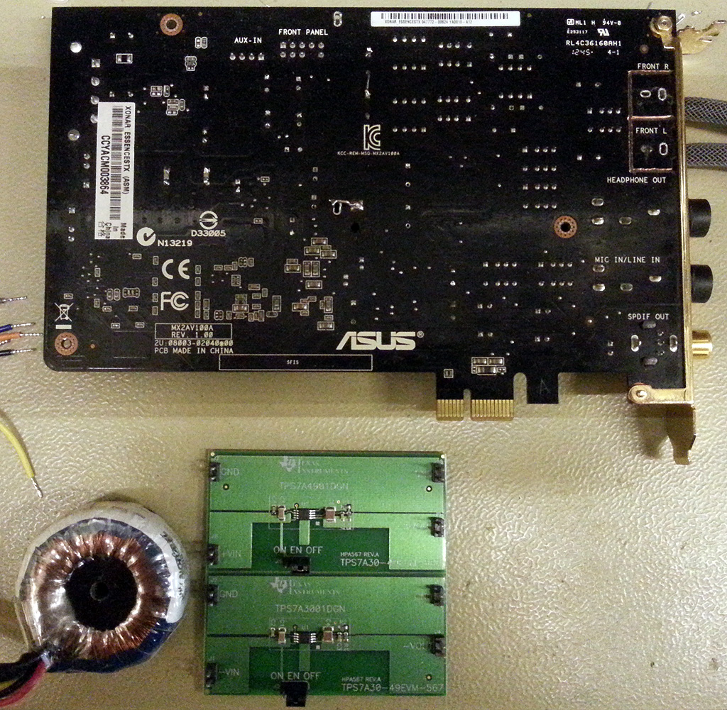

Two possible solution (suggestions) for high quality external PSU for the sound card analogue stage. For dimensional comparative the STX is pictured too... Else everything else of standard/common regulators are enough good in this case. Do not forget a solid filtering...
I will suggest using of toroid transformer, as they radiate minimal magnetic field, and are very efficient for this propose. Shielding of the transformer is beneficial for even better (noises) results.

The last edition of my PSU it were designed thinking to a battery use too. That because it looks quite complicated. Else the main PSU has minimal changes than the older one.
That my last PSU allowed me to switch on the fly between wall and battery power for the sound card, so I could very well appreciate the eventual changes in sound quality. I have to say that is no sound difference in using a battery to power the board analogue stage, than a normal serial PSU. That because I`m thinking now to improve even more my concept, using one of the above suggested solutions...
It were interesting for me to get +/-15v out from the original PWM PSUs on board, and then appreciate the results. Unfortunately, the negative PSU on my board did not want function any more after I have changed the resistor in it, to get a higher tension level...

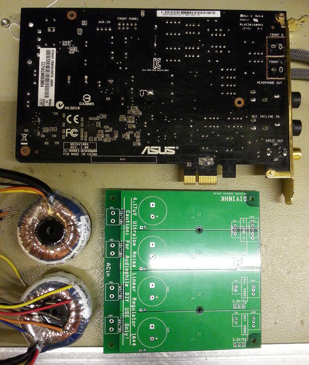

Sorry to say, but I will do not ever think at a such solution with a computer PSU...
First there is about a switching PSU, which this project main idea is to eliminate it from get in to the analogue stage of this sound card. Second, a such PSU is very noisy for audio use. Third, this kind of PSU have quite heavy start up currents. Very much care is to be taken to soft start a such PSU. But all of all, my opinion is at a laptop PSU is definitely not to be used in this field.
You can sell further your big PSU, or use it in another project... Some very good double serial regulators cost no more than 20$, or the more complicated one, 100$ (as pictured above). these are quite small and fit very well the sound card area.
If you may put together by your self some components (schematics are plenty to be founded on net), on a prototype PCB, it may be a more cost effective solution, very efficient in this case.
Very soon I will come out with some more pictures of my going project. So you may see some other solutions for this mod...
Anyway, you should use an normal transformer (toroidal) to power your regulator, and do not ever think at a laptop power brick...

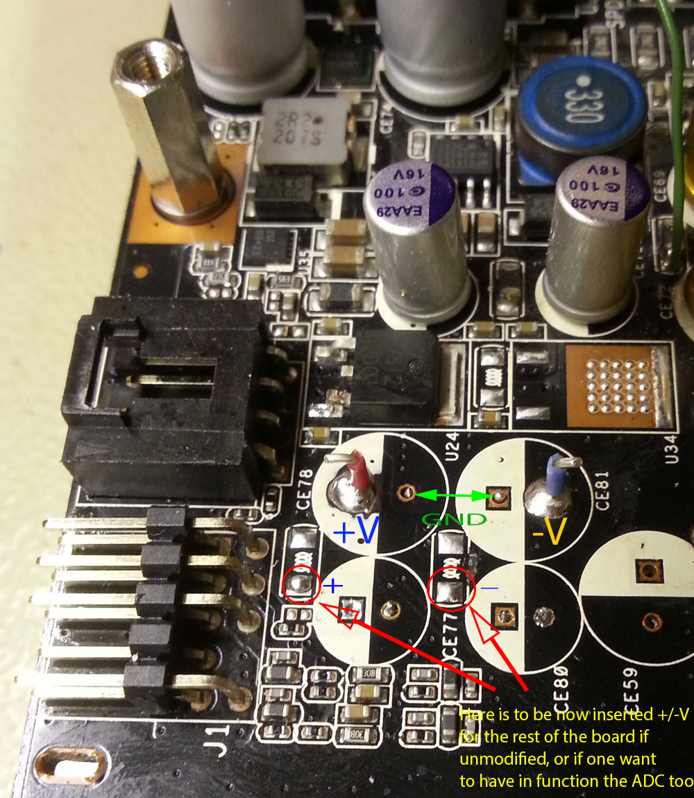

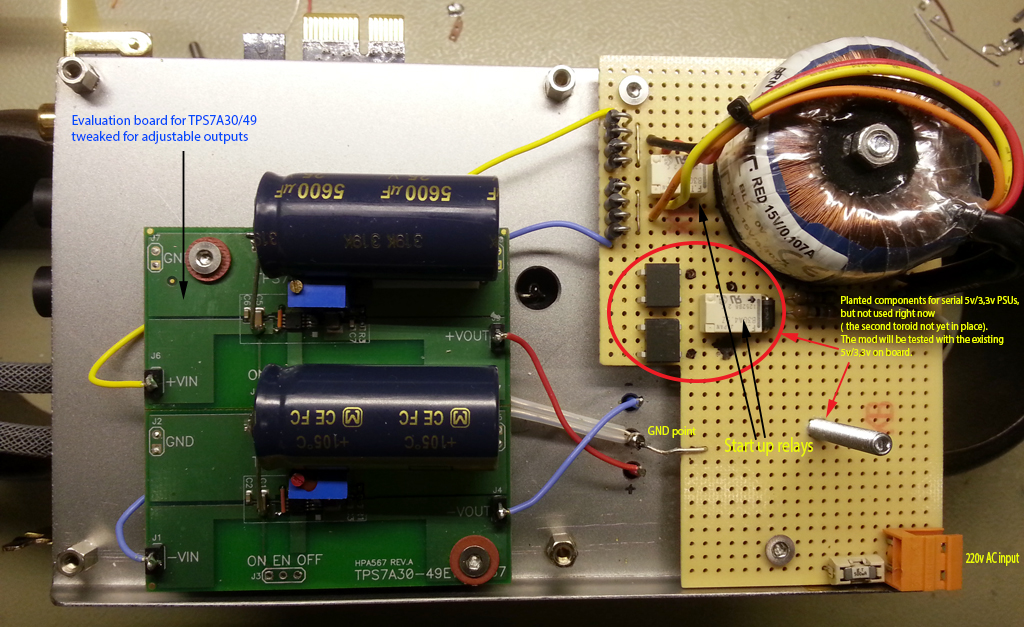

I show here a solution to place an external double PSU for the analogue stage of the DAC (opamps). In this case the double PSU is only to feed the DAC analogue stage, and not for whole board.
A double PSU for whole bord (DAC/ADC) may take around 200mA. My PSU here is dedicated to feed only the DAC opamps (max current 150mA)
I think the pictures do not need more explanations...

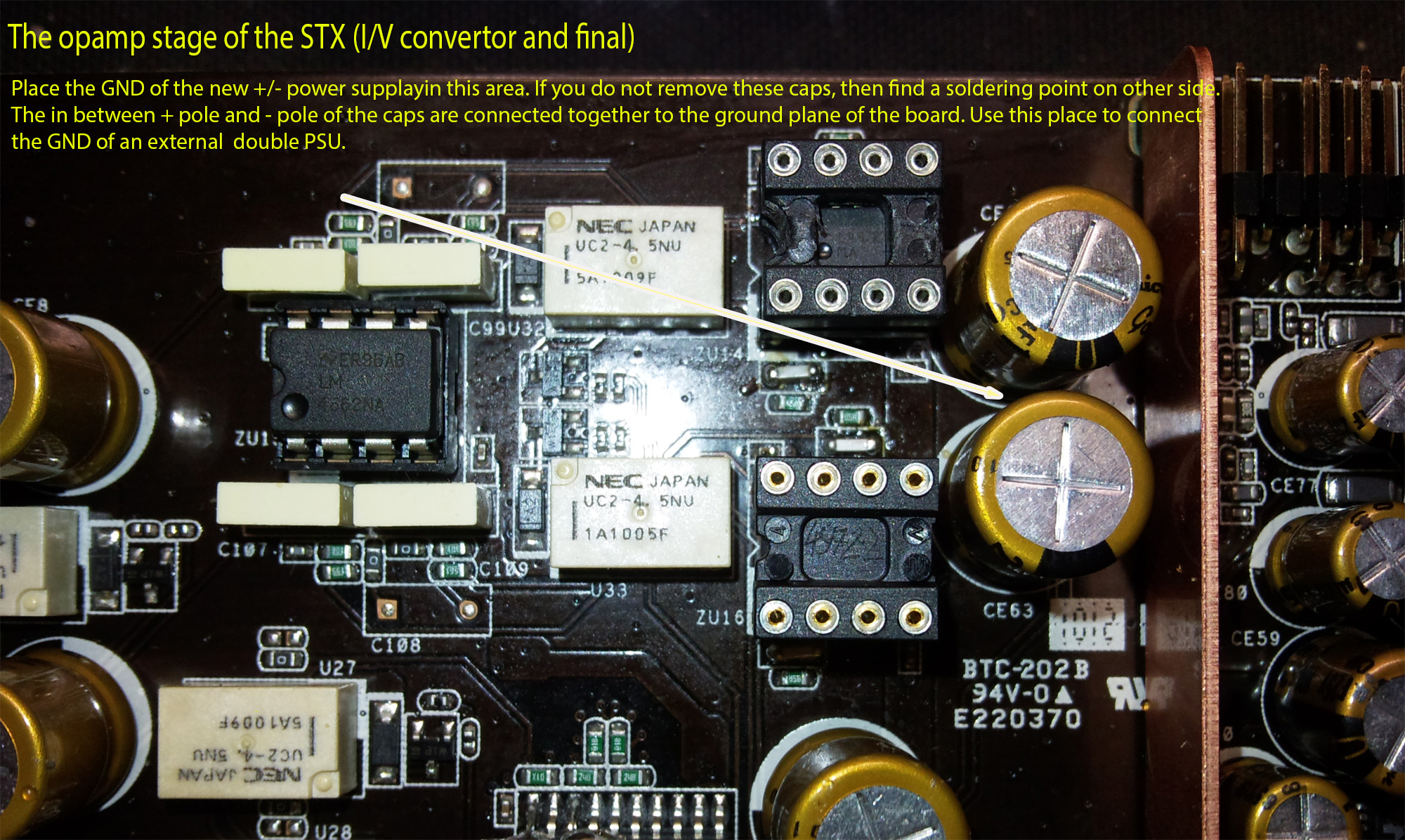

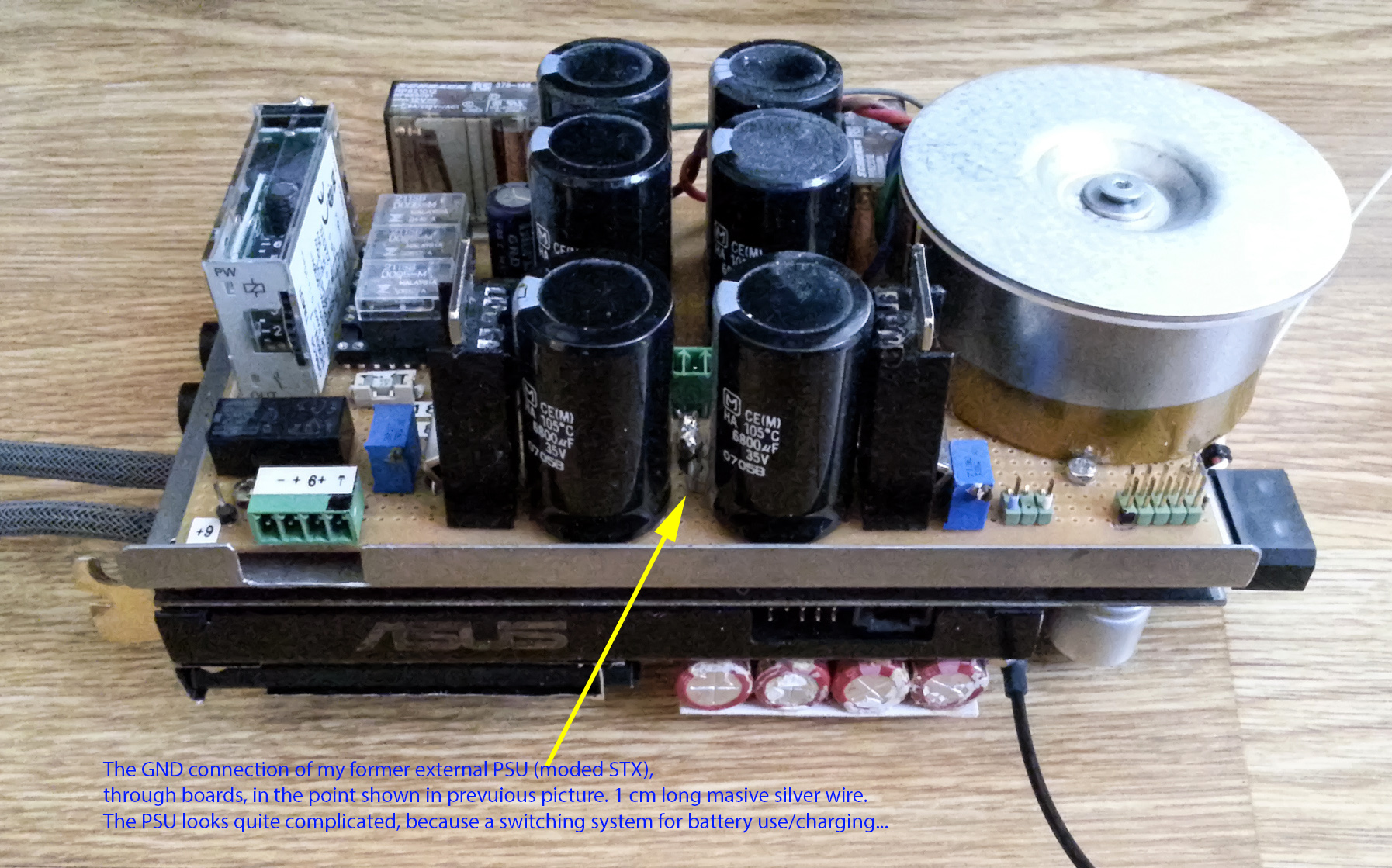

As one can see, there is a clue to have this double PSU as near as possible to the board (very short GND connections). A good place for such PSU is right on the back of the board. In this case it is a claim to have pass through places in the sound card to transfer the +/-V and GND from the PSU to another side of the board, to the modded DAC and its analogue post processing circuits.
To solve this problem is to find two places on the board which it may be completely isolated from the rest of the board, with a common ground point with the board ground plane. This solution is only suitable in case one may not want any more the +/- on board PSUs. This is a mod is for advanced modders...
If one remove some components as shown in the pic1, get one access to such isolated points with through holes for wires. In pic2 one may see the soldered through wires for +V, -V and GND. Pic 3 shows another angle of the mounted pass through.
In this illustrated case here, the ADC stage of the board does not function. If one may use a double PSU which it may deliver at least minimum 300mA, and insert this power in right points (shown on the pic 3), then is possible to power the ADC stage too. So, be aware about this detail in this mod presented here....
