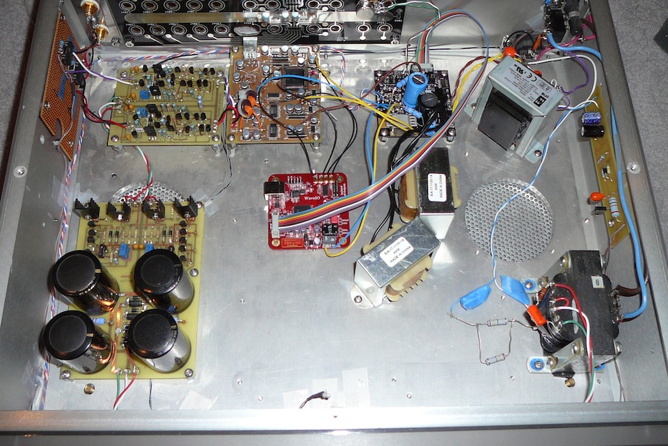

You asked for a pic of the prototype that the WaveIO went into (or at least you asked about the color-coded LED for sample rate; it's handled on the same small board as the PS for the WaveIO; I could get circuit details if someone really wanted, but since JS used a single RGB LED to make the colors--so only one spot of the opaque faceplate changes color--it really was a pain-in-the-neck circuit). Anyway, a photo is below.
Best regards,
ALEX
