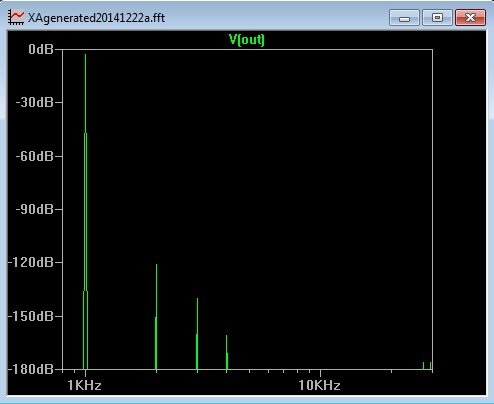

Hello generg,
.OPTIONS plotwinsize=0 does the trick!
(The other options you have posted have little effect.)
When I add only that option and leave the rest of the file as it is (with 1000µF input capacitors) I get this picture:
Yes, the result looks reasonable.
A look into LT-Spice help clarifies the problem:
1. plotwinsize = Number of data points to compress in one window. Set to zero to disable compression.
2. LTspice compresses the raw data files as they are generated. A compressed file can be 50 times smaller than the un-compressed one. This is a lossy compression. This pane of the control panel allows you to control how lossy the compression runs.
=> set allways plotwinsize=0
But the result of post #157 stays the same when I insert that option there too. That is a strong indication that there is something wrong with the MOSFET models. Or these MOSFETs are in fact so (massively) different that they do not act as a differential stage.

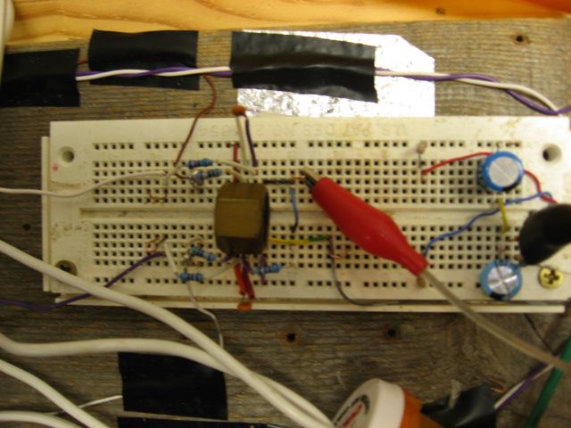

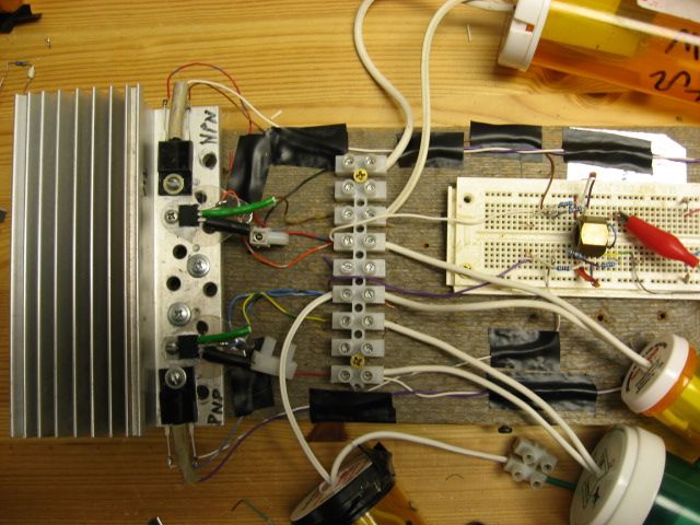

A prototype..
Hello everyone. The schematics in the image are by lhquam from his post#119. The Bridged Anti-Phase Single Ended [BAPSE] schematic was reduced to a practical prototype so as to understand/characterize its operation; because of its central importance to the bigger amp.
The middle photo shows this prototype. The output stage of BAPSE is on the heat sink. It uses complementary bjts [instead of Mosfets], and LM337 plus LM317 voltage regulators operating as their CCSs with each idling at 0.3A.
The right photo focuses on the generator of the required balanced signals, and current drivers to BAPSE which is based on NE5532 Op Amp [original Signetics] It is underneath the pipe fitting which is its heat sink [bonded with cyano acrylate]; because this Op Amp normally runs a bit warm.
I'll show schematics and characteristic performance. I've listened to it already. Sounds great.
