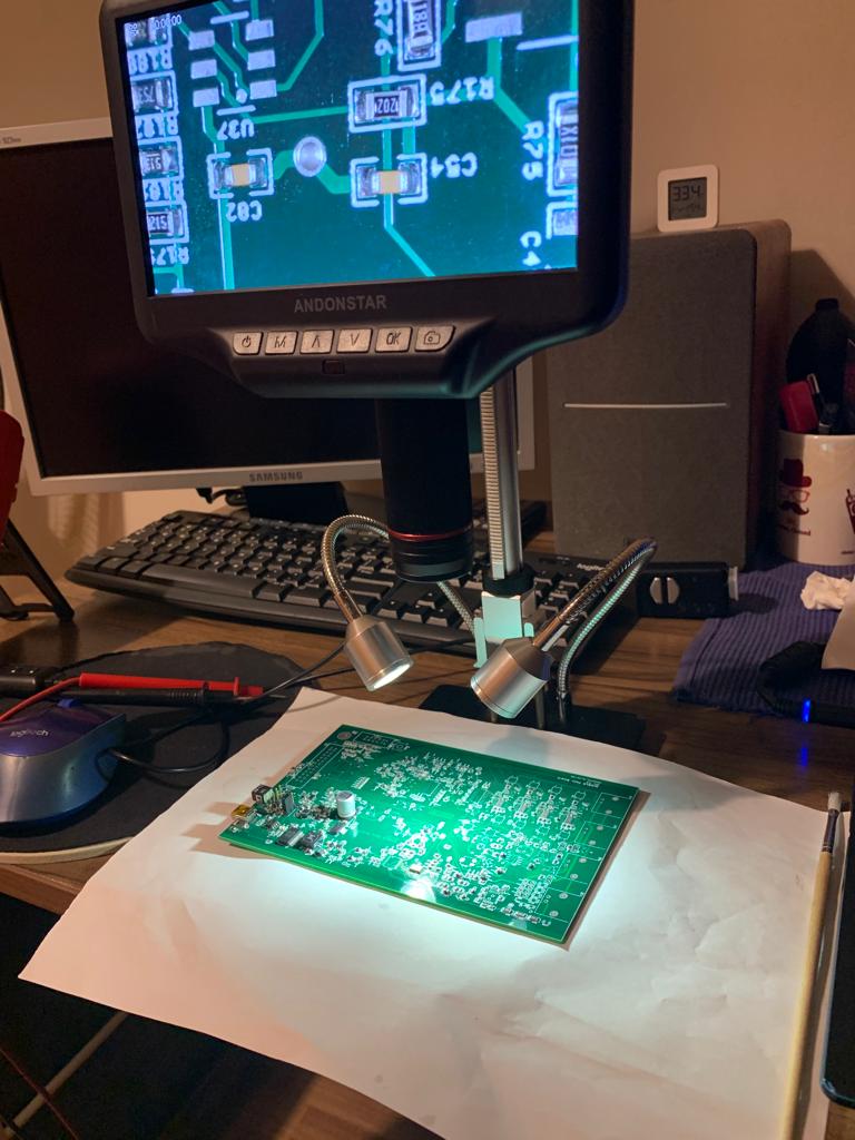

I'm going to have fun putting this all together. I'm quite used to SMD construction down to 0803 and SOIC but soldering 0803 and SOIC8 pads with vias within them will be interesting!
My normal soldering setup for SMD is my Ersa iCon Nano with a 3 or 5mm wedge tip and 0.5mm leaded solder.
I'll take on board your recommendation and finally make use of the needlepoint bit that came with my solder station. I've used 3 and 5mm chisel tips for my past excursions into SMD assembly to reasonable effect. Mind you, my boards haven't had quite as tight a component placement as the HPA-1 board does.
I actually prefer a wedge tip for doing drag soldering on the SIOC packages and smaller pitch ICs.
Having looked at XRK971's video XRKaudio SMT method demo I may just borrow my son's hot air kit and give that a go!
After years of TH assembly experience within an aerospace environment, I'm more than happy to do SMD stuff and far prefer it.
