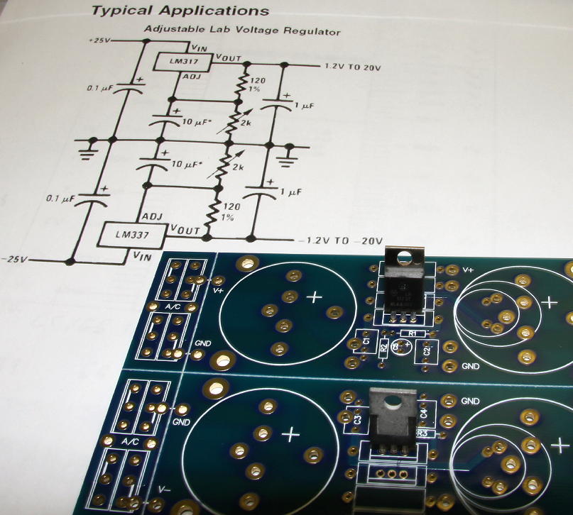

There was a question how to use the PS boards with adjustable regulators for low current applications.
Attached picture shows it for LM317 (top) and LM337 (bottom), the orientation and placement of TO-220 regulators is critical as the supply boards work with symetrical voltages.
The other parts values are according to schematic in a picture:
R1/R3 = 120R
R2/R4: adjustable 2K, can be later replaced with a fixed value
C1-C4 = 0.1uF (optional, any other small value should work fine too))
C5/C6 = 10uF
The diodes placement was discussed here: http://www.diyaudio.com/forums/showthread.php?postid=1237672#post1237672 ; choose any suitable values for large caps. Although grounds are shown as common in a schematic (courtesy of National Semi), they are kept separately on my boards.
That arrangement is also good for LT1086/LT1033.
The other two spots are reserved for LM78xx/LM79xx
