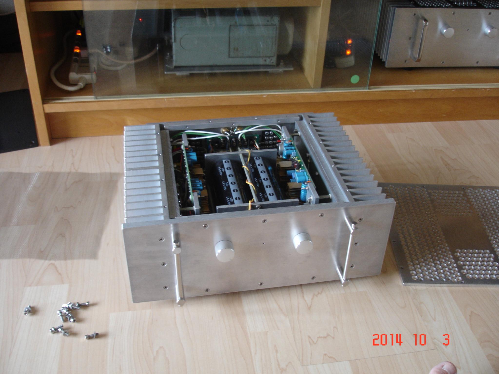

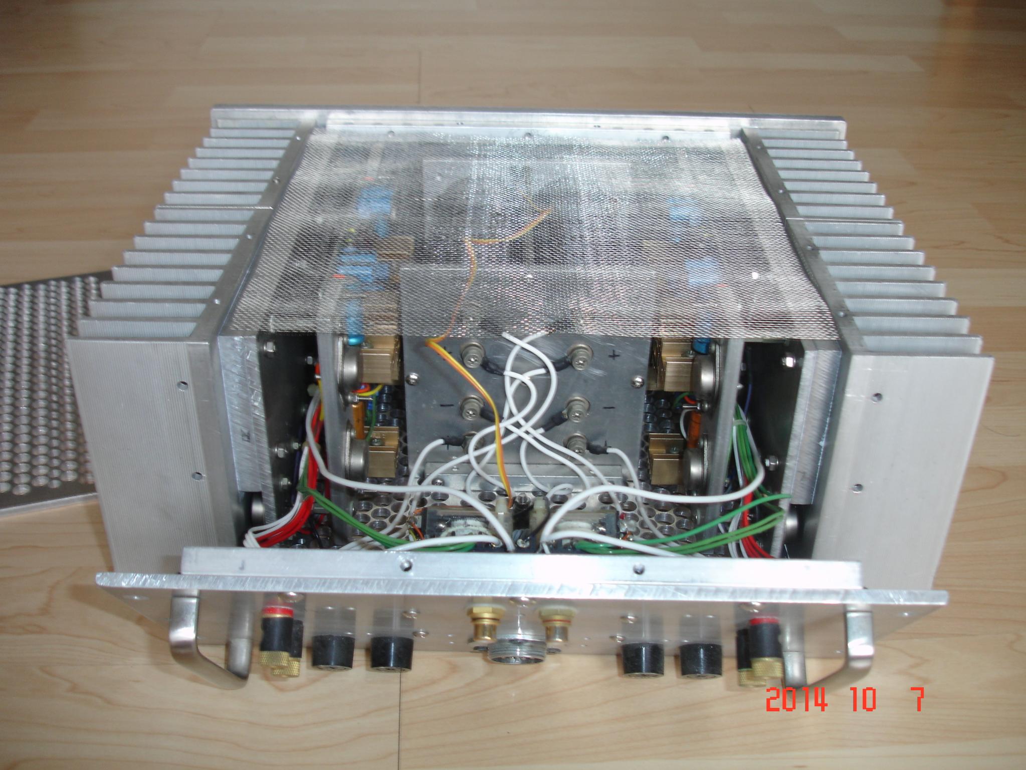

I like your amp! But, as mentioned before, I would not use that top cover with that "much" ventilation:eek:. I know ventilation is good for the amp, but that much is bad:eek:.
How bad? Well it is not only that some kind of metal can go inside by mistake, But also water or any liquid too...ooh and do not forget that "dust" is a bad thing for electronics too and with that much ventilation it will be easy to accumulate dust inside. if you want to see the guts inside your amp....well take a few pictures;).
Do not take it wrong, it is a recommendation only...at the end it is your amp and you can do anything you want to it;). if amp is well design, the "only" parts that will be hot when it is in use will be the heatsinks and those have to be very well ventilated;). My amp is completely sealed and the heatsinks are located on the outside so ventilation is very good and I do not have to worry about dust or liquids splashing inside amp. I would like show the guts of my amp and leave the cover off, but I know it is a bad idea!.
I encountered the same problem by "dust", I use a stainless mesh to improve it (left side of the attached photographs), at least it becomes easier for cleaning.

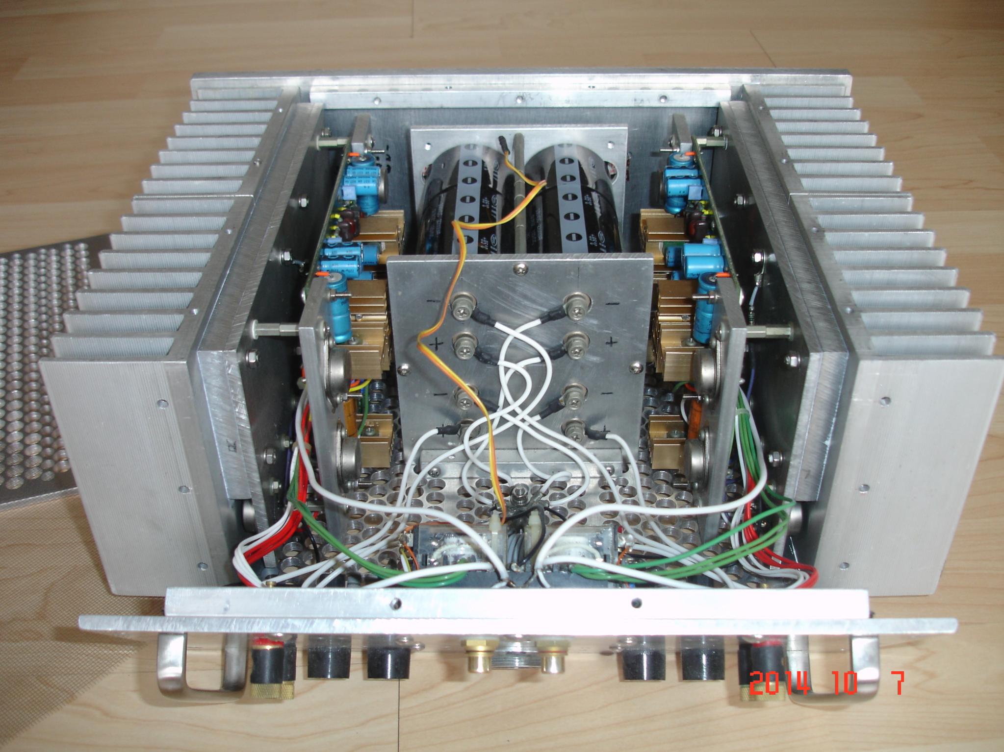

My implementation for Leach SuperAmp is 20 years old -- drill was the only tool for me to make the chassis, the whole structure was too complicate for assembly -- too many screws, too much wiring and thermal paste!
Your implementation is really awesome, I love and enjoy it!
I can tell you are an expert in modern tools (CAD software ...), looking forward your every publish on diyAudio.
John

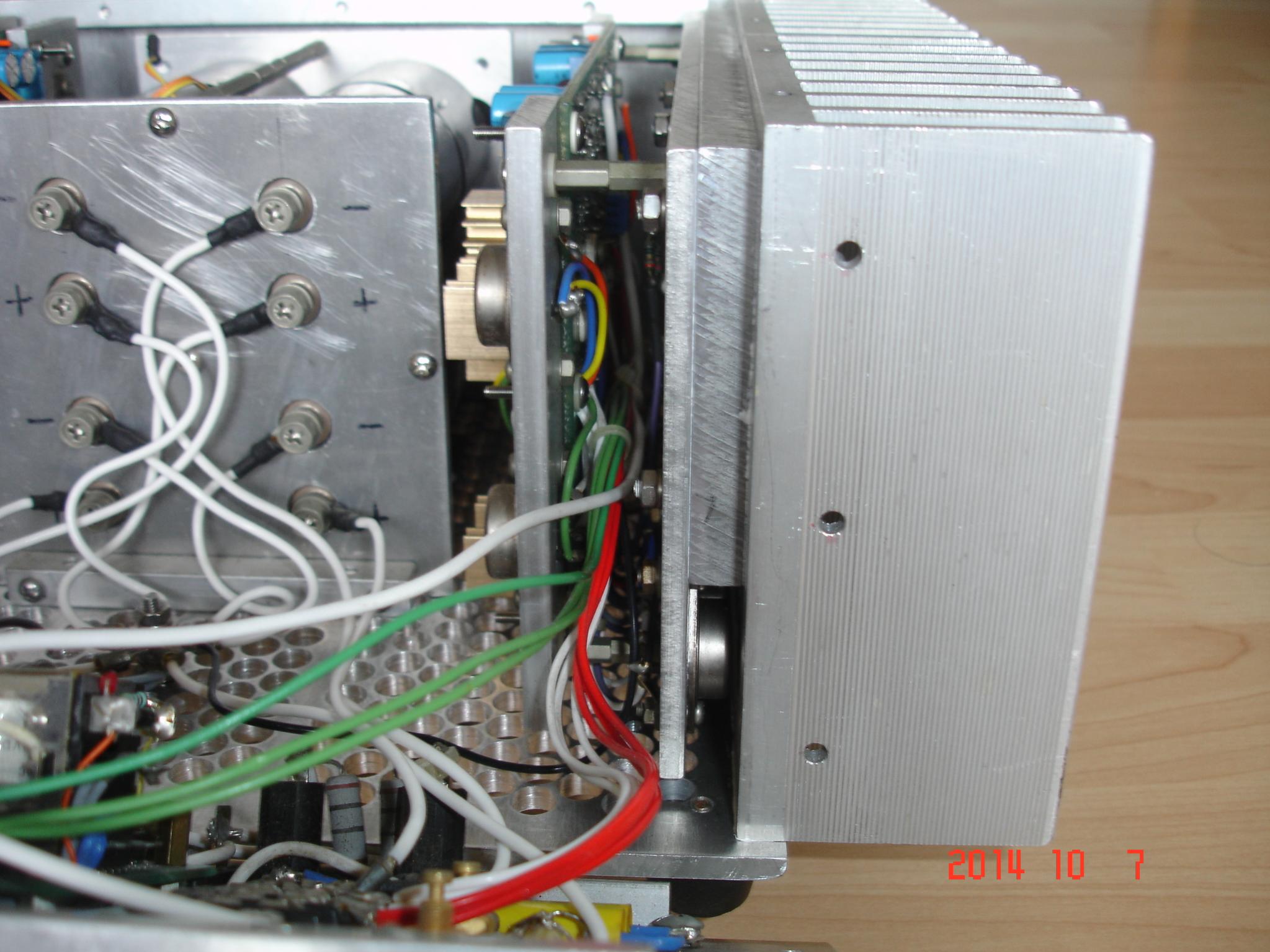

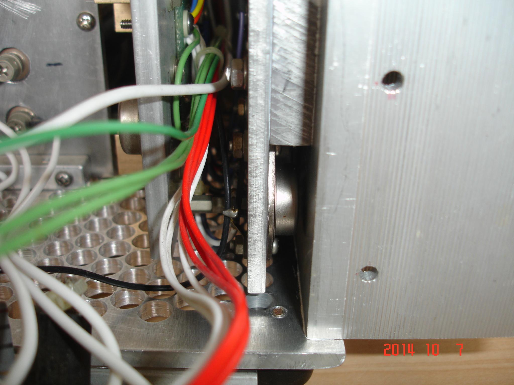

I have one question though. Maybe the photos are not revealing enough details about this. How are the TO3s heat linked to the heatsinks? They look like they are on some plate on their own and only studs linking those to the heatsinks...
[/QUOTE]
Please refer the attached photographs, there are total 3 thermal junctions by my build:
junction1: TO3 to 4.5mm Al plate (actual is TO3 to mica sheet + mica sheet to 4.5mm Al)
Junction2: 4.5mm Al plate to 10mm Al plate
junction3: 10mm Al plate to main heat sinker
This is not a good structure for thermal conductor even my build is sufficient for my daily use.:eek:
The wiring from 16 TO3s (my build is 8 TO3s x 2-ch) to main PCB can really makes people exhausting by this structure!:faint:
It looks to reduce the thermal junction (resistance) between output power Tr. to main heat sink is good approach and the modern plastic package power Tr. seems better solution for this approach. :confused:
John

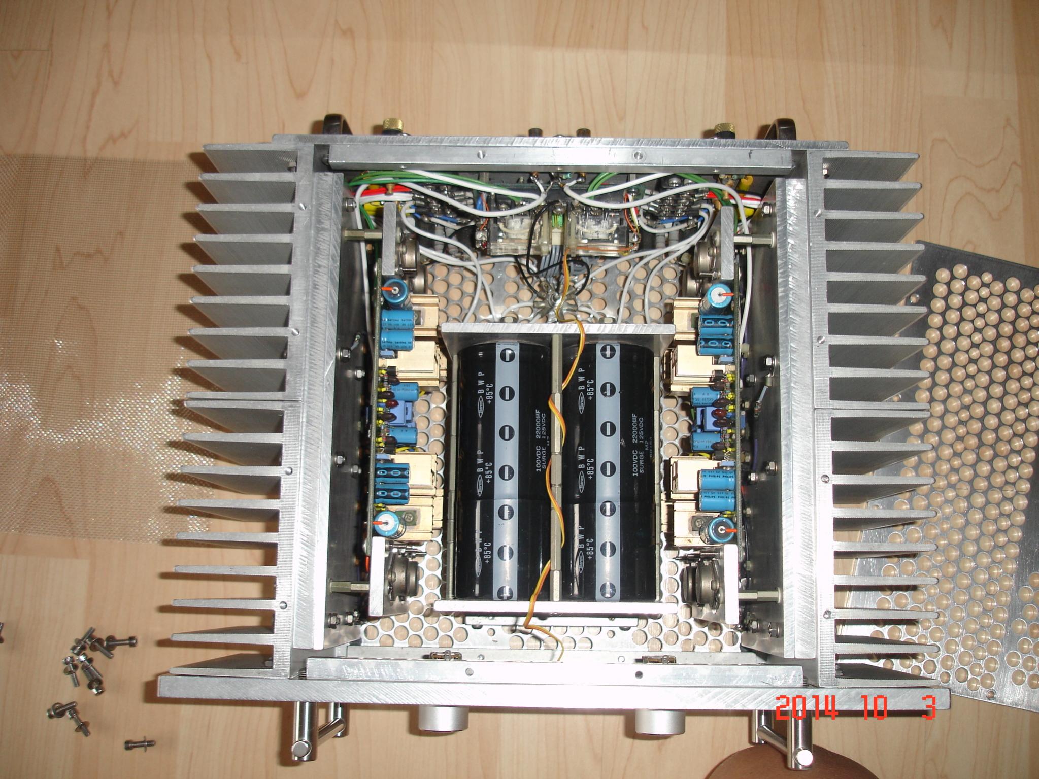

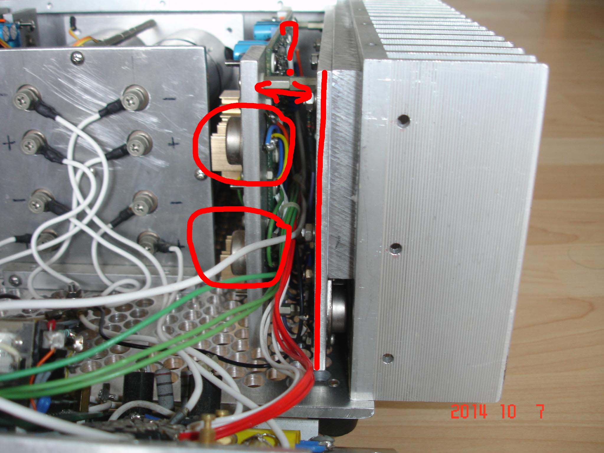

I think that is the one that puzzles me.
I circled the TO3s that I am wondering about on one of your photos (attached here).
Those are on a plate, that may be one of those 4.5mm plates you mentioned.
I am wondering how the thermal link is made from those to the main heatsink via that other large plate (marked with the vertical bar).
I can see other TO3s on that thick plate on the right, but what about those on the left? I only see them sharing that plate and only studs are holding that to the main heatsink.
Am I missing something?
I use TO3 for driver, the circled TO3s on the small plate are the drivers. It according the initial design that M. Leach published in 1975.
The reversion layout in M. Leach current website use TO-220 for driver and locate on main PCB.
I think this may be the reason makes you confused.
There are 8 output TO3s located on the plate that you marked with red vertical bar, there is a 10mm thick plate between it and main heat sinker.
John
