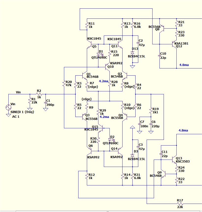

Work In Progress... Leach Based Amplifier
I'm sorry , I could not resist ... (below 1)
I kept the leach classic VAS and biased it to 4.8ma.
I kept the zener referenced cascode ,but balanced it.
I added ... 2 red led CCS's powered from the zener's
-running the LTP's at 4+ ma (similar to the good dr.)
It does 10ppm 1k -40ppm 20k , it has low open loop gain.
reducing the 300R LTP re to 100R really gave it a "kick in the butt"...
68R might be better.
EXtreme stability with my EF3 - performs real close to the CFA VSSA . :)

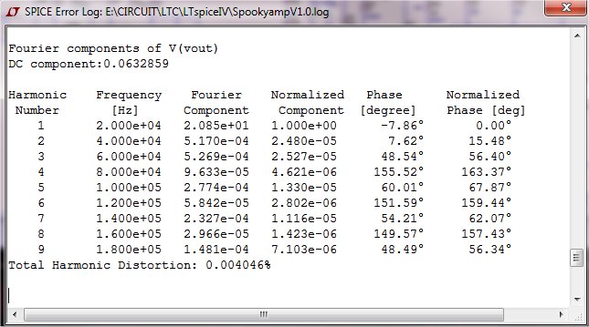

(below 2 ) 2/3 power 3R thd20...

Does THD20 refer to 20hz or 20khz?
As long as you stay away from Miller compensation, then slew rate will be independent from the compensation itself.

Device matching is the best (and hardest) path to achieving the lowest THD in any fully symmetric circuit. Most builders do not want to take the time to match, despite tonnes of evidence of its benefit.
That is my main goal in part selection. I have a plan to build as part tester as well, with nice features, so good and convenient matching can be done and a testing for second breakdown (non destructive of course) can also be done.

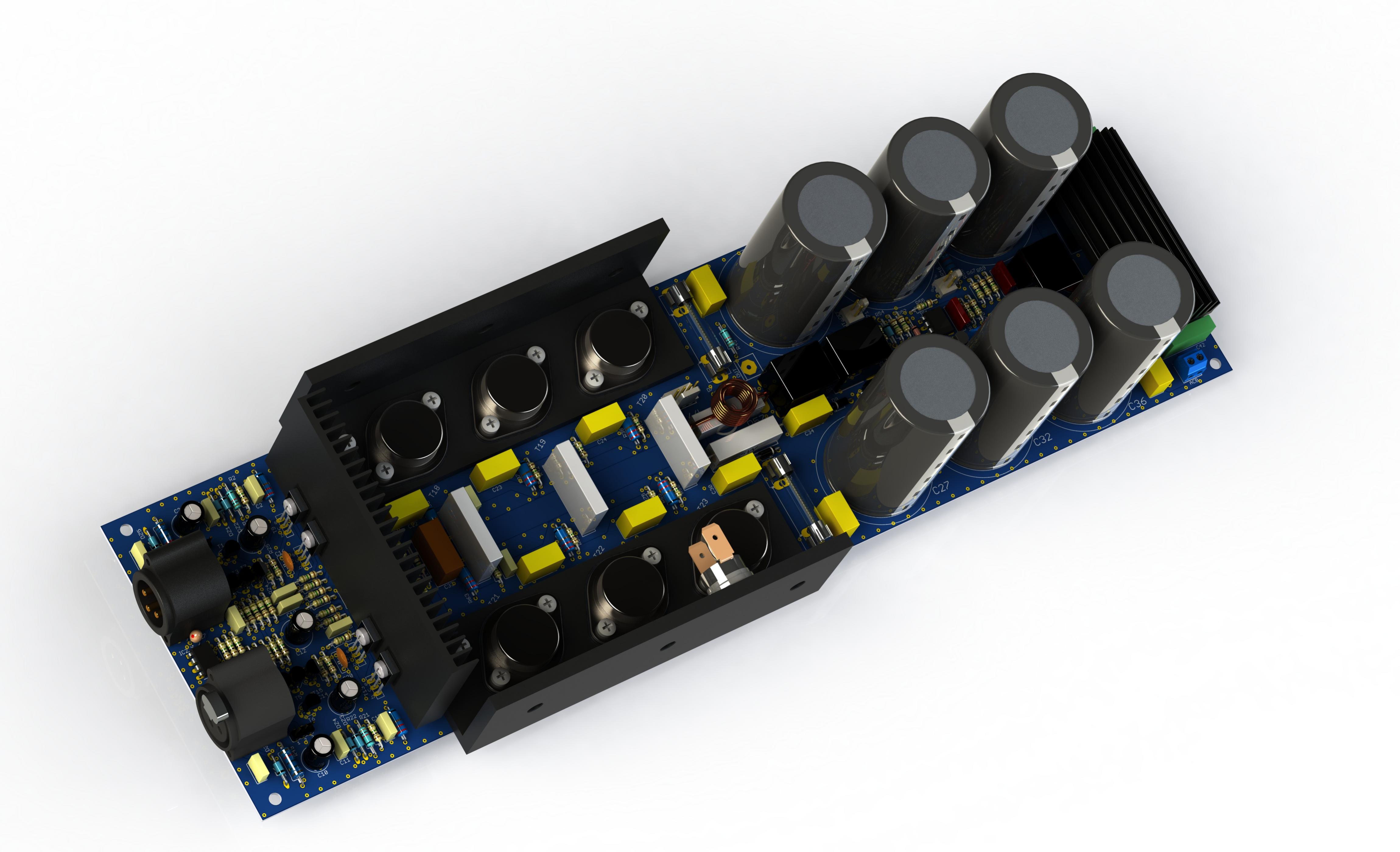

I like the massive heat sinks and such like of the chassis, but believe you are building a service nightmare that will have difficulties to construct as well.
I wanted to overbuild, especially on the heatsink, so heat would never be an issue and abuse would no change that.
I also have some ideas for an other "set" of amps where I want cooling tunnels with forced and regulated ventilation. That's a "set" because it's for a 4 way system, and I want all the amps in a single case, on wheels, because it will be very heavy with the multiple big toroids.
Consider the narrowness of each PCB and the "canyon" you have to work within to bolt the output transistor carriers onto the heat sinks. A friend of mine used allen-head bolts and a ball-end tool, claiming good off-axis access to the bolts. I found allen-heads easy to strip.
Each amp in the case being a module, it can be removed from it. And it's true that is a rather narrow pathway between the sinks. I had considered bringing the pcb higher, to make the access easier, but then there is a reduction of efficiency in the lower part of the heatsinks, so I lowered the pcb.
To make servicing easier, once a module is out of the case, if there really is a need to access hard to reach areas in there, the heatsinks can be removed from the module, because they are attached to those square braces, so the square braces don't have to be taken apart from the power transistors. Thus when putting it back together, the only thing to be careful about is to redo the thermal grease properly. I didn't find an other way to have such a big heatsink, with the fins vertical for best natural convection, and be able to have so many TO3s on it. It had to be done with the square brackets, unfortunately, so that's an extra thermal junction to deal with, but then the sinks are so big, they compensate for the extra Rth inserted there.
Cascoding the VAS is problematic with respect to stability. If you want to gain about 10dB open-loop gain and reduce THD much more dramatically, use the EF-VAS - just two BJTs more than the basic design and entirely stable. The collectors of these BJTs should be decoupled.
Yes, that's a good idea. The first transistor in that vas could then be a high gain type, unless there is an issue with the vce0...
I didn't think about extra decoupling on the vas, but I'll keep that in mind. I had planned for decoupling on every power transistor, so adding a few is no problem.
Remember that you have to build this AND service it. The leads from the toroids under the boards should be long enough to provide service access.
The toroids come with leads of about 20-25cm in length, which should be just enough to reach the pcb. It's easy to unmount the toroid from the support plate and push it aside near the end of the module. That should make it fairly accessible.

I sim the IPS with Ostripper's 3EF and got 220V/uS :eek:.
If you want VFA with high slew rate, symmetrical VAS is the way to go.

I have the EF3 "solved" flatpack opposed PCB layout with the dual Vbe
no leads for the Vbe and just cm's of trace between Vbe pre/driver.

The flat packs could be located on the pcb edges, so they bolt on the heatsink directly, and this would leave lots of pcb real estate for layout.
The heatsinks are so big and present all along the pcb, there is no problem fitting lots of flat packs on them.

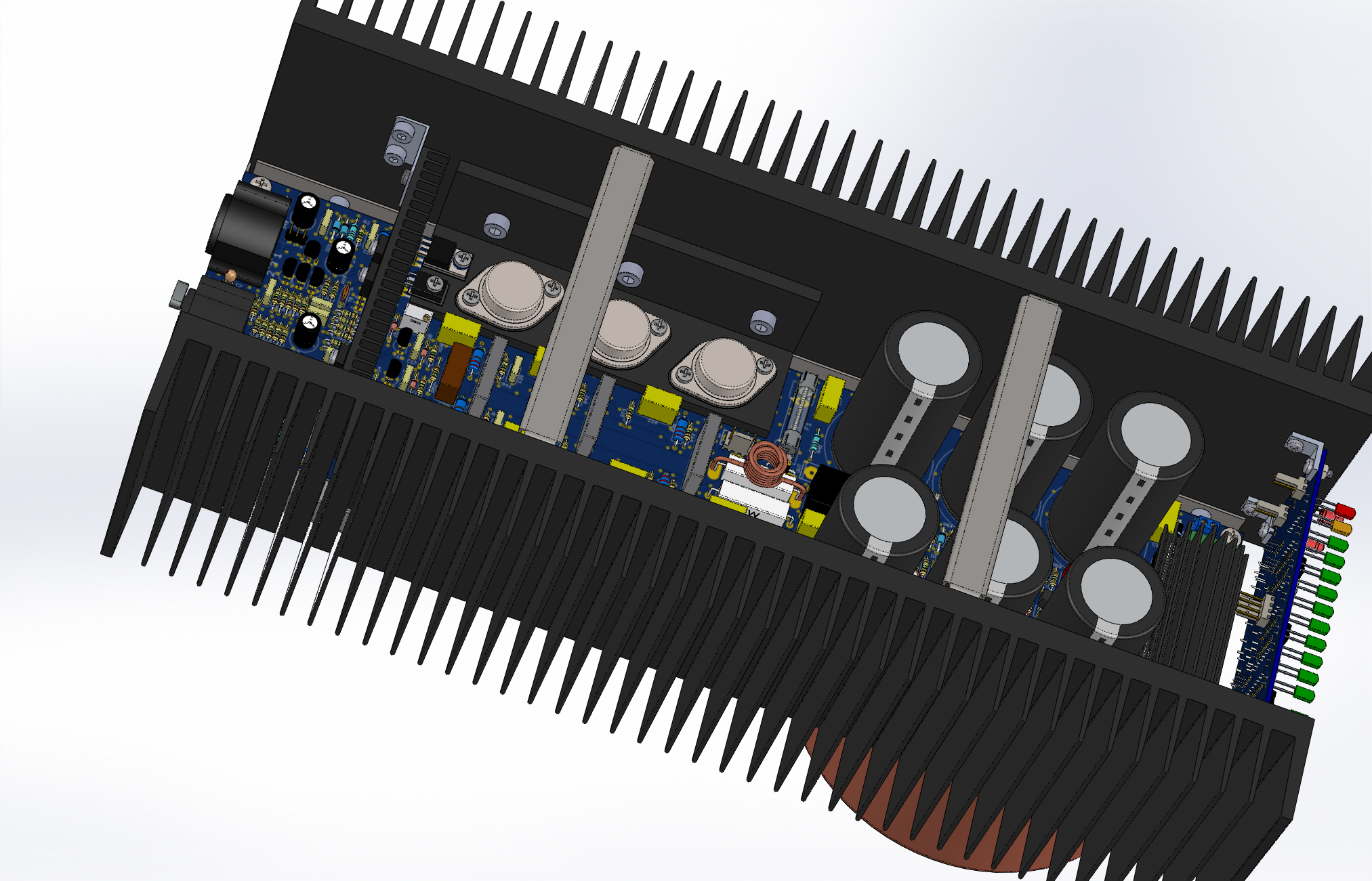

The mechanical access I was referring to was not related to removal of the TO-3 mounting bracket, rather just the bracket to the heat sinks.
It is no problem to have all six TO-3's cooled by the same heat sink, and in some ways it is preferred. The TO-3s have 50C higher temp range than TO-264 and other flat packs, so the all-metal package is a good choice for robustness. Self reported that it is best to place the thermal track device on top of the TO-3 case as this part of the device cycles quicker than the rest - especially much faster than the large heat sink. If you look at older amps, you find the thermal switches mounted this way - specially designed to fit over the TO-3.

The original Leach .... is what it is :D Back when the good Dr. designed it ,
he only had low Ft devices and wanted to keep it simple.
- No enhanced beta VAS = Very easy to compensate/stable .... but the
gain margin at 20K is insufficient for <10ppm THD 20. 20hz - 10k is
a fine 20-30 ppm any load without enhancement.
- The Dr. chose to split the FB into LF/HF , the 21st century way is
to servo the DC (like my NAD cfa) and use the standard divider for NFB.
- The triple ... he relied on the low Ft of his chosen devices. No decoupling
of the driver/predriver , or C-B shunts required. Ft of the devices won't
allow for that dreaded 10mhz oscillation (where most modern EF BJT stages
oscillate - without "tweaks").
BTW- MJ15003 To-3's are roughly equivalent to MJL21193/4 (low Ft/hfe).
I've had both sim/real world success with them ... MJ's would be perfect.
Below is .asc +text - plug your MJ's in for OP. This amp is rock solid.
PS - you could "ditch" the servo and just trim one of the led CCS's for
mV offset - keep it simple!
I'm posting a picture of the amp module, the version with the vu-meter.
Are you concerned about those 3 hex head socket screws mounting the square bracket on the heatsink? It would require an allen wrench, a long one might be better.
Do you have ideas to make this better? I'm open to suggestions.
Sure, that's how it's done most of the time, with only one heatsink on one side. I just wanted more heatsink and possibly be able to make a single case from a module instead of a stereo amp. This works out well mechanically, however it's true the drawback is that it does separate the outputs in half.
I did want robustness, however I do have plans for later versions with the flatpacks. I was even seriously interested in those ThermalTrak parts, but their future seems rather uncertain and I hesitate on that. They would be great, the bias spreader could be a single small signal transistor, not needing to be mounted on the heatsink and the fact that the heatsinks are split would not be a problem that way.

Spookydd, The flat interface for TO-3Ps to the heat sink is just that - a flat piece of aluminum bolted flat onto the heat sink. Those holes can be aligned with the heat sink fin spaces.
Meanwhile, the mounting holes and spacing for the TO-3Ps is completely independent of the fin spacing, so can be be set regardless of the heat sink used.
That heatsink is rather thick at its base (over 9mm) and I didn't find it necessary to go all the way through. I make the holes tapped and blind, so the screws bolt right on the sink.
This could be done the same with any arrangement of plate and there is no need to even bother aligning with the fins. Makes it simpler.
Do you know the thermal resistance for the one selected? or is there any data?
Sure, of course. That sink is a standard one from Fischer, the SK479:
http://www.fischerelektronik.de/web_fischer/en_GB/heatsinks/A01/Standard%20extruded%20heatsinks/PR/SK479_/$productCard/dimensionParameters/index.xhtml
The length is 100mm, so according to their published Rth chart, we're slightly lower than 0.4K/W per sink. This is far more than enough for this build, and should also be quite sufficient for the subsequent and more powerful builds that I have planned.
I believe the middle heat sinks will be problematic.
In what way?
You're referring to the one used for the vas and pre-drivers I assume.
That sink is also a Fischer, standard, model SK546, in 50mm length.
http://www.fischerelektronik.de/web_fischer/en_GB/heatsinks/A01/Standard%20extruded%20heatsinks/PR/SK546_/$productCard/dimensionParameters/index.xhtml
From their chart, I read the Rth at about 3.75K/W for the 50mm length.
There isn't a very large amount of dissipation from the vas and pre-drivers. I figured this would be quite sufficient.
With +/-60V rails, you are targeting 150W/ch at 8R, maybe 300W into 4R?
The transformers I have on hand for this amp are 470VA toroids, with secondaries rated at 2x43V. Those don't sag very much under load, at least not below their rating at full power. Those specific toroids are a bit old now, as they're from the early 80s and from a now defunct manufacturer that had a reputation for the high quality.(metalimphy)
For the 8ohms load, they should hardly sag at all, and they'll do nicely for 4ohms.
Assuming they don't sag too much, the rails shouldn't drop much below 61V at full power, so I think that could allow some 38 or 39V rms on the load, accounting for various losses along the way. Maybe a little lower, but still that's more than 150W/8ohms, probably in the vicinity of 180.
I don't foresee any heatsink issues. I wanted to overbuild, for absolute robustness, all while aiming for all the quality we can get.
I had planned for 2 smaller heatsinks on the pcb, including one for the 2 rectifier bridges at the psu end of the board. That one is an SK597. All Fischer heatsinks.
This design will see some changes. The output relays and fuses will be replaced by SSRs for sure. The input will have an anti clipping limiter inserted there and I want to make it a muting at the same time.
The protection logic will be expanded to handle all this. And I am looking into protecting against shorts and overloads in an other way than the vi limiters. The anti clipping will serve well against overloads from the driving signal, and the heat sensing against long term over dissipation. Some other way besides vi limiters can be used to detect over currents and soa violations, and take appropriate actions other than shorting the drive from the drivers.
By "middle" heat sinks I was referring to the sides of the modules in the middle of the chassis.
Ha, I see. You're concerned about proper convection compared to the outer sinks.
There is a good amount of space below, an open volume for air flow to go through, and the case is purposely full of holes for venting.
It's true it would tend to convect better on the outer than the inner sinks, but I preferred having 2 instead of just one. And I also planned to be able to use the modules to make a stand alone amp, mono, that would not be rack mountable as that big case is.
