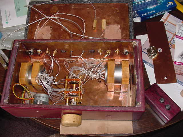

im thinking about doing a bosoz in a wooden enclosure instead of a metal one. the design just lends itself toward a simple and pleasant enclosure, than a harsh metal one.
the big problem becomes shielding. is there something i could easily (cheaply) do for shielding? copper sheets laminated inside the box walls? a spray on, or adhesive product that provides shielding?

You could use something like this http://www.mgchemicals.com/products/841.html
Either that or some Nickel Paint. It's used for shielding the routed-out cavities of electric guitars.

I shielded my guitar's cavity for cheap. What i did was getting common aluminum foil and gluing pieces (which were measured on a sheet of paper and cutted on the Al later) it with a suitable adhesive to the inside of the wood. Just make sure all the pieces touch each other and you're set.It was quite a lot of work and it's a bit delicate but worked flawlessly.
cowanrg said:the big problem becomes shielding. is there something i could easily (cheaply) do for shielding? copper sheets laminated inside the box walls?
Raw PCB material (aka FR4) is cheap, robust, easily cut with a hacksaw, and can be soldered together to make screening boxes.
I've also used self-adhesive aluminium foil, which DIY shops sell (the rolls about 10cm wide) for wrapping round pipework for thermal insulation (IIRC). Very easy to apply, although you can't solder your ground connections on.

cowanrg said:im thinking about doing a bosoz in a wooden enclosure instead of a metal one. the design just lends itself toward a simple and pleasant enclosure, than a harsh metal one.
if anyone has pics of wood enclosures, please post them, i would like some ideas!
Check out the Pass DIY gallery for many attractive pictures of PassDIY projects.
(passdiy.com, look for the gallery link.)
Look in the Pass Labs forum for a remarkable plastic enclosure under the topic "Blue BoSoZ". (Hopefully the search isn't case sensitive... its been awhile since I looked at that thread.) It is really a gorgeous piece of work.
I've been using my BoSoZ in a wide-open breadboard fashion for 6 months and I haven't felt compelled to do anything with it (other than for aesthetic purposes.)
So if you can't come up with a good shielding scheme right off, you may not even miss it.

wood veneer on outside, copper (or AL) lining on the inside. i like the copper foil (or AL foil) idea. sounds simple.
