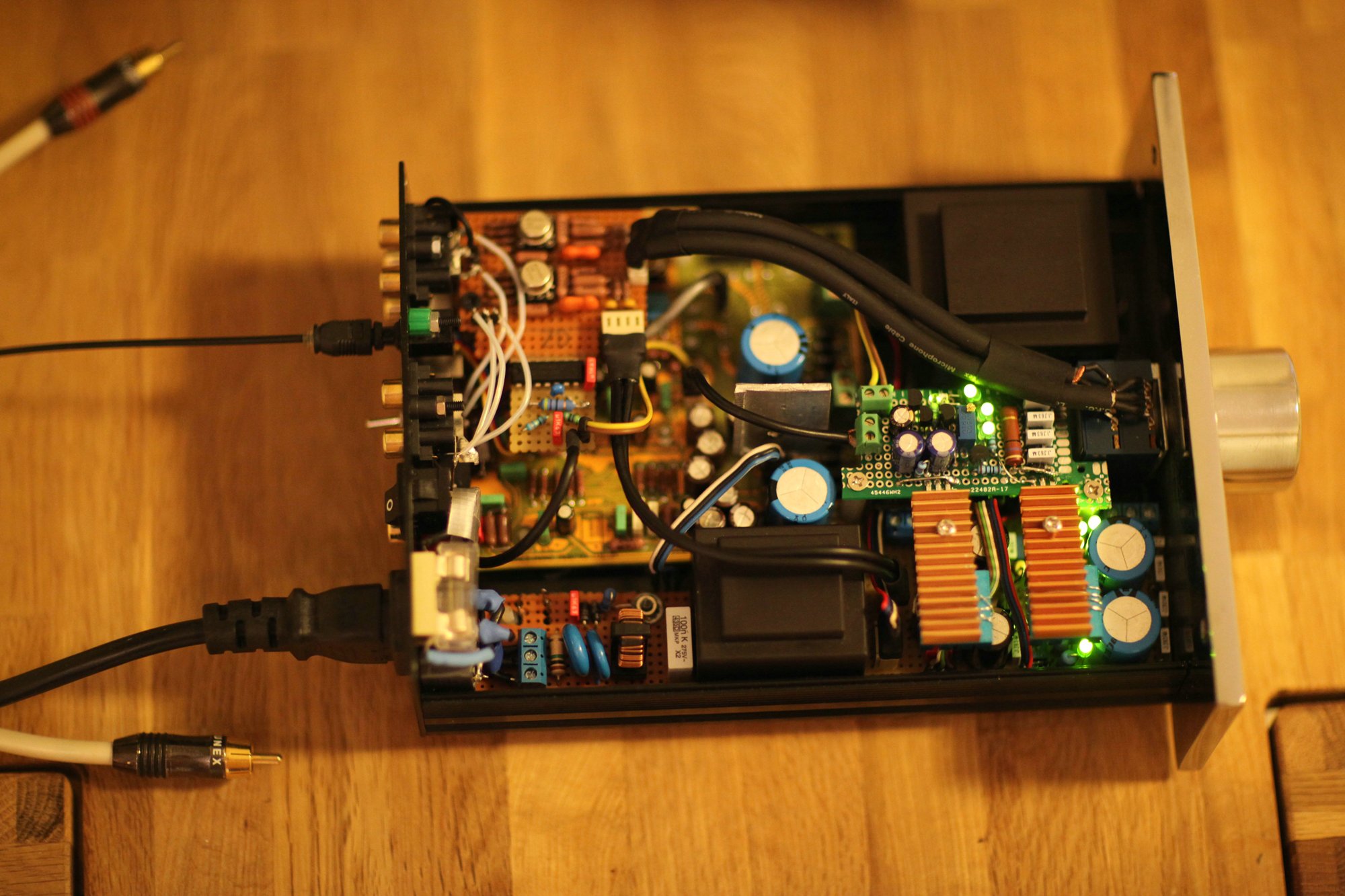

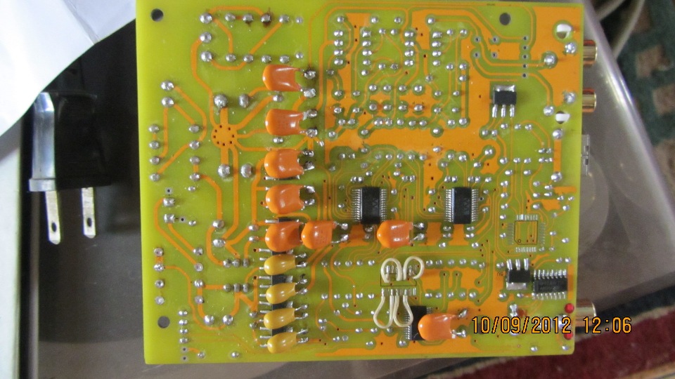

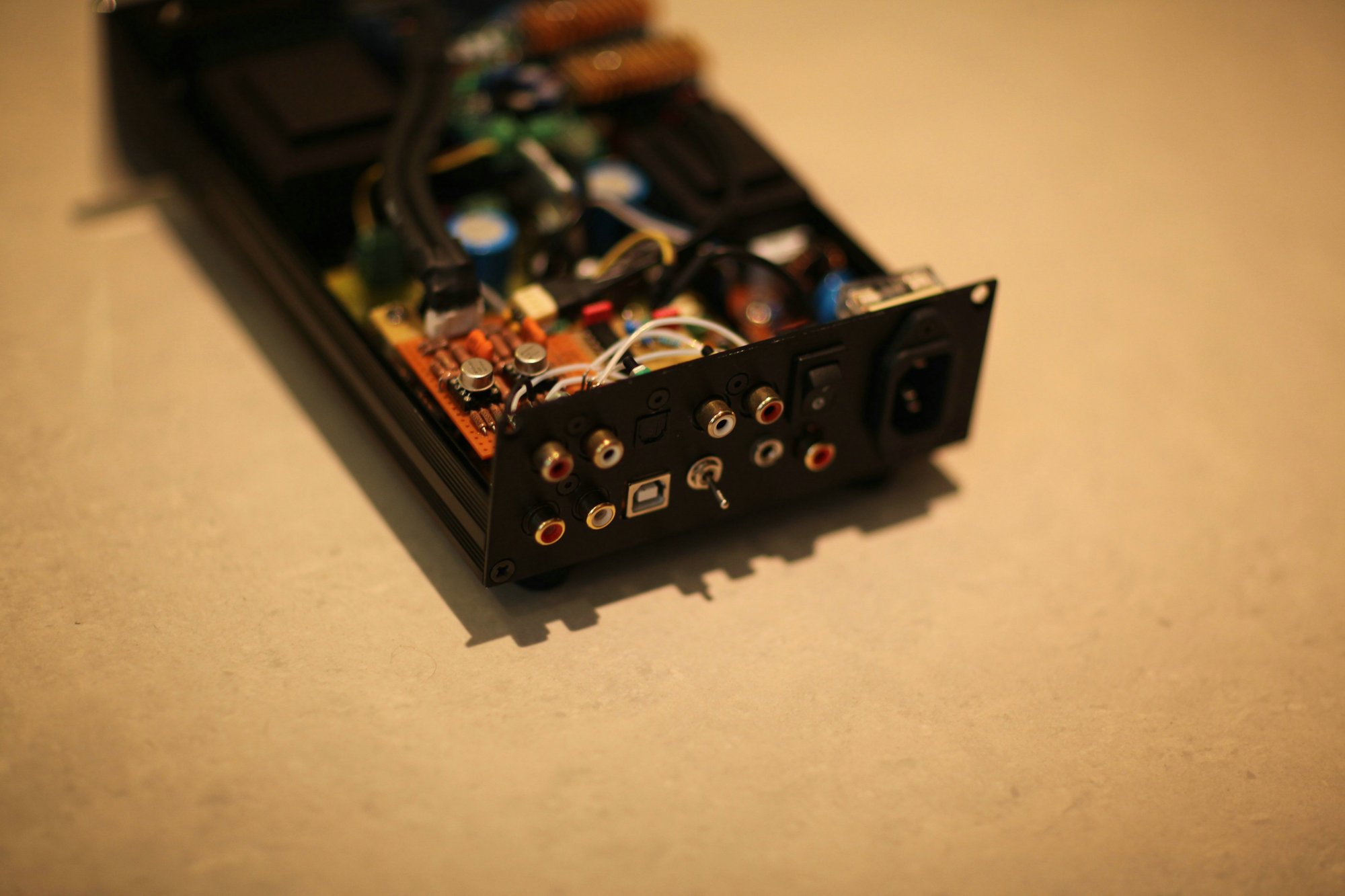

Finally, finished with the case and all in/out RCAs.
Added separate 3rd Salas +5v for WM8740's analogue part, removed smd 5v regs.

Hi Dtses
Looks good ,I also swapped out the caps for oscons and all the regs,I have some fast switch diodes but haven't got around to replacing them yet ,I ordered (4)blank boards and got the newer ones with the pots near the output opamps,they adjust dc offset,mine went to zero and stayed there(grounded input) to adjust.
It sounds great compared to some other dacs I have used,so I'm Happy!
I would like to use the wm8741 for the digital aspects,volume control and also filters has anyone done this and is it worth the time ,I built the first version of heartwinters Dac and it sounds good I switch the filter with a 3 pos switch and was wondering if it's worth going futher?
Nice build and case!:):):):)

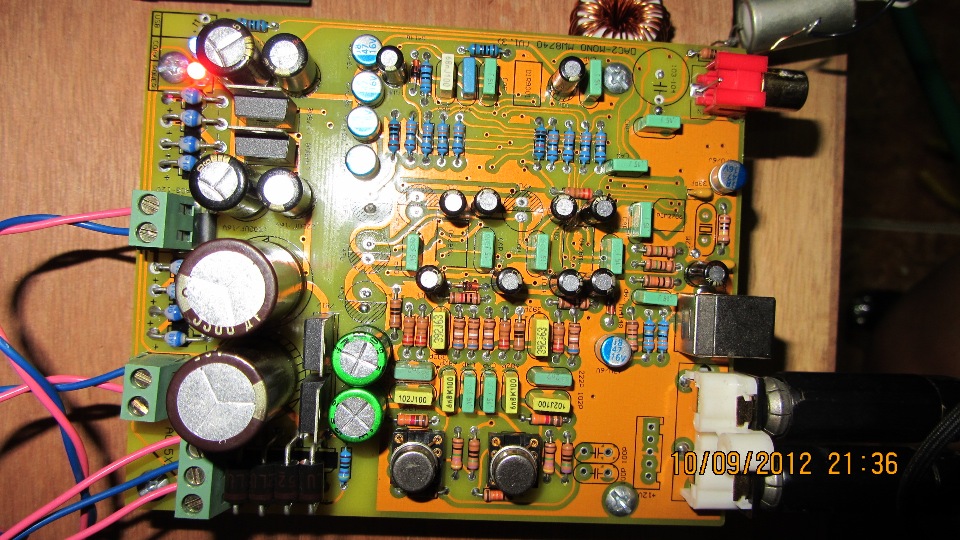

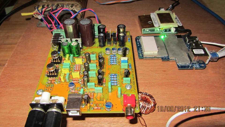

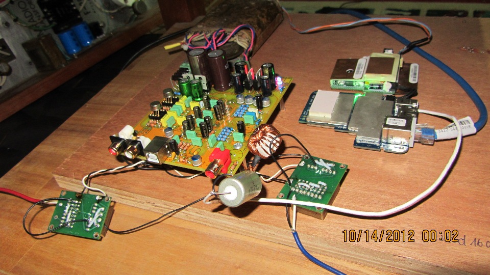

I removed USB, 74HC157 chip and replaced all 47uf Elna capacitor with 33uf tantan, Opam with LF356H gold pin .The sound really improved.
I have idea use I2S signal of airport express connect direct to WM8741 and output with transformer LL1544A (600:600) .

Hi nvduybom,
Looking good,I also replaced the regs on top side because I haven't seen ones so thin and also mine got too warm for me so I heat sinked them,Just a small flat aluminum heat sink fixed it,
I haven't changed out for a 8741 yet,I have another dac that has 8741 in it ,but it also has a good clock and seperate power supplies for anolog and digital,it also gives you some digital filters and other digital (software/hardwire) features,I hard wired it with a switch and It sounds good ,best dac I have built so far,as far as sound goes, it was one of heartwinters boards on diyaudio.
Have fun!
NS
