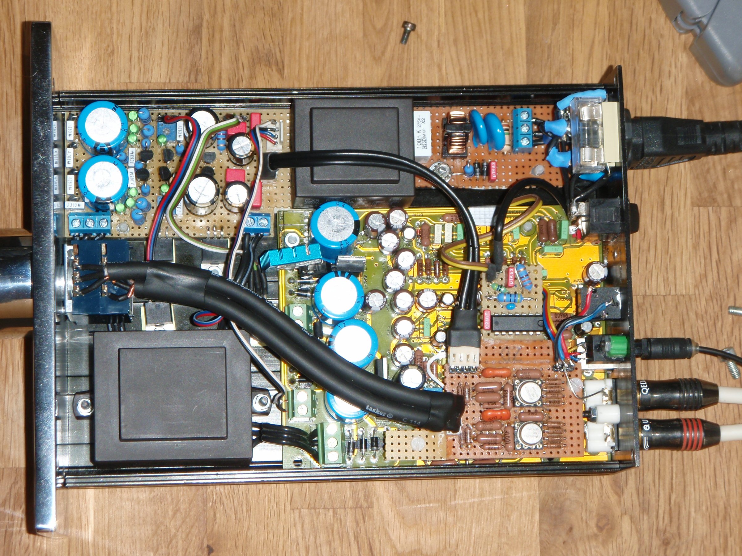

I've modified the design again and now it's done more professionlly I hope
added:
-shunt reg for preamp
-preamp section
-AC filter
-swapped to DALE resistors
-will add preamp RCA input and output soon
-something needs to be done with 7808 regs, they are simply burning, t >80-85c
The whole box heating like hell now, about 55-60c on the transformators inside, 45-50 on top of the case, 60-70 bottom part where IRFs from the shunt are placed.
