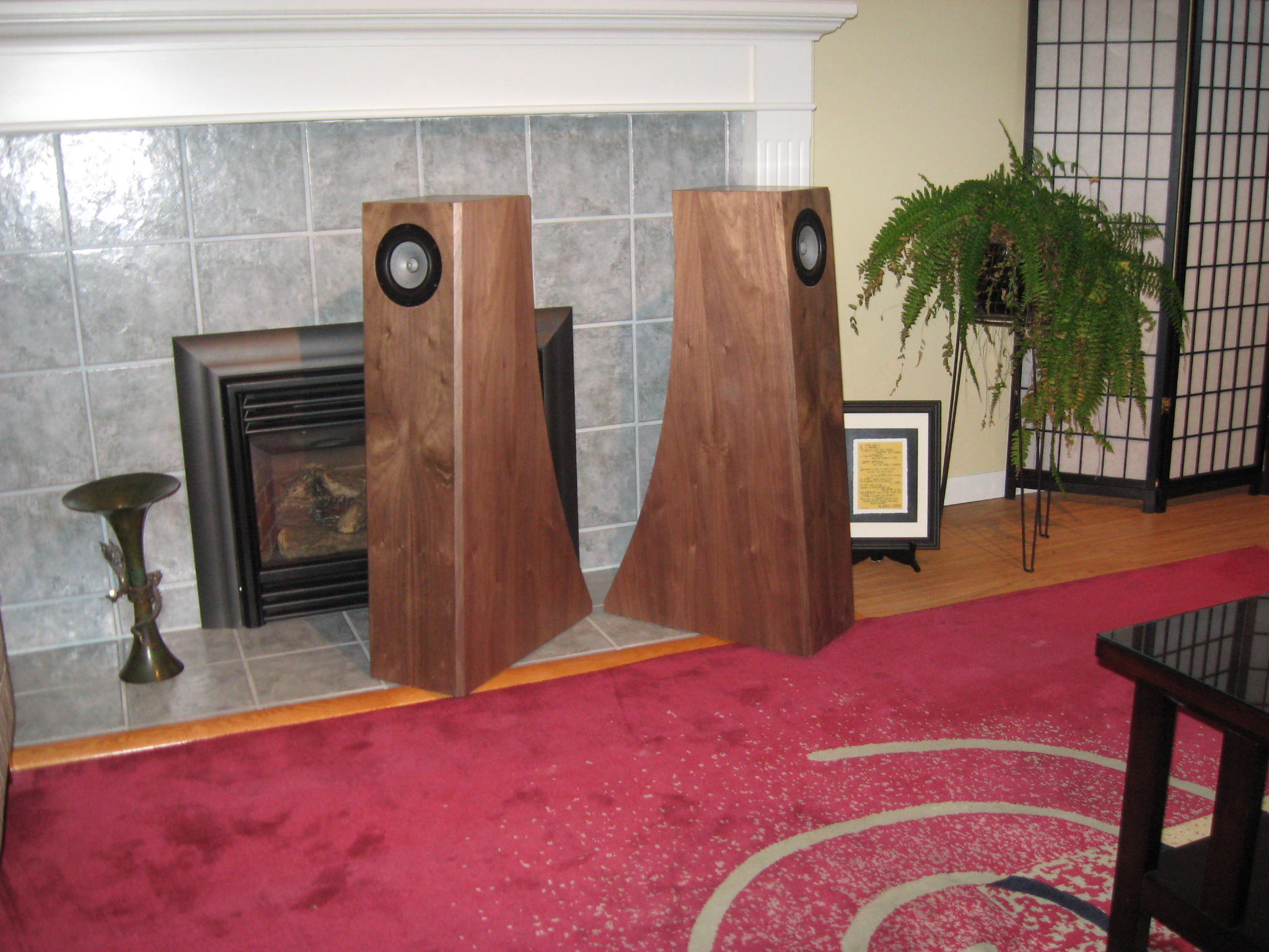

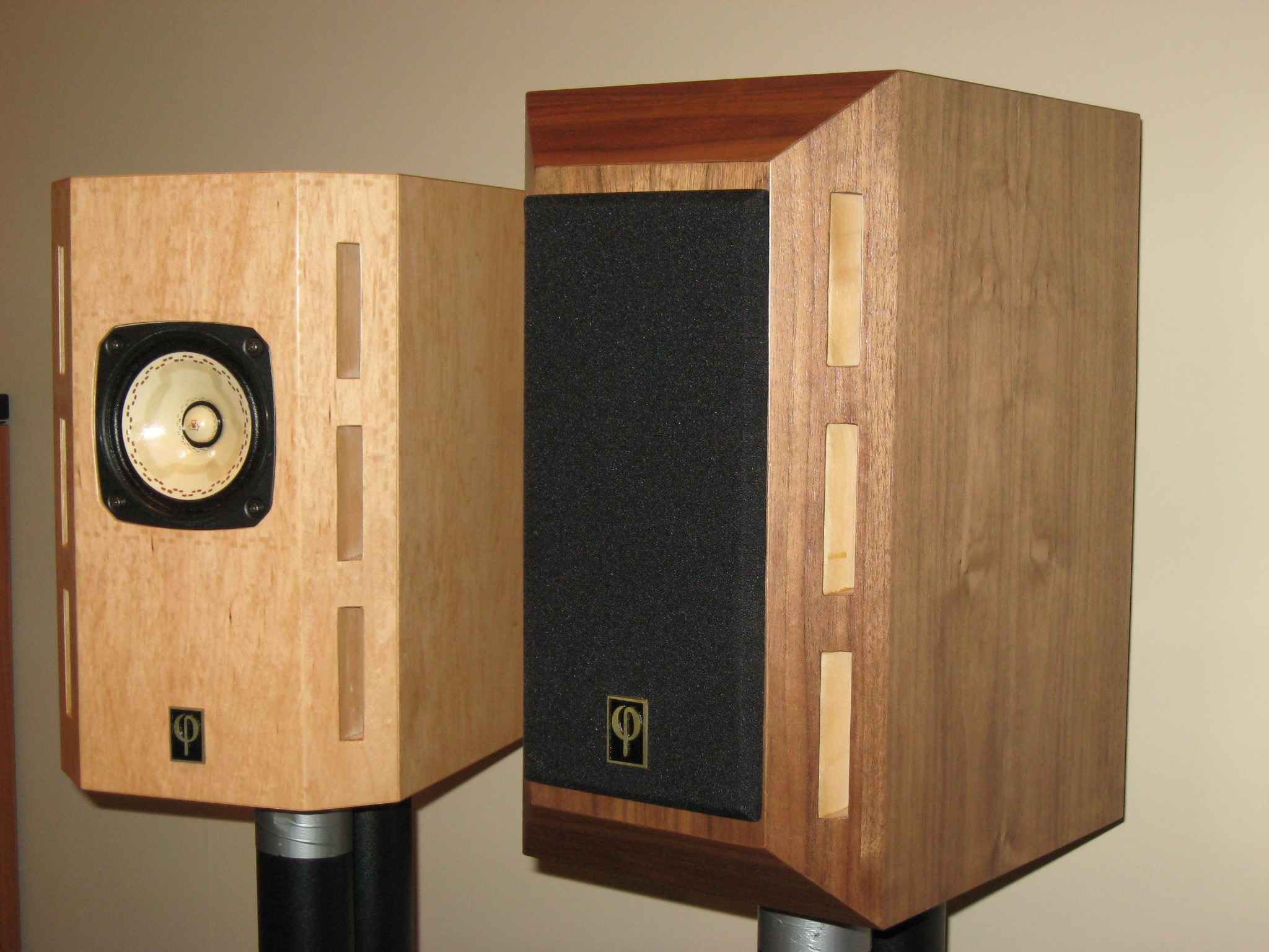

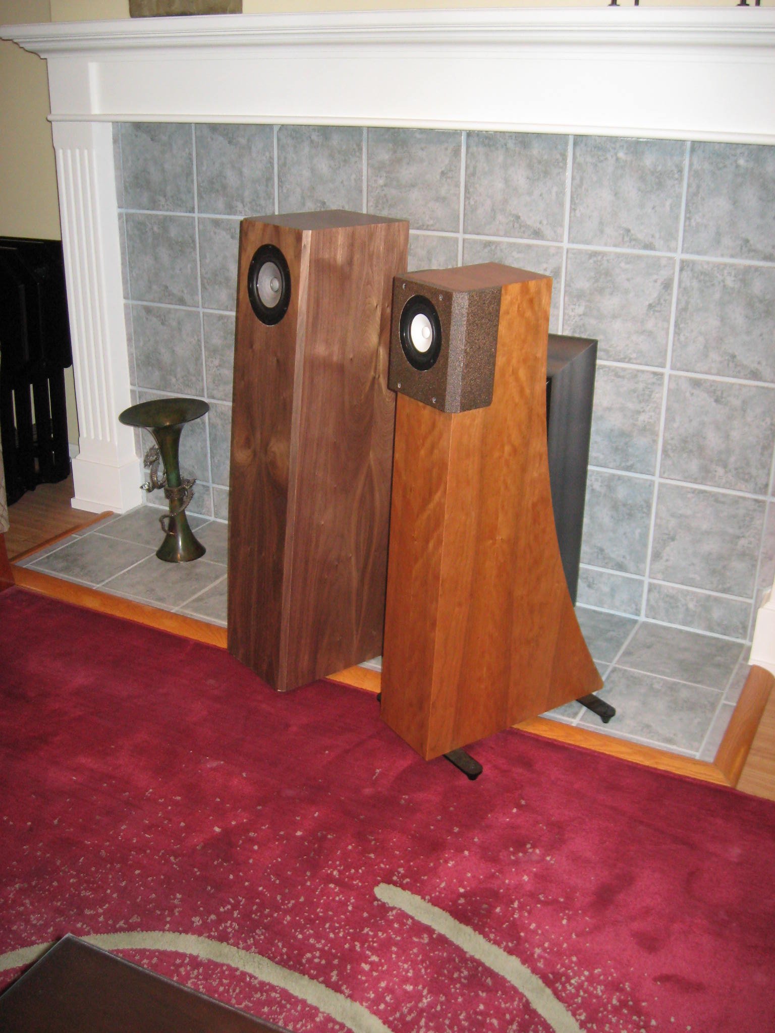

A early small stand mount pair Birds Eye maple and flat slice American black walnut.
