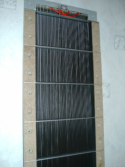

just a twist on an old idea
This is really just a twist on an old idea. Acoustat used this "encapsulation" method for all thier panels. They simply dissolved the base louvre material into solvent (methylene chloride) to form a thick syrup like liquid which they then ran across the PVC insulated wires at each horizontal point of the grid. Note that they used a machine to do this. I have used that exact same method (but done by hand) and it works well but is time consumming. The persent idea simply saves a lot of time and actually sticks to the wire insulation where as the Acoustat method was one of encapsulation only. Perhaps you were placing too much tension on your wire? I have found that you only need enough tension to keep the wire flat across the surface of the louvre.
The wire that I am using is made by Superior Essex and is the GP/MR - 200 series of copper magnet wire. This wire has a polyester base dielectric with a nylon top coat and can be purchased at an electric motor rewinding supply shop. This sounds (to me) better than the well aged Acoustat panels that it has replaced. While there may well be better dielectrics out there this is available and inexpensive and easy to use. Since this sounds at least as good as the PVC wire that Acoustat used (and is a far stronger dielectric) I don't see why the average diy type should be putting off building stators using this method. This material will yield an excellent quality panel which can be used as a base reference for any later found (superior) materials. As far as I can see the only real drawback to building wire stators on louvre has been that each and every contact point between the wire and the louvre has to be bonded so it does not rattle however doing this by hand that is a rather slow proceedure. Once done though this method resuts in excellent quality long lived panels. The method that I have suggested will save most all of the bonding time leaving the most tedious task that of actually winding the stator wire which is not really bad at all. There are other methods of doing the same thing such as precoating a layer of epoxy adhesive onto the louvre and then dropping the louvre down onto the pre strung stator wires. This method will yield excellent results but is slower and frankly I just don't like working with a lot of epoxy. so each to his own. I think that wire strung stators on egg crate light louvre are faster easier and less expensive to make than perf metal stators. But of course that is just my opinion. I would like to see a method that was totally safe (non toxic) for the diy builder to use on his kitchen table. This may well infact be possible using PVA adhesives like Weldbond. Someone may wish to give this a try on a trial panel. I like to wind the wire stator on top of the louvre. With a clean properly preped (sanded) louvre with the wires in place mist wit a 5 parts water 1 part Weldbond mixture (this acts as a primer) and let dry. Then run a thin bead of full strength weldbond across each horizontal rib of the louvre. Let dry. This should work well but please not that the dilute primer coat is critical to the weldbond sticking. While this method is slow (slower than epoxy) it should work and is totally 100 % safe and non toxic. Just a thought . Best regards Moray James.

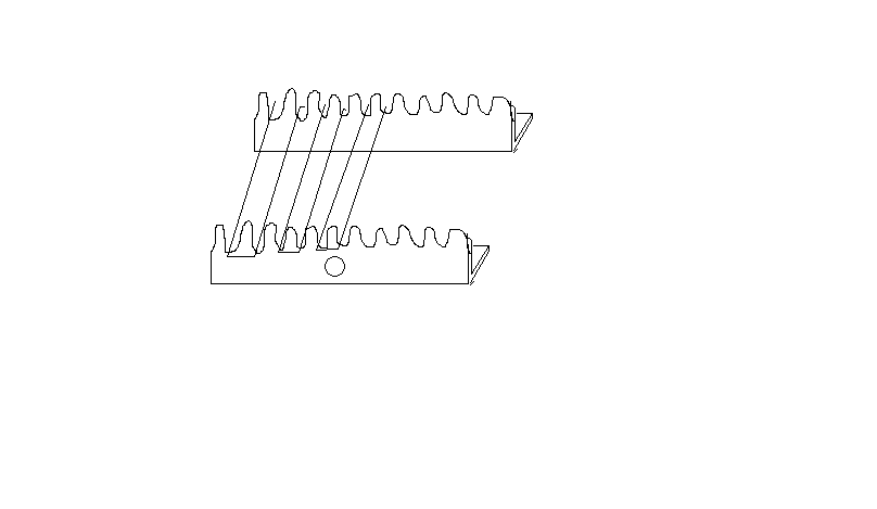

wire stator jig idea
Here's an idea for a jig:
Take a long board a little longer and wider than the stators you are trying to build. At two opposing edges of the board, glue the threaded metal rod for spacing guides as discussed above. Then wind the wire around both sides of the board using the threaded rods as your spacing guides. Now the board will have spaced wires on both sides, so you are ready to make two stators.
I haven't tried it yet.

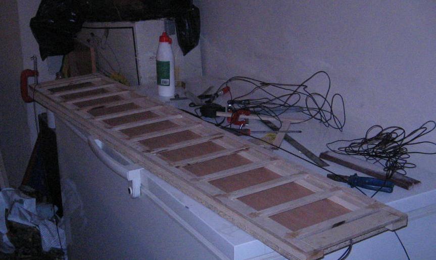

Thanks for all of your suggestions.
Here is the picture of frames that i am building.
The size of frame is 150cm x 28 cm.
I tried to strech one wire(Pvc coated , 2mm outter diameter, 0.5mm copper).The wire resonates like a string.If i press it with fingers at support points , part of wire still resonates , but at higher frequency.Is it possible to avoid this ? I think some kind of damping should help , is there any simple technique to do this ?
Sorry for poor picture quality , i had to recompress it.
Lukas.

Re: Straightness
Hi ,
What do you think about this principle ?
Lukas.
