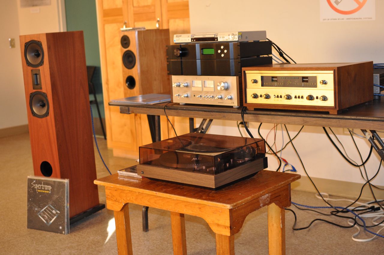

A pleasant surprise: we were able to listen to some vinyl. Wolfgang’s restored Dual 721 did a fine job. And he sure knows how to clean records! Dire Straits’ Brothers in Arms sounded as good as I remember when it came out. The dynamics and detail blew away the CD versions I've owned (including the XRCD2). Here’s a shot of the turntable. Notice the audiophile-approved turntable isolation rack :D.
