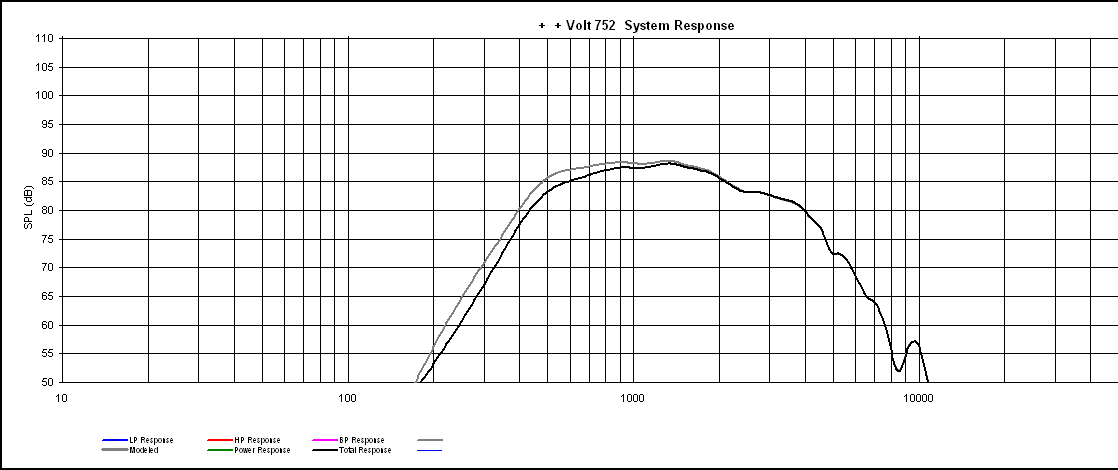

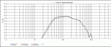

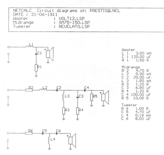

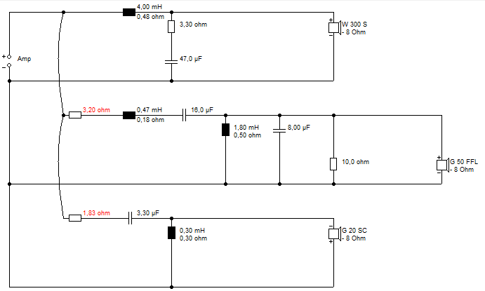

Ok, that's it I'm finished. I have had enough fiddling around.
What about a phase plot?
Won't help much because there are no two-channel measurements with real acoustic and electric phase information.
The posted simulations are only a vague approximation of the real speaker.
Ideally the speakers should be measured individually in the box in two channel mode with corresponding impedance measurments.
When you don't change the microphone position you don't even need SEO data (in mm).
Could you probably post the boxsim-file?
No but at least we can see from a simm that the new circuit is at least on the right lines. Assuming the measurements that were used initially were reasonable ones we'll have a good idea. Are neither of the measurements used for the sim actual in box ones then?
Stefan
Oh, I had assumed some measurements had been taken along the way somewhere. Still if we assume at the crossover points the phase plots (without filters) are around the zero pole and if we make some assumption about the acoustic centres of the drivers we should have some idea if phase tracks reasonably enough to bother building the filters. Does boxsim allow you to get a measurement using a virtual filter? so you can see things track as expected.
