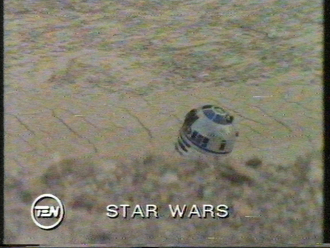

Maybe someone can tell me what tape format was used to archive this footage for 35 years: YouTube
I've got a copy of it of my own on Betamax (identical to whats show on the youtube video, plus the full movie recorded off of the TEN network.) (Received my Toshiba V-33 Beta Deck this morning so I've been able to see whats on the tapes that I've bought) and its pretty poorish quality (reception wanes after half way into the film) but I'll archive it anyway as its still worthwhile at least making a file of it.
