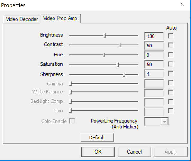

For the last hour I've also been using a cheap Toshiba dvd player to play back some still jpg images off of a USB flash drive and calibrate my capture card to those settings. The settings I came up with in Virtual VCR for the SAA7134 capture card are in the attached image below which are NOT the factory supplied defaults, pressing the default button gets you a much higher contrast setting for example.

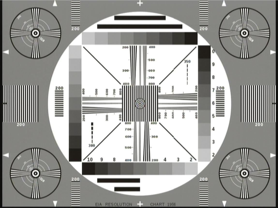

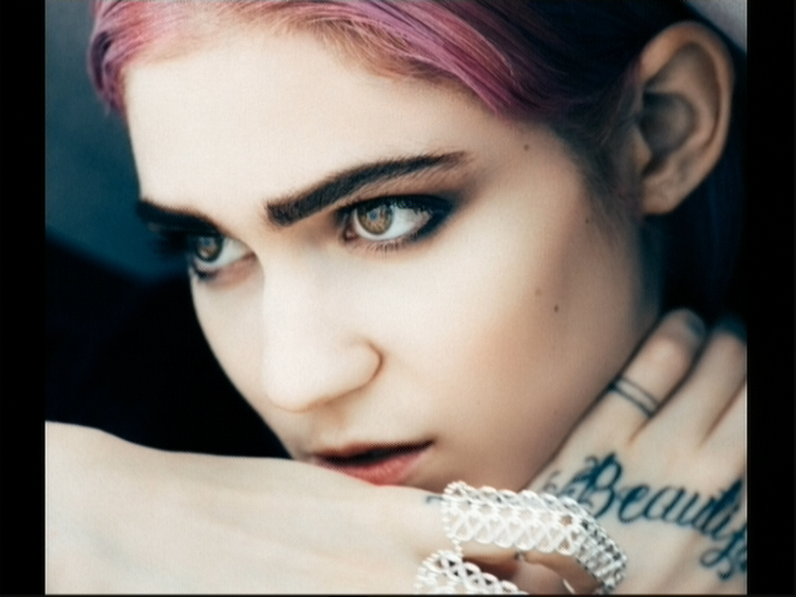

For anyone who thinks that Full D1 PAL 4:3 Aspect Ratio is just plain obsolete and an old fashioned aspect ratio not worthy of anything and that 768x576 is too low of a resolution to convey any sort of information. Well... I would like them to have a look at the captured image below and I challenge anyone with a modern day bluray setup to show me a scene in a modern movie where the actors face is this zoomed in.
This is what I'm talking about when people who still love VHS and the Pan & Scan method are still using the equipment even today, when you get close up to an film artists face you can truly relate with the person a lot better. That is what I miss about the old 4:3 aspect ratio, CRT televisions, and VHS in general.
This is a cropped screenshot of Virtual VCR playing back a preview of an analog loopback (through my Panasonic 6 head VCR, just sitting there in AV mode, not recording) from the output of my DVD player which is playing a still JPEG image off of a USB flash drive. This is the full capacity (sans the chroma noise) of Composite analog video.
It appears that my capture card's (and VCR and DVD player) maximum resolution is approx 500 TVL.
