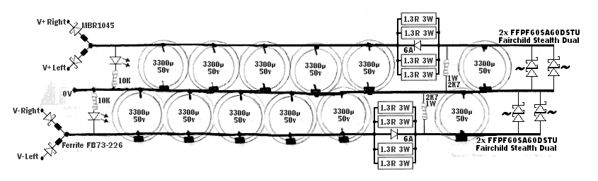

Here's an example with Fairchild Stealth Dual (see attachment).

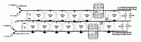

The 6a05's can also be replaced with Fairchild Stealth 600, 16a (the CRC's "R" is diode bypassed to reduce sag, aka increase dynamic punch).
I like this supply very much.
The ferrites (or a knot) and the MBR1645's (or more Stealth) actually belong, after the cable, at the edge of the amplifier boards, if possible.
Yes, it is dual mono with just one supply. Schottky are fun.

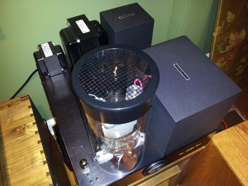

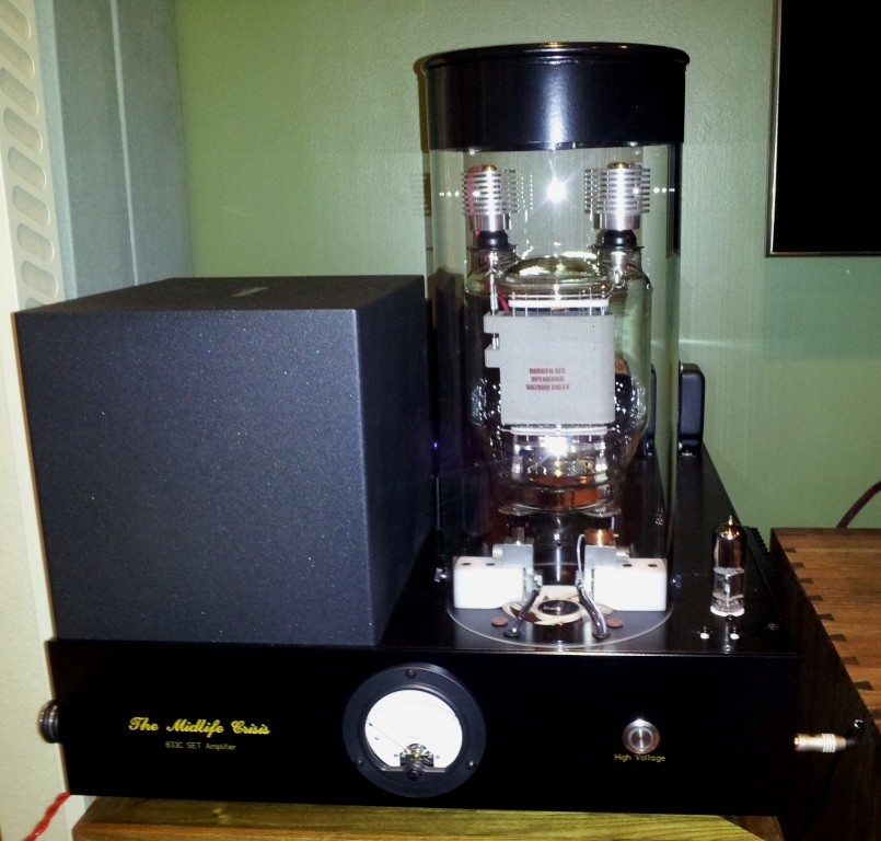

My Midlife Crisis mono amps use Cree SiC Schottky diodes. Each mono has Twenty 1200V in the 2.3kV output supply, four in the 450V driver supply. The 10V, 10A filament supply uses four 100V Schottkys. The 6.3V DC heater supply for the driver tube uses a single Schottky bridge (SMD).
So I guess we can say some DO use Schottkys in the PS!

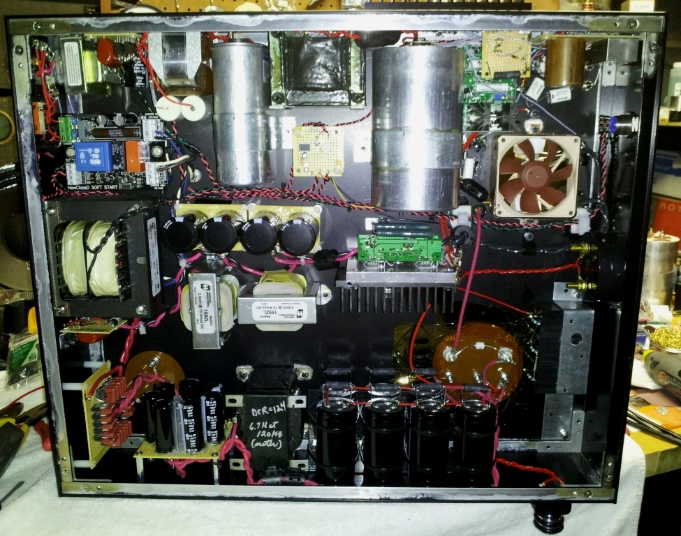

Top Side Pics.

What is the diode doing?the CRC's "R" is diode bypassed to reduce sag, aka increase dynamic punch

In your post #8 the C-R-C supply shown has +/- 16,500 uF before the resistors and +/- 3,300 uF after them. Wouldn't it be better the other way around for the following reasons:
1) having lower capacitance before the resistors will reduce charging currents and hence radiated RFI from the wiring.
2) having higher capacitance after the resistors will increase the low pass filtering effect, thereby reducing harmonics of the mains frequency.
Like AndrewT I don't get what purpose that diode in parallel with the resistors serves other than to drop the voltage slightly.

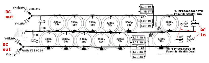

... the C-R-C supply shown has +/- 16,500 uF before the resistors and +/- 3,300 uF after them.
I think you might have misunderstood the schematic. AC from the transformer secondary is applied to the diode bridges on the right side, and DC to the Left and Right amplifier channels is taken from the left side.
