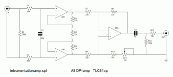

I always have problem in my home sound system .. when I connect the '' personal video recorder '' to the sound system.
In my sound system I have a FM tuner using an outside antenna with a 75 ohm cable, and this antenna must be grouded for safety, a 4 feet pin in the ground, then the PVR is grounded on local cable distribution network.
The 2 ground of course dont match ! the typical ground loop problem.
This afternoon I was thinking of using an instrument amplifier to get some isolation and get rid of the hum & noise I get. So I desing this project ( below).
This amplifier should have his own power supply , for the input I will use shielded cable with RCA plugs to keep isolation betwen input and output, there will be only one pair of RCA jacks on the case for the output.
Should I build this amplifier ? or do you see a better solution ?
A TL072 (or any op-amp you could afford) has NO chance of working at FM broadcast frequencies (!!!), and even if it did you certainly wouldn't use that circuit for it.
A much better solution is in the first link of post #26, the RF transformer, or even the two-capacitor thing. If you use the two-capacitor schematic, put them in a metal box with one connector's ground connected to the box's case and the other connector's ground insulated from the box. The text says how it's still susceptible to interference, but it's easy (depending on your metalworking skills) to put the circuit into a small metal box for shielding.

So I build the instrumentation AMP and now I did get rid of the noise.......
Maybe it is not tho most elegant solution bu it does the job.... and for the sound quality 3 more OP amp in the path .... I am not worried it is only television ... and they use MP3 for sound.
Now I have to work on a new problem, the instrumentation amp works perfectly and I have built a power supply for it.
Basic configuration: power transformer, full wave rectifier, electrolitics, LM7812 & LM7912, electrolytics and decoupling caps at input & output of regulators.
But the unit do not shut down quietly .... there is a strong oscillation while shutting down.
I there something i have missed ? or a trick I should know ?

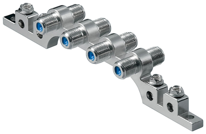

Google cable ground block.
Extreme example: RG6 Quad Cable Ground Block at SatPro Can't complain about 89 cents (shipping will be more). Is a bit bulky. Single and dual blocks are readily available. Add very short jumper cables (That store only has a 25-pack for $40. Does tell you that 18" cables must be needed in large quantity.)

I found a grounding block on amazon UK. £5.80
4-way ground block
4x F-female>4x F-female
nickle plated
My aerial cables come into the house many tens of yards/metres away from the electricity distribution board.
Should the grounding block be connected to the PE wires in the power sockets in the cupboard where they terminate?
The ring main uses ordinary 2.5sqmm+Earth. Not much area for conducting a lightning strike.
There is no route to run a thick copper tape back to the distribution board.
