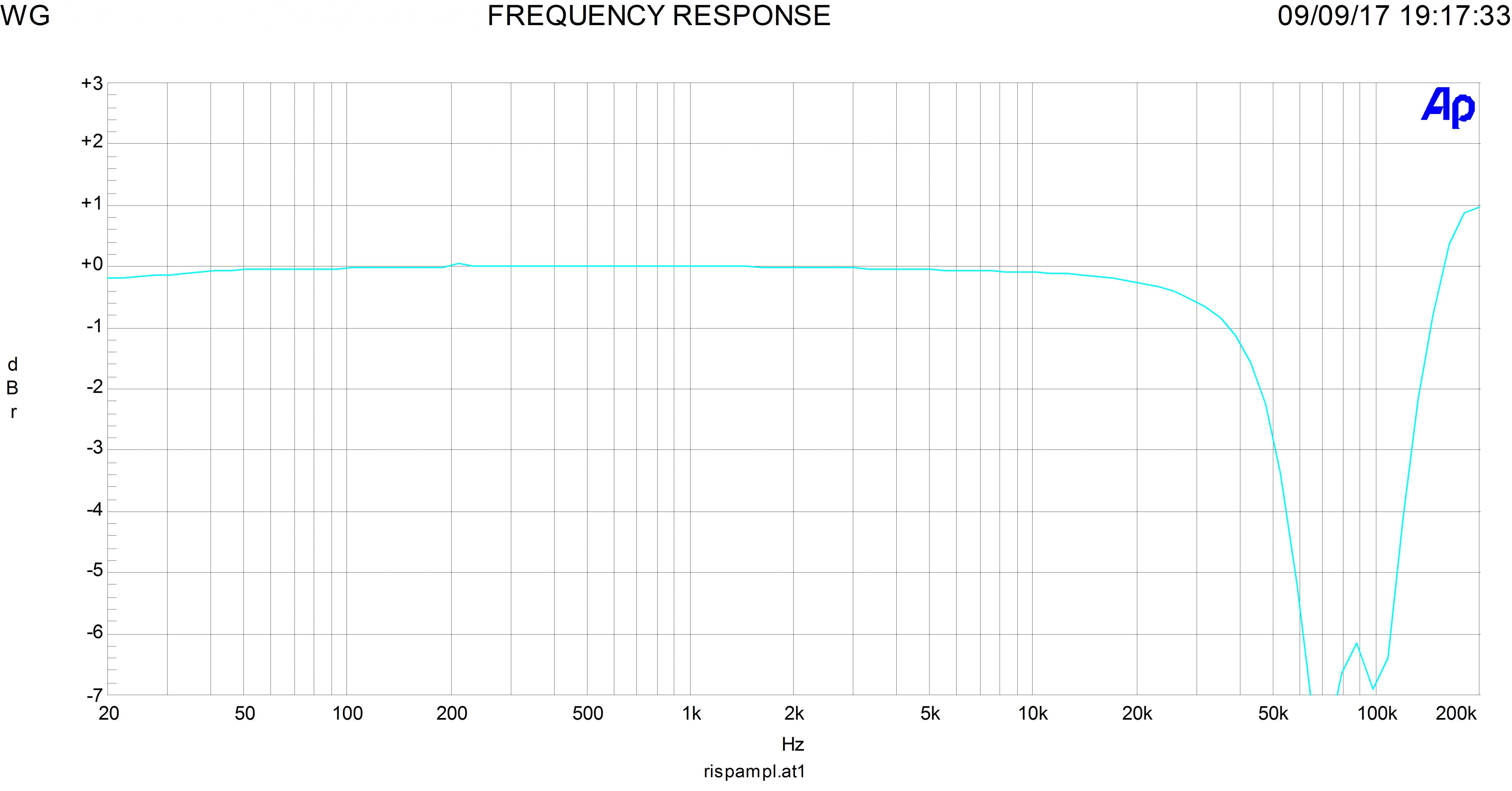

In Audioreview we use the test at 1 watt as reference ( it is compliant with intl standard)
Then we check also with other power and methods.
In attach the freq. answer at 10 watt for a KT150 with Hammond in UL with 6 db of FB.
Walter
