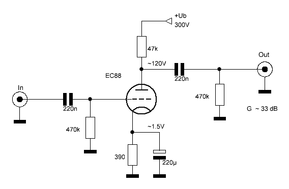

As a voltage amplifier, try to begin with a circuit like this. The cathode resistor may need to be fine tuned to get 1,5 V at the cathode.
The gain is about 33 dB and maximum output level > 100 Vp_p with some 2 Vp_p as the input level
This stage is suitable to feed high impedance circuits such as phase splitter, LTP, or typical SE output tubes.

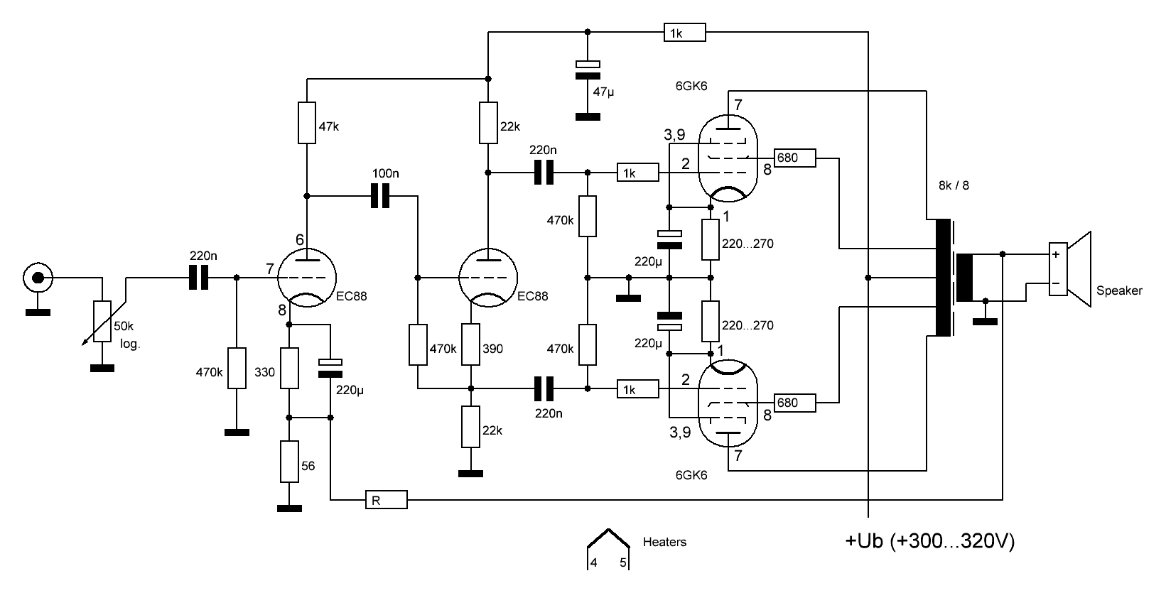

my next project is a hifi stereo with pp 6gk6...
Then you could have an approach like this. I used EC88 at the phase splitter too. The cathode resistor of the phase splitter should be adjusted so that the cathode voltage is 1/4 of the supply voltage, i.e. about 75Vdc.
The negative feedback resistor should be determined. One good way is to install 10k trimmer in the place and adjust to get some 10...14 dB gain reduction.
The output stage is according to the recommendation of GE data sheet. It requires some 10 Vrms drive voltage for full output power, and as the gain of the voltage amplifier stage is about 50, the sensitivity without GNFB is some 0.2 Vrms. With 10...14 dB GNFB the sensitivity is between 0.6...1Vrms, which is quite suitable for line level music sources.
This is the simplest possible circuit, but I can't see any advantage to spend more tubes for example for LTP phase inverter.
There may be something to fix, since this "design" was done during my lunch break.

If you add a tone control and use 6C4 tubes, then the gain calculation should be done.
6C4 has mu = 20 and 6AV6 100. All can be done, but it requires some real design work to do.
If I build an amplifier, I would keep the voltage amplifier + phase splitter + output stage as an own section and put tone controls etc. in front of this.

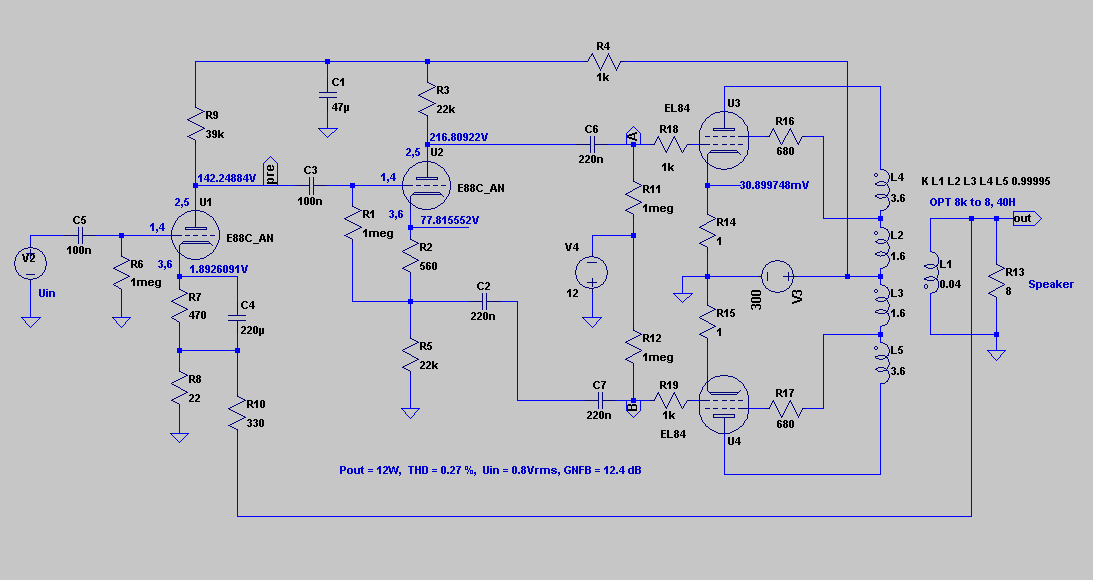

Thanks to jazbo8 who gave me the E88C LTSpice mode.
So I completed the EC88 front end design with simulations.
I "built" the whole amplifier, but with EL84, because I don't have 6GK6 tube model.
However, EL84 is very similar. Below is the result with modified component values (compared with the schematic I posted earlier).

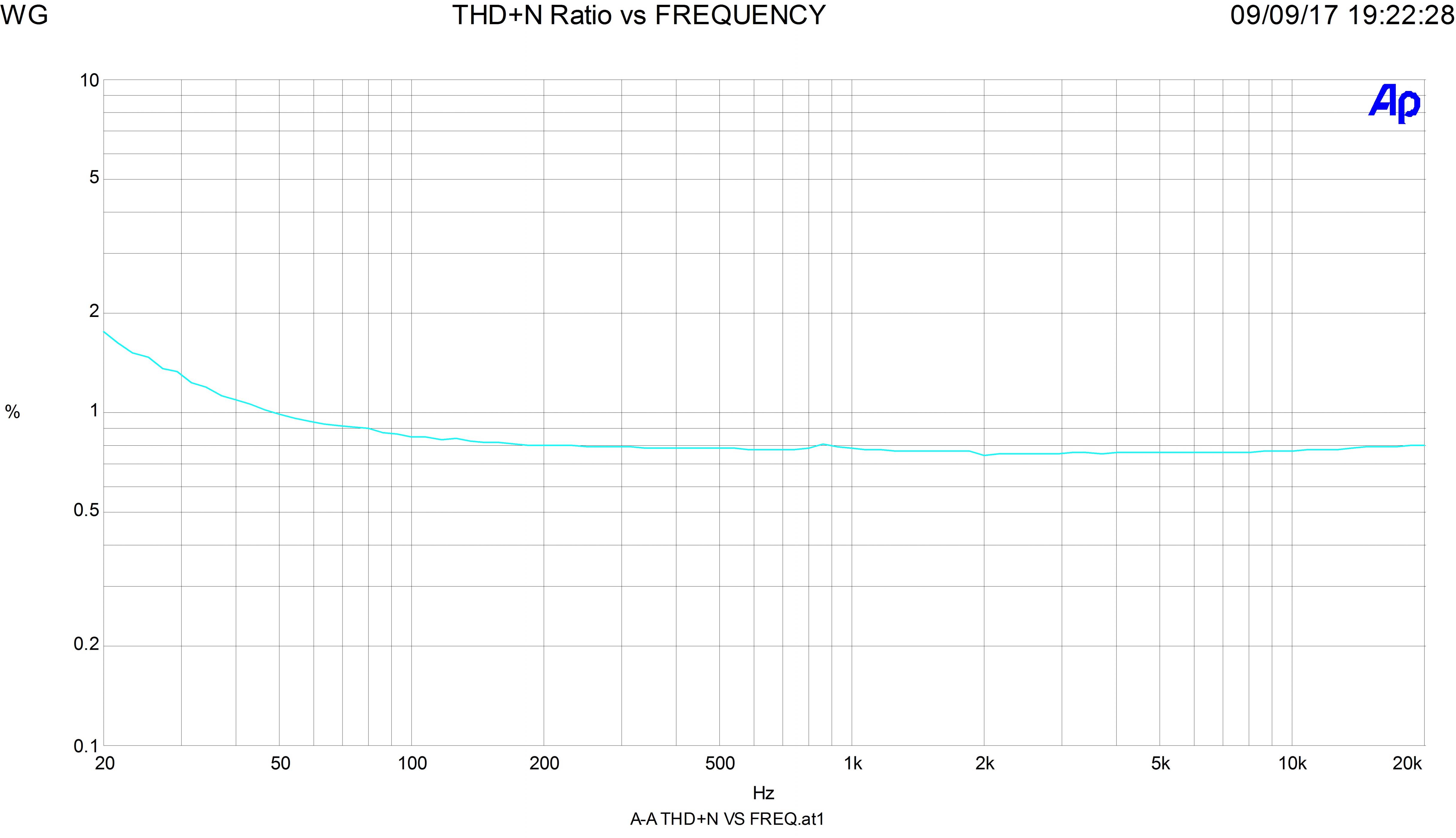

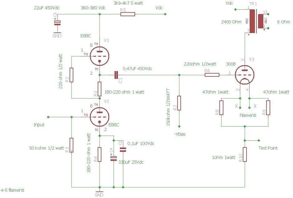

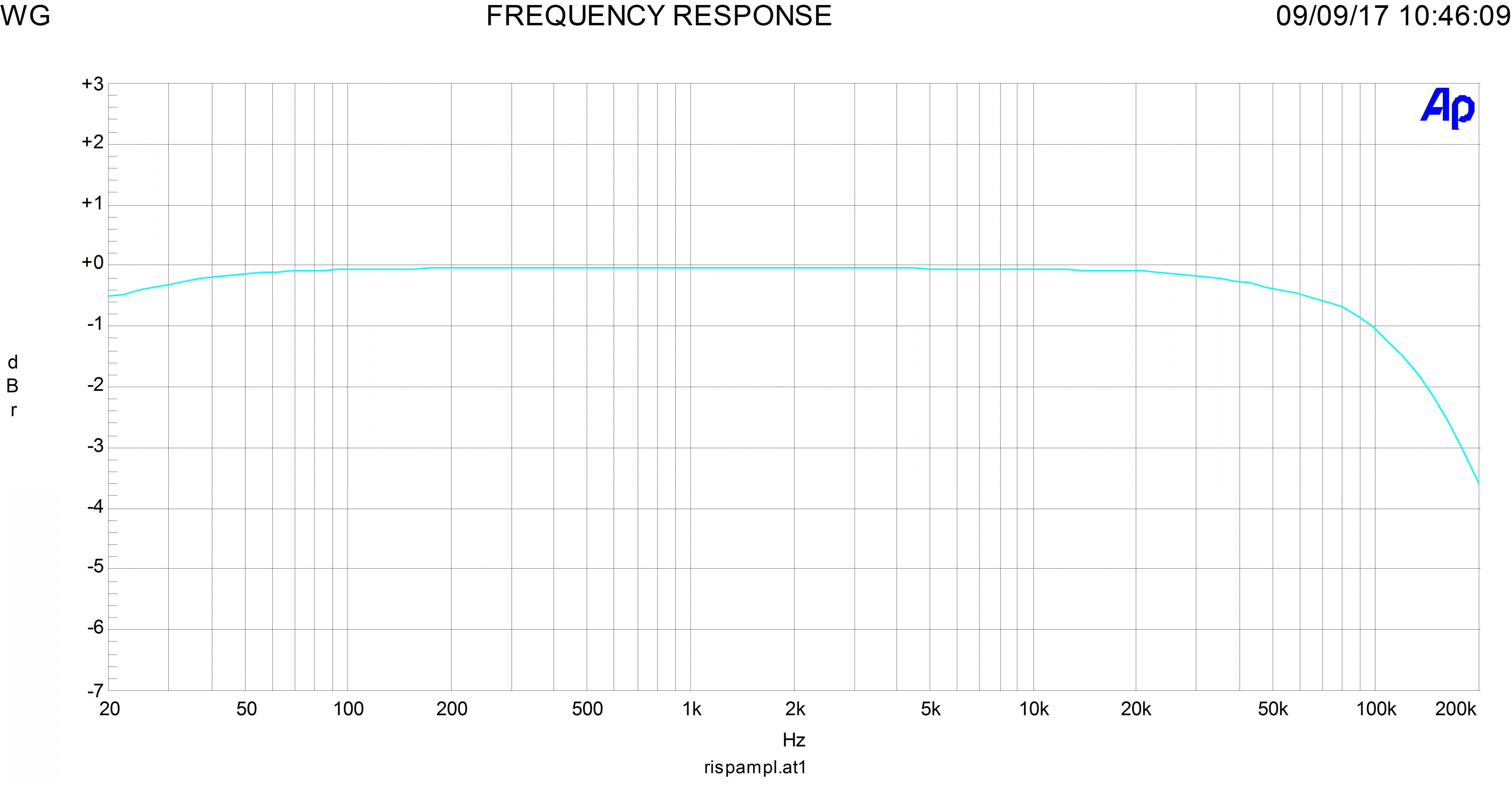

Hi
in attach some tests on the scheme I sent days ago.
Fig. 1 is a freq answer of the input stage with the srpp of E88C; it seems to be good.
450mV in for 20 Vout
with this signal I got 1 watt on 8 ohms with 0,23% of thd
I test three se trafos: Hammond 1627 se, Sowter SF08 and a proto from F.I.A.T. and 300B-98B
The results are:
HamRIS1w: Hammond freq. answer 1 w
Ham THFR_: Hammond thd vs freq
Sowris1w : Sowter freq. answer 1 w
THFr_12-2 : Sowter thd vs freq 1 w
F.I.A.T. Fris_1w F.IA.T. freq answer 1w
F.I.A.T. THFR_1w thd vs freq
Also a UL connection with Hammond 1627se ( it has a UL tap) and KT150 and 6 dB of feedback
Fig.15-KT150UL_fb6dB freq answer 1w
Fig.17-KT150UL_fb_1w_thd_freq thd vs freq 1w
All these test are on Audioreview magazine im Italy where I have a collaboration
Bye
Walter
