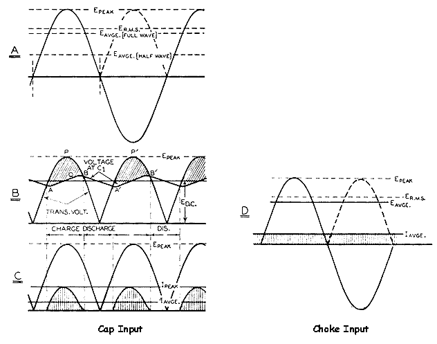

Do diodes sound different? Sure they do. What's best? It is circuit dependent.
In many modern power supplies -- where we have transformer>diodes>caps, there is very little real power supply isolation. This scheme creates a 1st order filter and a whole lot of garbage gets thru.
If you look at a tube amp supply -- or a typical Pass supply you will see at least a CRC -- 2nd order. CLC, 3rd order... (some generalization here as the inductance in real caps, and the capacitance in real chokes can get you in trouble...
Much of the problem with diodes is that a cap input supply has a short conduction cycle, and when the cap is full you get a big reverse spike. A soft recovery diode should help (a vacuum tube rectifier being one of the best in this regard), as should a snubber ... the best solution (ignoring efficiency, since you need to draw suffiicent current to keep the magnetic field from collapsing) is a choke input filter.
