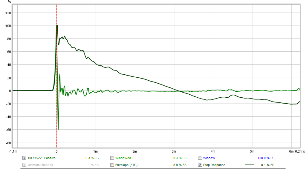

My 10F/RS225 FAST are upside down (tweeter below woofer) and it gives perfect time alignment for transient perfect XO. The chest punch of audio is more substantial with the woofer at ear level. It sounds natural and the percussion is very clear and sharp.
https://www.diyaudio.com/community/threads/10f-8424-rs225-8-fast-waw-ref-monitor.273524/
here is the measured step response:
Thanks. I am very close to these speakers almost texas headphone orientation when I started to hear the null. In theory my setup should be somewhat phase linear through the crossover region - at least before it hits the drivers. I am using a phase offset to correct the LR2 and it's phase distortions on these monitors. I may have just not had them up high enough but I really didn't want to redo my entire setup so I sat low - the woofer was in the exact same place.
So could it be that the vertical lobe was reflecting on the floor or something causing a null? Or is it just the characteristics of these drivers?
Do you have an equalizer? What you are describing could likely be fixed with an EQ.
