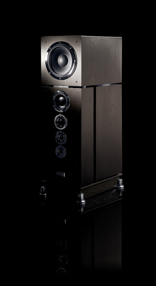

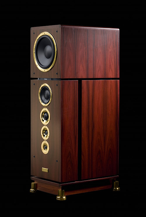

When I originally engineered my 3 way Helios I placed the midrange above the tweeter and woofer below it, then I played with crossover slopes until my on axis frequency response was fairly flat, while the null between midrange and woofer at the projected "suckout" point was tilted toward the floor. It worked out. Normally I would have a floor bounce related cancellation at 400-500Hz at listening position, but having a 500Hz null pointed at the floor, mitigated it to a degree- at least in simulations.
So, unusual placement of drivers can be part of design.

Do you have an equalizer? What you are describing could likely be fixed with an EQ.Thanks. I am very close to these speakers almost texas headphone orientation when I started to hear the null. In theory my setup should be somewhat phase linear through the crossover region - at least before it hits the drivers. I am using a phase offset to correct the LR2 and it's phase distortions on these monitors. I may have just not had them up high enough but I really didn't want to redo my entire setup so I sat low - the woofer was in the exact same place.
So could it be that the vertical lobe was reflecting on the floor or something causing a null? Or is it just the characteristics of these drivers?
- Why is the tweeter above the midrange/ woofer?
