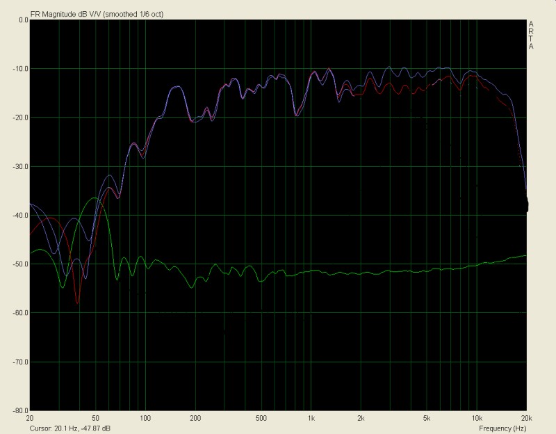

They are about 1.3m away and its an 1/6 octave graph. Same thing happened when I calibrated my desktop computer speakers.
When they try that live for big space its bad. They must pursue the 2dB per decade droop from 0.2k to 20k. I do that.
Its not about liking. We perceive more direct sound from both woofer and tweeter nearfield on axis especially in dead control room fronts. So the energy is balanced near as intended in anechoic on axis testing.
In farfield we get average energy from diffuse field. Lower frequencies develop around axis with bouncing delay, when higher frequencies beam and get to us more directly on axis and die around axis. So when we pink with infinite averaging we see a homogenized curve but we still perceive less direct sound down low. Our brain knows direct and reverberant. If we pink for flat, that means we tip up the direct high frequency energy. If we pink for droop, thats how wide band averaged energy develops far away in nature. and we perceive it naturally.

The 2 situations you talk about, are existing in the two cases I calibrated. Firstly the Tannoys that are located much more away from his head plus they drive the room for all to listen, I made them to show the droop to sound ok. Nice thing is they gave the same basic balance as the flat nearfield Dynaudios for the producer's working position. If we go 3 metres away from the Dynas and widen their angle to drive the room, we will automatically see the droop - no digital parametric module touched. Its the narrowing propagation angle with frequency in interplay with absorption that leads to the farfield droop. The popular error is that anechoic flat must be replicated far away. Well WRONG!
The purpose of nearfield monitoring is less room reflections from listening nearer and softer so we hear deeper, not tilted up to catch resolution. I assure you, although we talk 2 very different systems in different positions for different reasons in that studio, after the calibration, the perceived balance of the mix was identifiably the same for all intents and purposes. My mate was all grins.

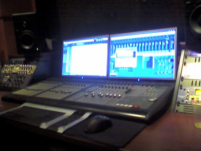

Had a pic
I had a pic in my mobile, it is low resolution. A Tascam controller in foreground, Nuendo is running on the monitors, Avalon and Manley tube mic preamps on the left, and a glimpse of the Dynaudio nearfields.

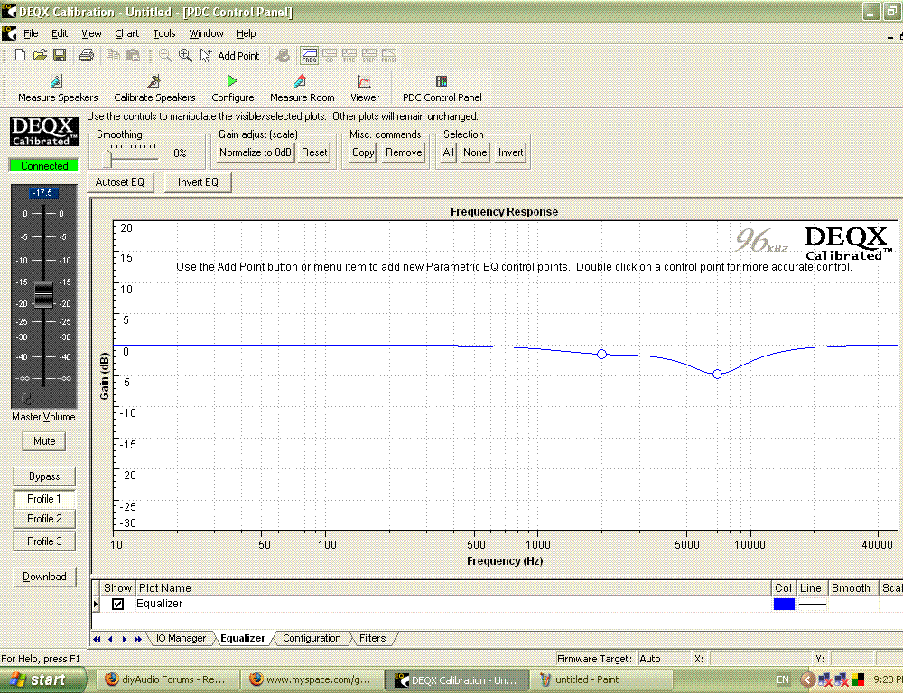

Well, have had a little play, and with what I feel are interesting results.
I've attached a shot of the eq settings I used, which I feel at least approaches what DDF was getting at (if I've misinterpreted it please let me know). Of course, in use I also have all the bass eq loaded but it is a bit clearer without that on the graph as well.
As I say early results yet, with very limited listening.
First off, I did not particularly notice any change in the centre image, which was always pretty good.
The overall perceived brightness was not particularly changed either.
On the few purely instrumental tracks I played, did not really see any difference good or bad, which either says I have very poor ears! or the change is at least benign.
The instrumental tracks I mentioned are on a 'test' disc I use, so am very familiar with it. Also on the disc are some vocal tracks (naturally) and this is when things got a bit interesting.
On the 'test' disc the vocals are pretty well recorded, but I felt they were quite noticably more real and enjoyable. On one particular track, which as I say I'm very familiar with, I suddenly was VERY aware of the fact of two vocals, one on top of the other. I have to conclude that I must have been aware of it previously, yet to be honest I would have to say that it was very clear and distinct this time around. I find it hard to believe that I could not have picked it any time previously, yet i don't ever recall being aware of it before...????
Now I know it's there I'm certain I could hear it w/out the eq, but I find it very interesting how very much aware of it I suddenly became.
Funny little digression. When this topic started it appealed to me to test it, but was unable to do so as one of my drivers was off for repair. In the meantime, I bought a couple of cd's and so when the sytsem was up and running again of course I put them on. I was very disappointed, and remember thinking 'was my system not as good as I remembered?' ha ha. The (both as it turned out) discs I bought happen to be very sibilant, and a 'reality check' with other cd's showed that the system WAS as good as I remembered, but was thrown a curve ball by these two cd's I bought.
SOoo,, to cut a boring story short I threw one of those sibilant discs on. It was gone!!!!! Sure, you can still hear the t's and the s's, but boy were they improved! From tttttt to tt, ssssss to ss.
At times the sibilance was really irksome before, now it is such a relief to be able to listen without being angry at the poor recording.
Have not done enough listening to disprove the opposite, ie most normal vocals still sounding good, but the vocals on my 'test' disc seemed to be improved as well so I have no real fear in that regard.
As I say, early days yet but right now am very happy with the results, so thanks to DDF and all who contributed here!!

ok testing, and in case it doesn't appear (after the 394'th try, but hey whos' counting?) the settings are
7000hz -4.5 db Q 1.15
2000 hz -1.2 db Q 0.66
