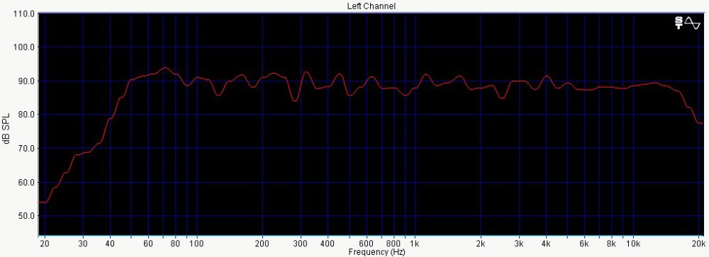

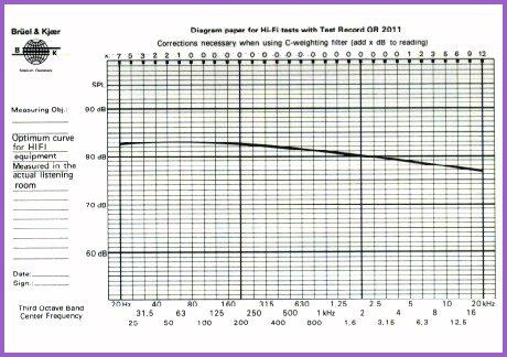

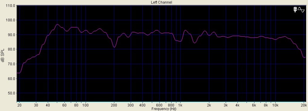

The problem is that every room is different, and speakers do not all have the same off axis response. That makes it hard to give a good rule of thumb.
If you search google for 'room curve' or 'house curve' you'll find something. Here's one graph I had saved.
Rob.

just to make sure we are on the same page, if I measured the speakers response at the listening position, it would be a flat line from twenty to twenty??
I'm not particularly disputing it, but speakers that I've measured flat on axis at say a meter always show a dropping response as we go higher in frequency once the room interaction takes place.
It is hard to find concrete data/opinions on this, as suggested earlier did a google on house curve/room curve, and only a few 'usable' results came up.
One that was quite specific was from Accuphase when discussing the dg-28
"If adjustment is performed so as to achieve fully flat frequency response aT THE RGULAR LISTENING POSITION, THE AUDIBLE RESULT WILL BE FELT (sorry bout caps lock) to be very bright. Normally a gradually declining curve towards the upper frequency region is preferrable.
Therefore the dg-28 incorporates preset roll off characteristics, with 1, 2 and 3 db attenuation per octave, starting at 2 khz"
One would presume that is some sort of auto eq function when taken from the listening position.
