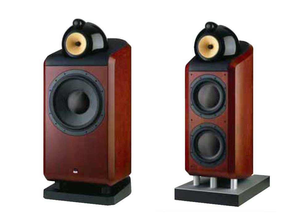

B&W published a white paper for the latest 801 Nautilus with measured data plus listener reviews which made the case that new motor and cone technologies allow one 15" woofer to have superior transient performance over multiple smaller woofers. BUT, one year later B&W started to market the 802 Nautilus which uses two 10" woofers in a much more living room acceptable size, AND this twin 10" model quickly became the best seller. The picture is worth 1,000 words.

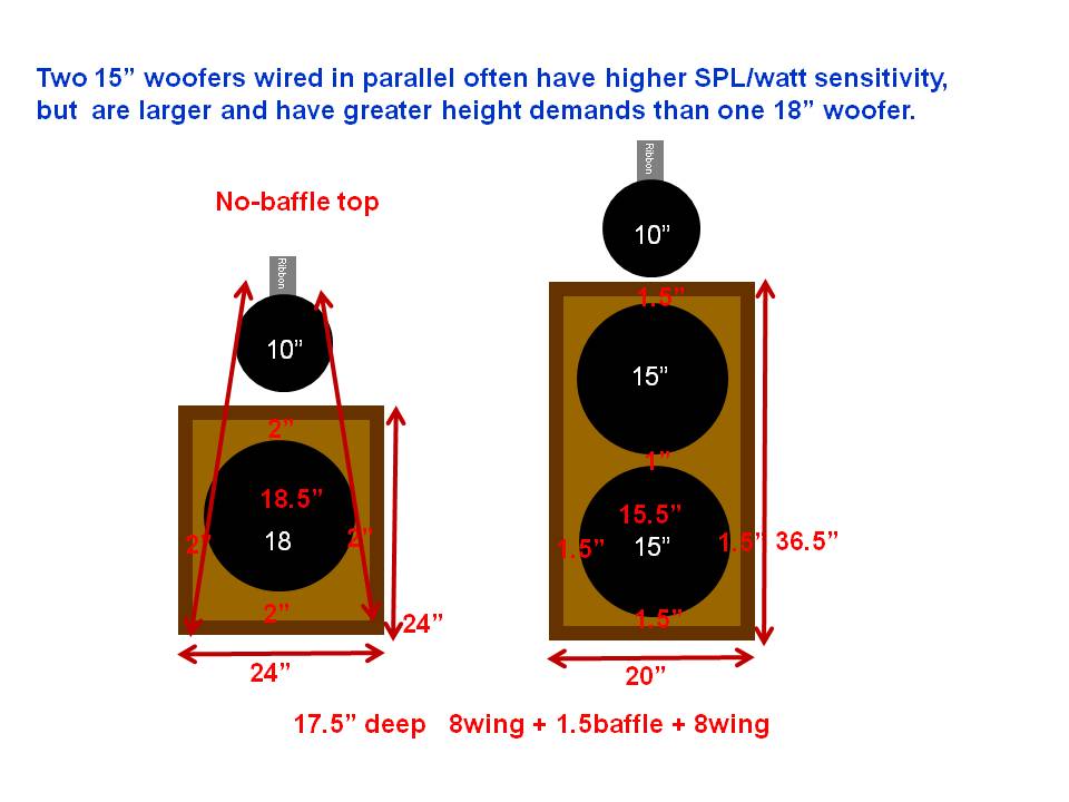

Personally, I've been watching for a superior home audio 18" woofer with 96-98 db/watt SPL which can cover 20-300Hz to replace stacked 15" woofers with a smaller(shorter) box. I believe NdFeB radial motors and carbon fiber loaded paper cones will make 18" the new favorite size for efficient DIY bass.

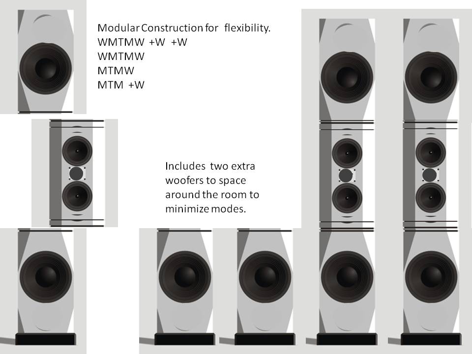

Dr. Geddes has been adding new research on the value of putting multiple woofers in the room to remove resonant modes. This type of room bass solution could provide large volume displacement from four or more modest diameter woofers... say 12".. instead of two monster woofers or two monster bass horns.
