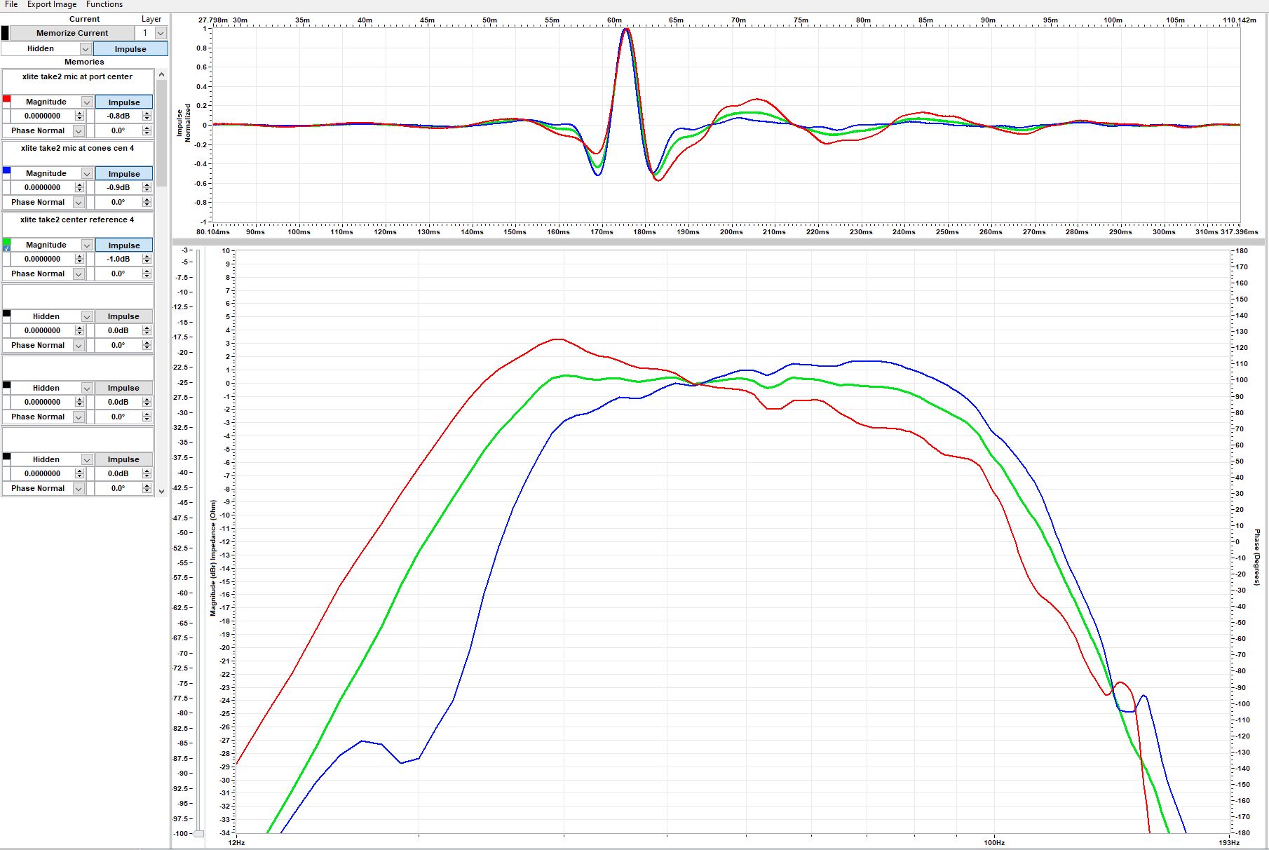

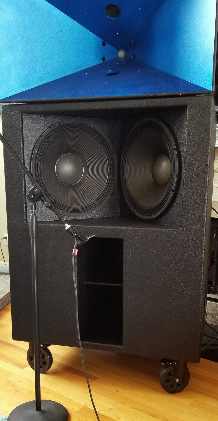

I have always wondered how real is the typical presentation of summed nearfield spl's ot the direct radiator and port.
I don't trust indoor measurements of the direct radiator and port stitched together....they never seem to match up very well with what I measure outdoors.
But here' one, (my latest sub that I recently posted about over in subs), that I'm getting very clean measurements indoors with mic 4" from sub up off the floor, that match outdoors at 4m with mic on ground.
Green trace is mic centered directly between drivers and port (as shown in pict), and is the one that matches outdoors at 4m.
Blue is mic raised to level w drivers' centers.
And red is mic lowered to be centered on port.
1/24th smooth, no gate,
(hard to read mag scale on left ....sorry still learning new software)
I'm guessing this sub has good indoor vs outdoor match, is probably due to the big port so closeto the somewhat recessed drivers.
(Dunno really, but I do know I'm loving the sound.)
Anyway, I've played with sealed vs ported a lot, using these same drivers and all kinds of filter strategies to try to make apples to apples comparisons.
Personally, I think if ported is well done, sealed has no sonic advantage. And i find sealed is about twice as expensive to implement to get it to match ported's low corner and SPL.
Would also like to say, I've come to think of ported boxes as sort of 'two-ways' all on their own.
The direct radiator, and then the port.
Helps me think about where i want the port(s), what size/length, and how I expect it to work given the acoustic path length differences.

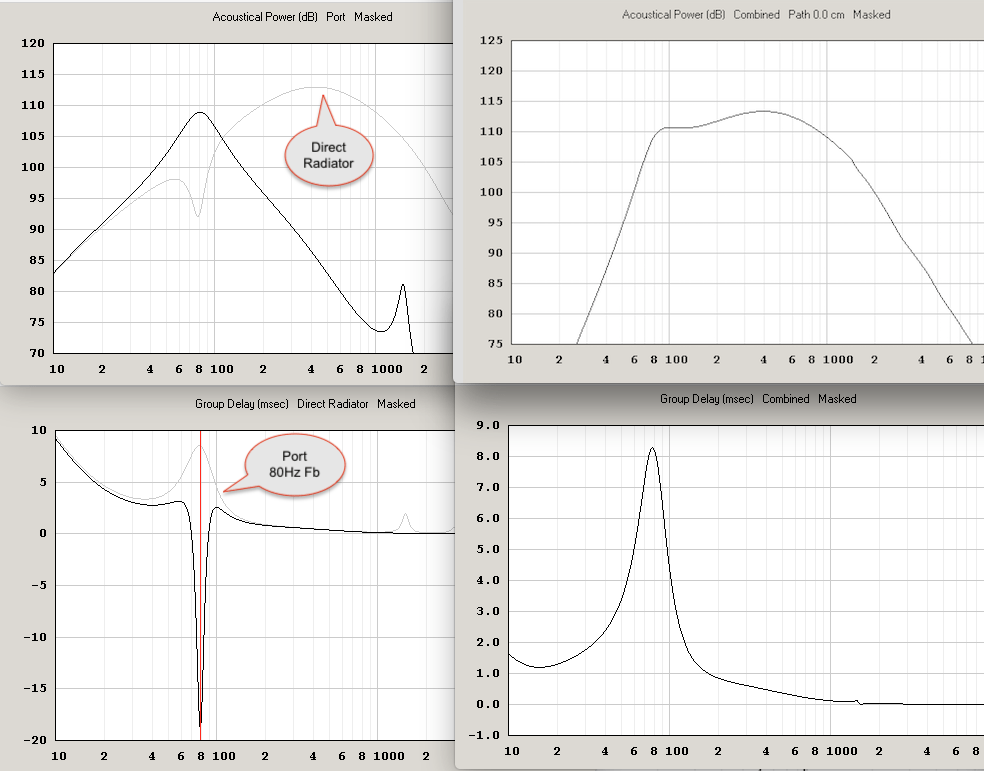

I can give David McBean's explanation from Hornresp help:Interesting points you raised.
In the first image the direct radiator appears to have negative group delay, can you help me understand that?
"Group Delay:
Negative derivative in milliseconds of the loudspeaker system phase response, versus frequency
in Hertz.
Group delay is a measure of the rate of change of phase with respect to frequency, and is positive when the phase slope is negative."
The word "resonance" is from the Latin resonantia "echo", or "resound".I disagree. Vent output is not delayed, it is only phase shifted. Resonance happens according to standard minimum phase expectation for a fourth order high pass filter.
The box/port air spring Helmholtz resonance delays the output from the back wave of the speaker by 180 degrees, bringing it in phase with the front output. Voilà, ~+6dB combined output.
The combined output of the direct radiator and port can be viewed as one group delay of the two different arrival times.
A sealed box can be viewed (roughly) as a second order (two pole) IIR (infinite impulse response) high pass filter, the combined response of a direct radiator and a port as a fourth order (four pole) IIR high pass filter.
Given enough processing time (longer for lower frequencies) FIR (finite impulse response) filters can correct the phase issues inherent in IIR filters and direct radiator speaker output, but they can't (as far as I know) make the port output appear at the same time as the direct output.

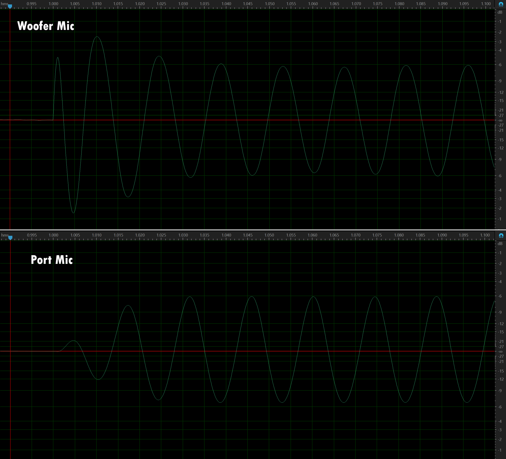

Here you are, woofer and port at tuning frequency of 70 Hz recorded with two mics simultaneously and normalised to the same steady-state level. I've also attached the files so you can look for yourself. Let me know what you see here!
My impression:
There is approx. 1 ms between the woofer and port rise off the line. The woofer and port exit are physically separated by about 20 cm. This is clearly not a delay equal to 180 degrees at 70 Hz, which would be closer to 14 ms. The propagation of sound over 20 cm however would only be about 0.6 ms, so there is a small delay I can not account for there.
It is true the port takes a few cycles to build up. This is clearly seen in the woofer amplitude being higher on the first cycle and then reducing as as the port builds up.
I think, we can say the combined response is minimum-phase and the system phase is simply linked to the frequency response. This does not change the fact the woofer will have to work harder on the first few cycles of any waveform until the port resonance is established. Of course, it would need to work harder all the time, without a port. I don't really see any 'time smearing' that would not also be caused by EQ'ing a sealed system.
What do you all think?

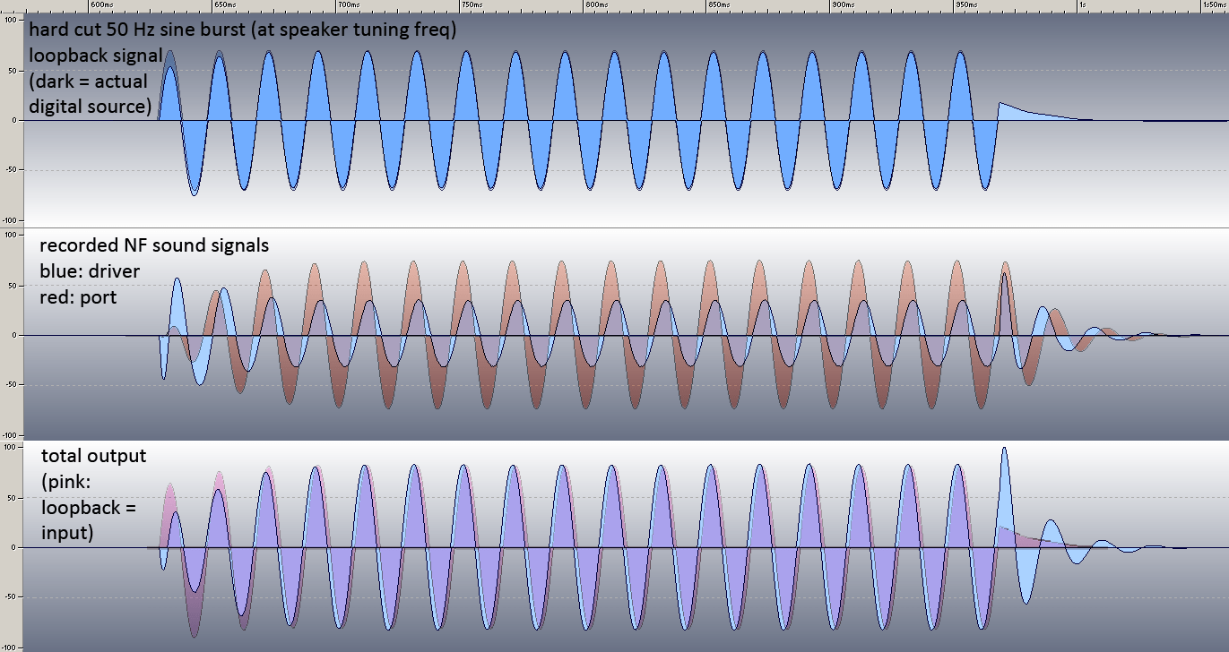

well ... I was just doing something very similar!Here you are, woofer and port at tuning frequency of 70 Hz recorded with two mics simultaneously and normalised to the same steady-state level.

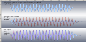

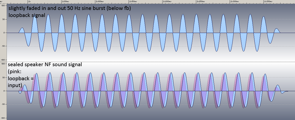

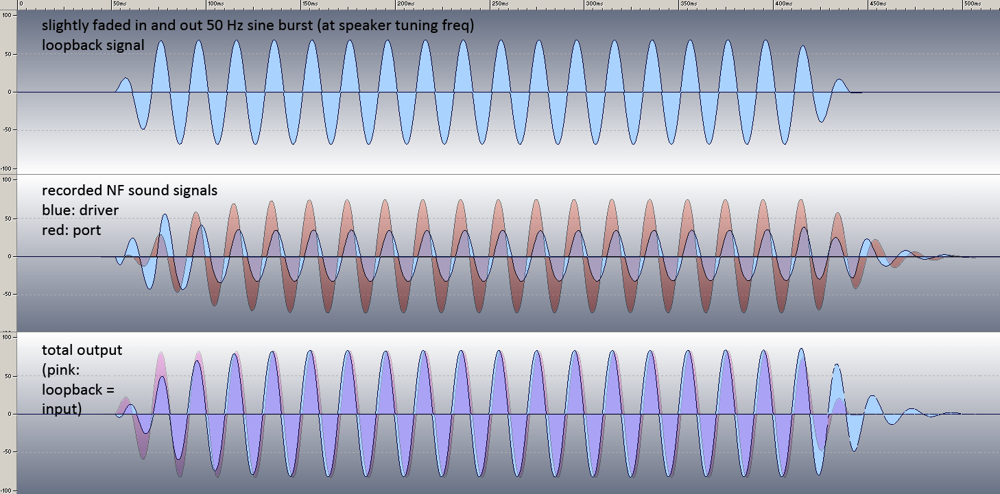

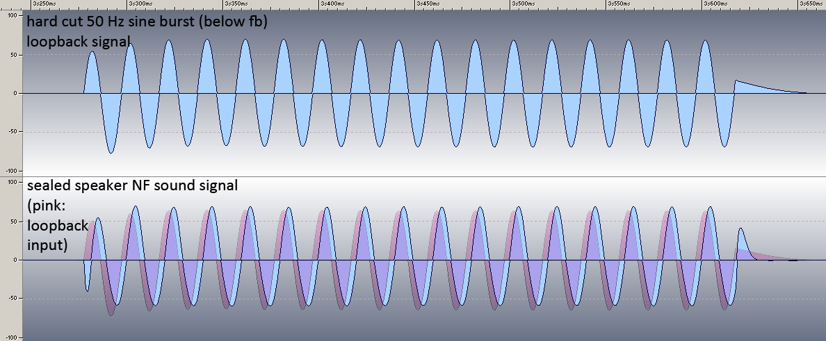

here are my graphs, recorded with my current investigation loudspeaker, as shown here.
I used two sine burst signals at 50 Hz (bass reflex tuning frequency of my speaker), one with short fade-in and fade out cycles and one with hard start and stop (of course this includes high frequency contents, but the midwoofer has quite some frequency extension).
bass reflex measurement with faded-in and out 50 Hz sine burst:
bass reflex with hard cut sine burst. I put the original source signal as overlay at the top graph. the slight differences come from AC couling by input caps, I presume.

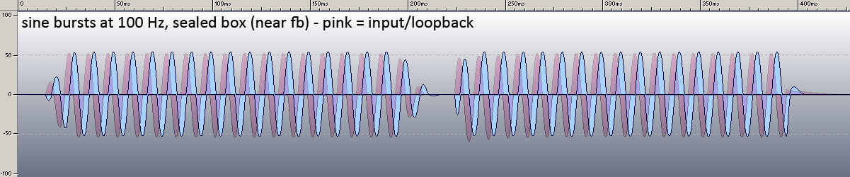

for comparison, the same speaker, but sealed (fb is around 100 Hz, so this is one octave below fb), again faded and hard-cut versions:
and finally, sealed speaker roughly at tuning frequency (100 Hz):
as can also be seen in @Tenson's graph, during the first cycle of bass reflex speakers the driver has an increased excursion, because the resonator does not yet provide the counteracting air pressure.
I also observed something similar with my test bandpass enclosure, see here.
apparently the well known excursion limiting effect of resonator enclosures cannot protect a driver from transient high excursions.
this, in combination with air turbulence noise might be one of the reasons many people dislike bass reflex systems, even if the increased group delay cannot be heard.
please note that the driver and port of the recorded speaker are quite near eachother. so the signal separation port/driver is not at all perfect.
