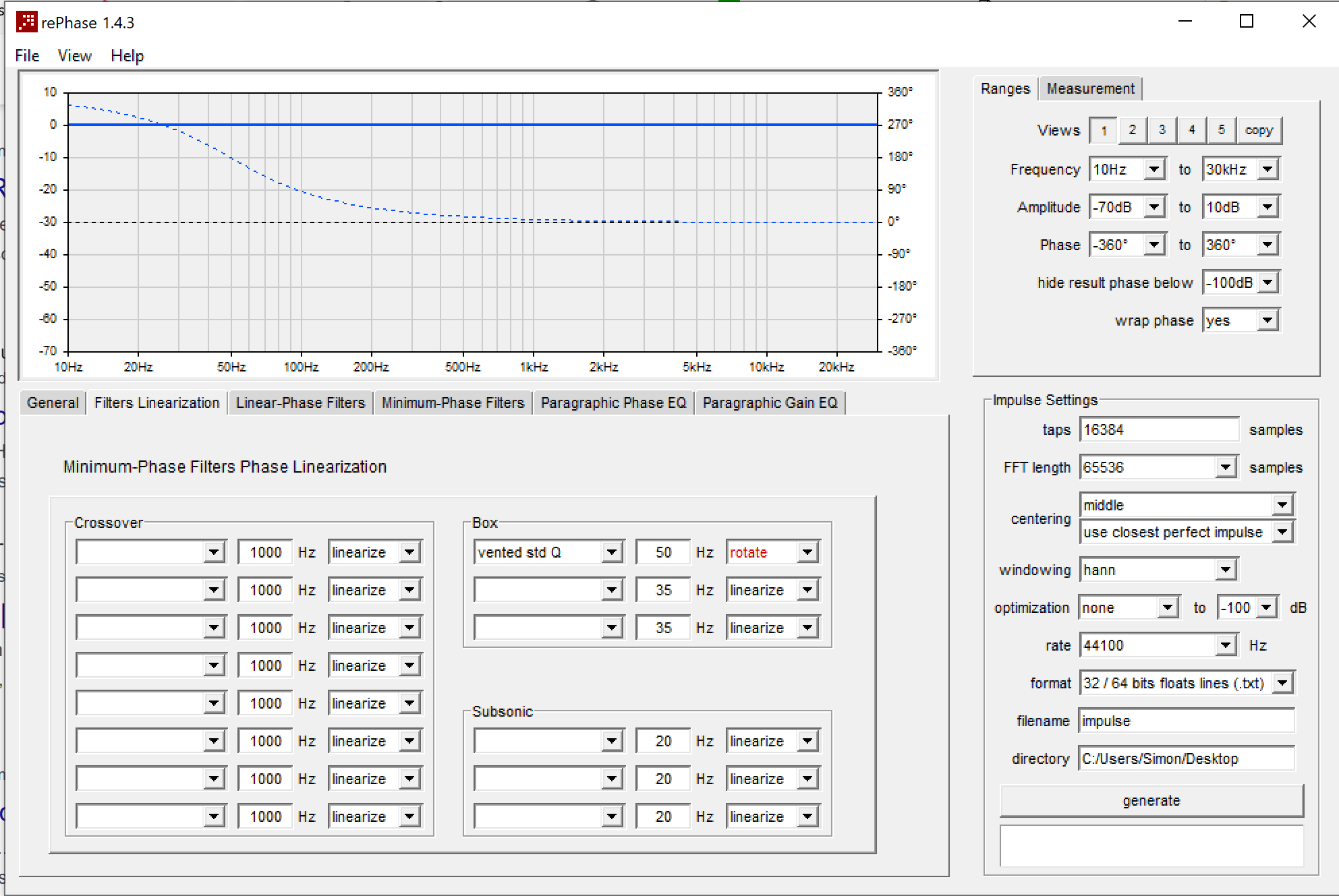

The entire system (driver, cabinet, port, box) in the bass is minimum phase, isn't it? It's easy to test audibility, if you have headphones and software (Equalizer APO, Foobar) to run an FIR filter on file playback. Simply generate the group delay linearization filter in RePhase in 'rotate' mode (inverted phase) and listen back to music.

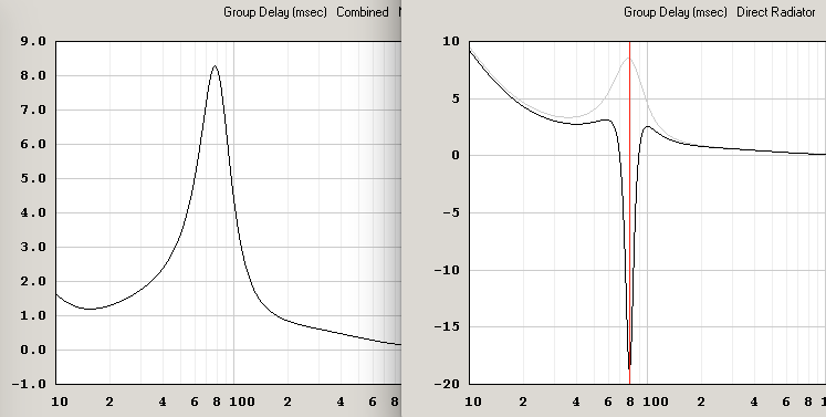

Ported speakers crush the first cycle of any plucked bass note that requires the port to produce it. On the first cycle of a bass note, there is effectively zero output from the port. So look at that frequency response graph and see where the woofer is down 6 dB without the port. That's what you get from the speaker until the port resonator gets pumped up to full output over a few cycles. All those nice frequency response graphs are the steady state infinite time response. So instead of getting that whack of the first cycle of the decaying exponential of a bass drum or bass guitar, you get a three cycles of smooth increase and then a delayed exponential decay. There are some nice LTSpice models of ported speakers where you can graph the transient response of the port and woofer to see the effect.

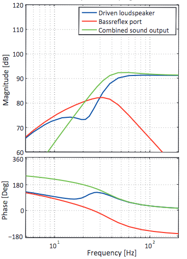

When looked at as an entire system, the bass reflex response may be considered minimum phase, but combined group delay alone does not characterize the separate arrival times of the driver and port output.The entire system (driver, cabinet, port, box) in the bass is minimum phase, isn't it? It's easy to test audibility, if you have headphones and software (Equalizer APO, Foobar) to run an FIR filter on file playback. Simply generate the group delay linearization filter in RePhase in 'rotate' mode (inverted phase) and listen back to music.
The compliance, or ”springiness" of the air inside the enclosure reacts with the air mass in the port in a similar manner as the air in a bottle resonates when a current of air is directed across the opening, exciting it’s Helmholtz resonance.
The Fb (frequency of box tuning) at which the box/port system resonates, is determined by the effective length and cross sectional area of the duct, the volume of the “air spring” in the enclosure, and the speed of sound in air.
Above Fb, the back wave of the bass driver’s sound emission through the port is delayed by the “air spring” and inverted in polarity.
Since the driver’s back wave is in opposite polarity with the front wave, this inversion brings the two emissions in phase, although the vent output lags by one wave period.
The “in phase” combination of the delayed port output and the driver’s front wave constructively reinforce each other. The constructive reinforcement produces higher output for a given driver excursion compared to a closed box, or a similar output with less excursion around Fb, which reduces driver distortion around Fb.
The drawback of the resonant reinforcement is time smearing, the vent output augments the driver’s output by adding a "resonant tail" to it.
At Fb, the port’s output is 90 degrees behind the driver’s front radiation, at frequencies below Fb, the vent polarity inversion reverts to 180 degrees, and the out of phase back wave cancels the front, reducing combined output at around 24dB per octave. Below Fb, the driver behaves as though in free air.
