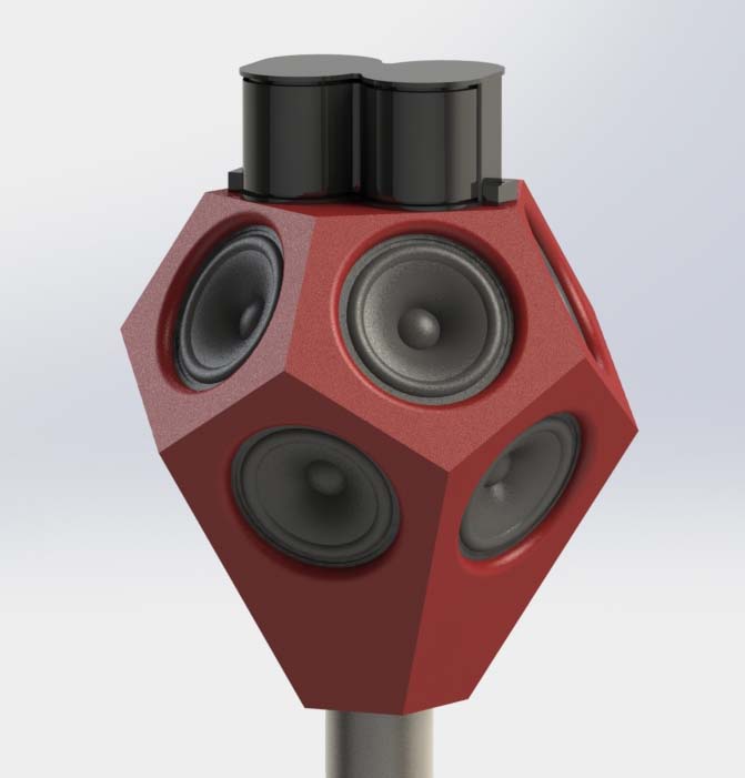

I'm thinking of knocking together a pair of these
An interesting take on the docecahedron. Not for the faint of heart woodworker.

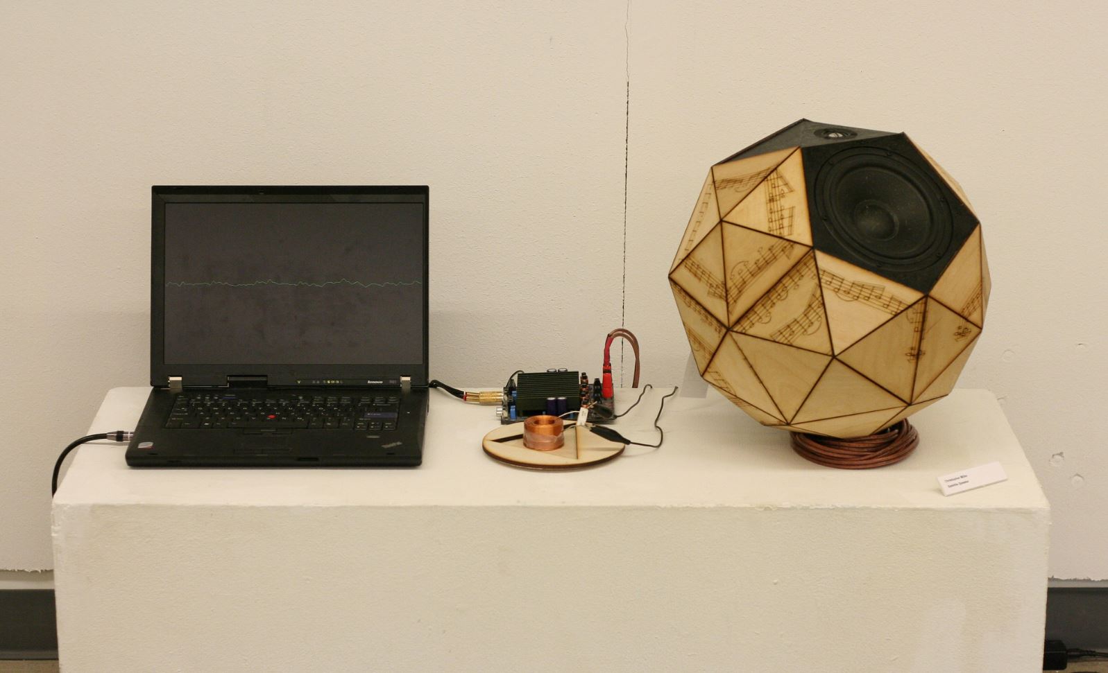

Speaking of dodecahedron, here's a little project I did:

I like your dodecahedron...*S* I'm a woodbutcher, and I haven't tried one of those. Contrasted to the MBL101's, it's as close to the 'pulsating sphere' as one can get, short of a plasma source. And we all know the side effects of those...I still like to be able to breathe while listening...*L*

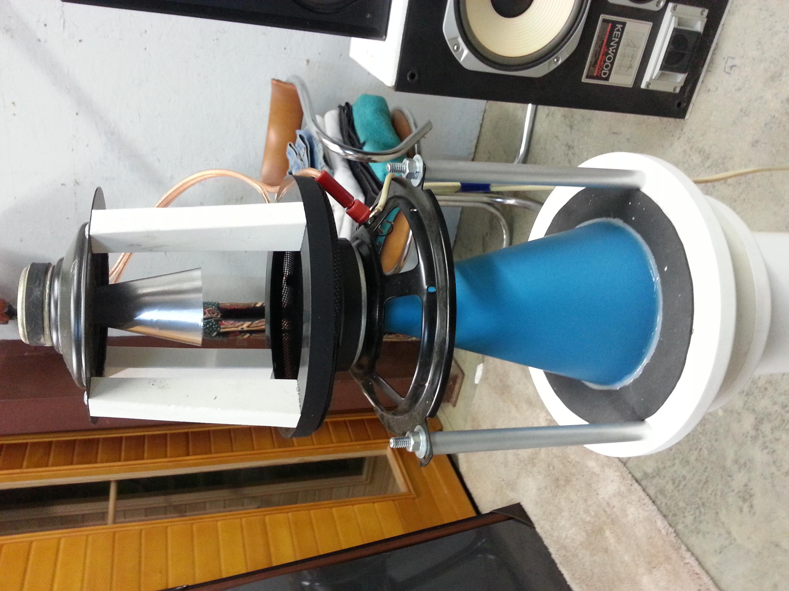

Here's a closer look of the 'fronts', BTB. I'm playing with a '2-way' config; a variant of the Infinity 'ice cream cone' tweeter. Smaller voice coil allows for a smaller cone apex for high extension, giving it a little more 'air'. The back pair is running small dome tweets, similar to the Ohms. OK, but...not the same....ultimately directional, just like the Ohms...

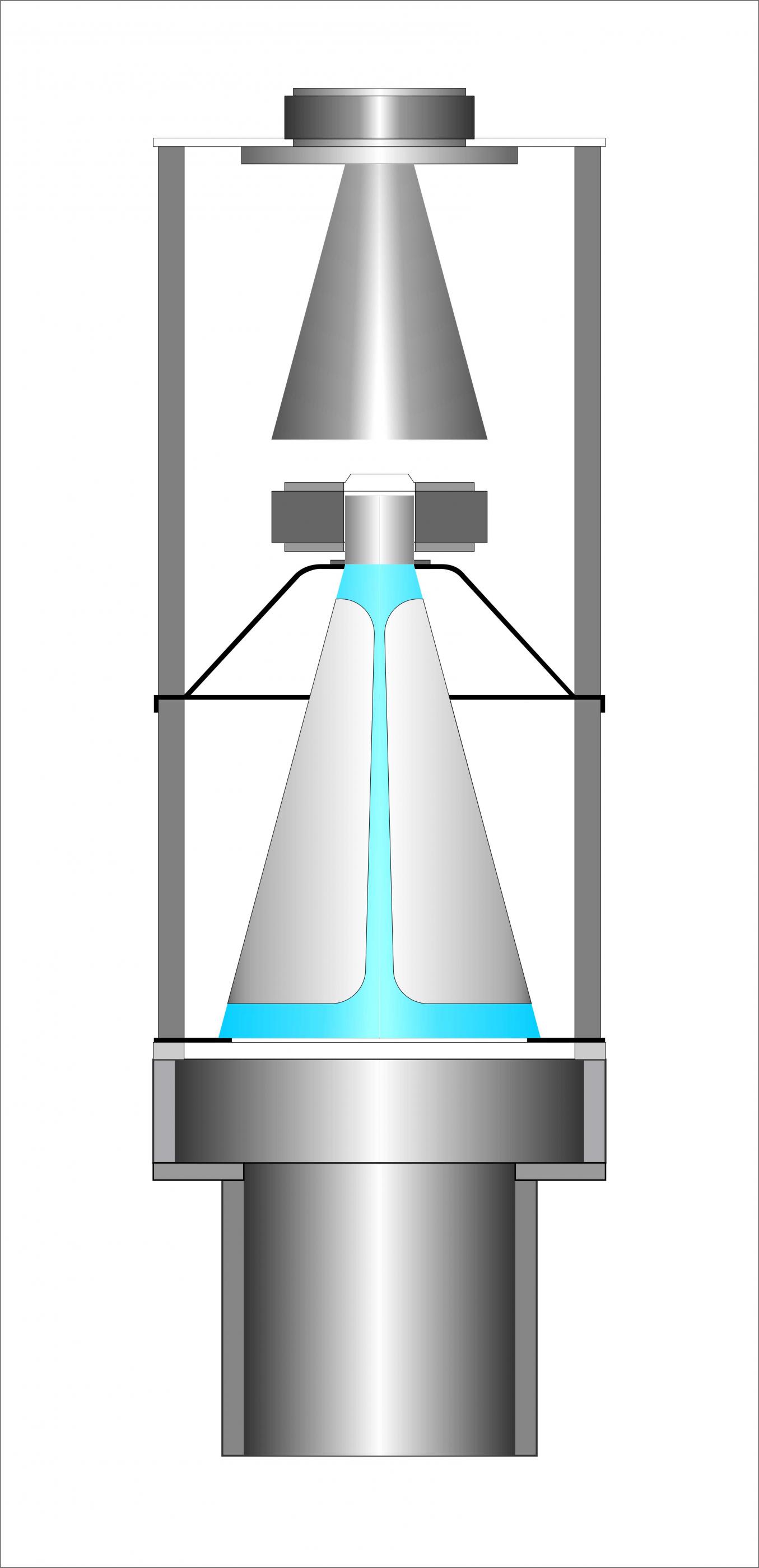

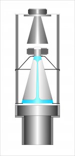

BTB....here's V.4, conceptually.
Better drivers, a 'windowed' cone (5mil with 2mil 'windows'; 5 for strength, 2 for reproduction), tighter tolerances, an improved surround for the cone's base.
Set up for bi-amp...I've got a digital xover (Behringer) that's more than capable and will allow for 'dialing it in'....
Yeah, I know there's carbon fiber and titanium. But I'm cheap. *L*
