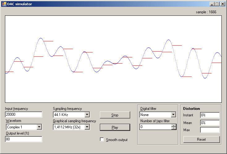

To easily understand digital filter I'm making a DAC simulator where I can adjust many parameters. On the picture, blue dot are input signal, red points are real points digital filter output, green curve is hypothetic low pass filtered output signal.
Eric

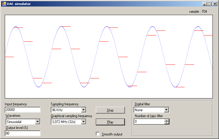

As say SY and error401, with only 88.1KHz or 96KHz sampling frequency you don't need interpolation.
Eric

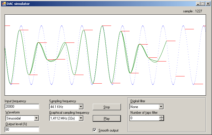

that graph in post25 has striking similarities to the 20kHz graph in post17.
Who is going to shout down two bits of software that suggest the sampling of simple sinusoids is very difficult when the sampling rate is slightly more than two times the frequency.
How bad can it get when there is a varying frequency?
What happens when two frequencies are present in the signal?
What if both those frequencies vary in amplitude?

That graph in post25 has striking similarities to the 20kHz graph in post17.
Yes

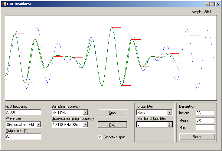

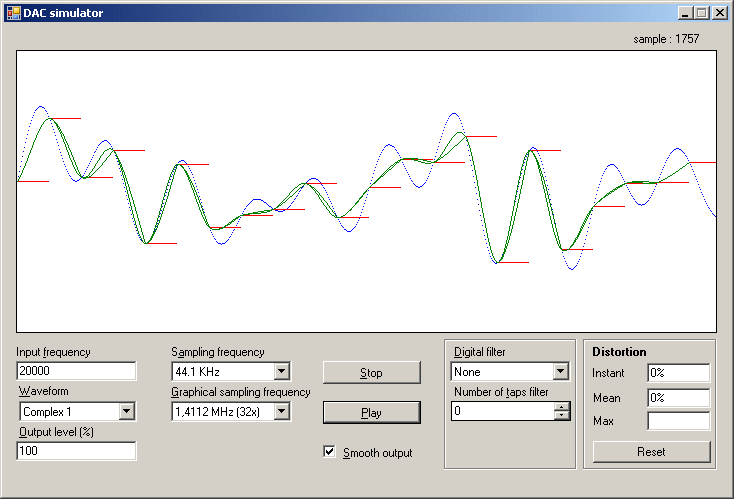

I make my software simulator to see what append on theses situations. (see attached sample picture)

Technology is ready an standard exist since DVD exist! DVD-A standard 96K 24bit and 192K 24bit exist since DVD Video exist. There is only few disc available. More disc on SACD (DSD) format are available, certainly because it is more difficult to copy.
I don't think that we really need 192K, 96K seem to be enough (It is a personal point of view).
Eric Juaneda said:
I make my software simulator to see what append on these situations. (see attached sample picture)
can you add the green plot showing the filtered output?
Can you simulate one of the frequencies with varying amplitude?
