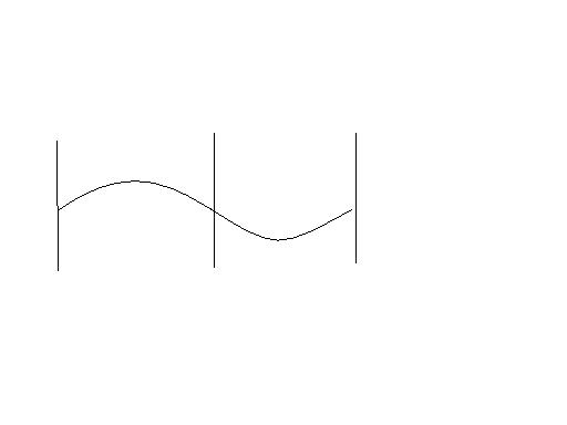

If this sine (f=fs/2) is sampled in the given phase (see slashes) you get nothing. If it is sampled 90° shifted you get the full amplitude in the right phase. For any other phase you get neither the correct phase nor the correct amplitude.
I`m no expert, correct me if I`m wrong.
This sine has a frequency of exactly fs/2. Nyquist-Shannon states that the signal bandwidth must be below fs/2 for exact reproduction.
It's not the most intuitive theorem, but the fundamental idea is that for a signal bandwidth under fs/2, there is only one possible interpolation between two samples. If the input signal is bandlimited to a bandwidth of less than fs/2, that means that the entire signal can be exactly reproduced, since the interpolated signal exactly defines the input signal.

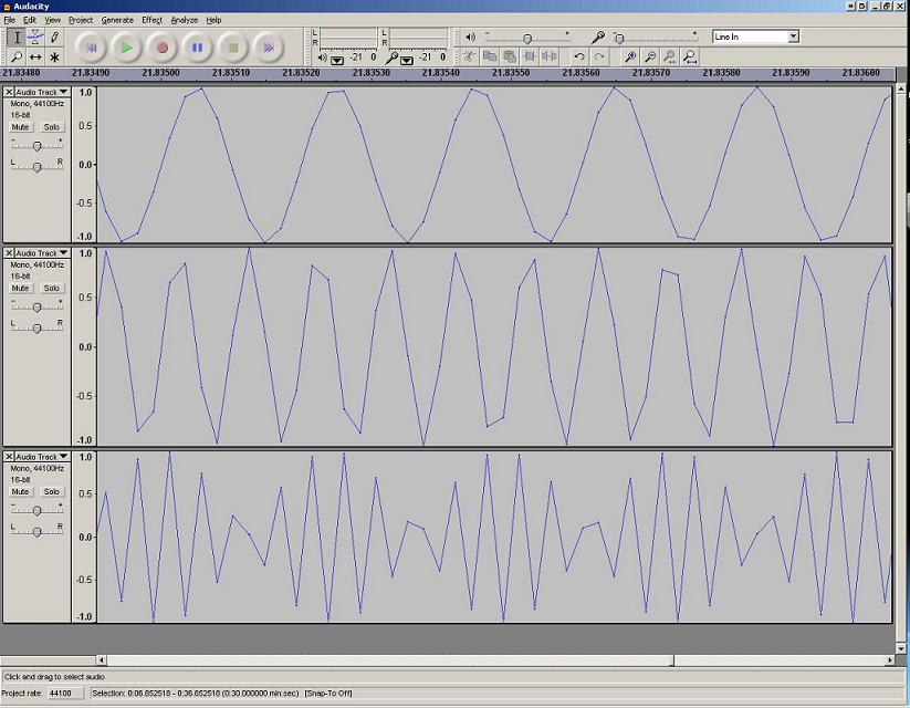

Here are some sines I made with audacity. Admittedly its just done 'join the dots'.
First is 5k, then 10k and finally 20k. ie not nice fractions of 44.1k.
Nyquist works if you're trying to fit a single sine wave to the data points. Not something you do in real life.
It works, period (bad pun). Anything with a frequency sufficiently close to the Nyquist frequency will be a sine wave once it's passed through a low pass filter since the harmonics fall above the Nyquist frequency. Multiple sine waves of varying phases near the Nyquist fequency are no problem and no exception to the theorem.
A really good reference is Mischa Schwartz's superb "Information Transmission, Modulation, and Noise" which covers this stuff thoroughly and rigorously in Chapter 2.
BTW, your plots do not take into account the second requirement: anti-imaging on the output.
