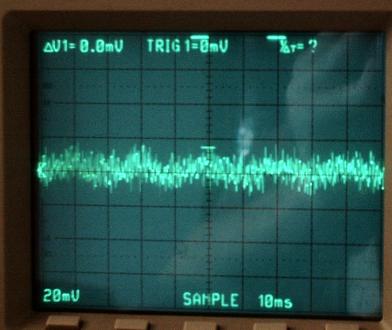

1 set the scope in GND mode - noise hum?
2 Short the input like SY has done - hum
3 Connect the probe and set it in GND if the probe has that switch - hum
4 Take a wire and short the probe tip - hum
5 Switch off your lamps and other stuff (PC's etc) - hum
Do you get my idea? You must rule out things
peranders said:1 set the scope in GND mode - noise hum?
1: done, no hum
2: done, no hum
3: no GND switch on the probe
4: look at posts 11 and 12
5: the scope in in the same room as a computer, the room aside is the kitchen with the frige running. I'll try to switch them off later in the afternoon. I have to go now.

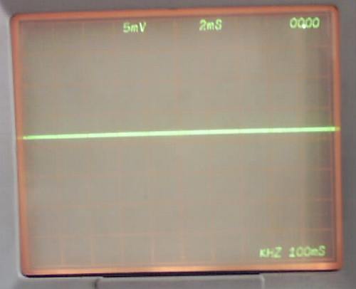

DRC said:Interesting difference between the two probes, Bricolo. Do both probes look OK on a calibration signal ? Seems to be something strange about your probes ...
By comparison I see more noise on my analogue scope, but only on a 10uV or 20uV / div setting !!
Calibration signal is ok (no ringing or damping) on the 2 probes, even if there's some small HF on it
I just checked with grounded probes on my 25+ year old 15MHz
Iwatsu scope. With 1x probe I get approx 200uV pp noise and
with 10x probe I get 2mV pp. That is I get the same scale
reading in both cases, so it is clearly the internal noise floor
of my scope. Maybe you have a noisier environment?

how?
just with an ohm meter?
Sure. I was thinking if the shield is not grounded it will not be so effective.
dave
dave
both have 0.7 Ohm on the DMM (the DMM shows 0.7 Ohm when I connect its wires)
That's probably just the contact resistance of the DMM probes,
so the shield should be OK.
Have you tried a shorted BNC directly at the scope as
someone suggested?
someone suggested?
done (post 17)
Bricolo said:
done (post 17)

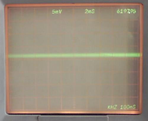

OK, I missed that. Seems to be the small ground lead picking
up some background noise then. Try to switch off all electric
stuff you can, especially the computer. Also try in the middle
of the night or very early morning, when the electric background
noise is usually at its lowest.
Hmmmmm...
