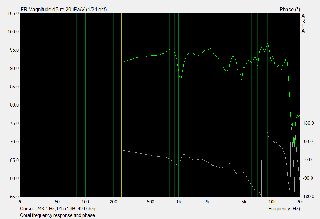

Don't take my word for it, take some measurements of your own.
Measure any random conventional single cone driver you have sitting around (woofer, mid, full range, doesn't matter) that has known cone breakup resonances, even severe ones.
Have a look at the excess phase and excess group delay, and compare them to phase and group delay. What do you see ?
I've done this on many drivers, and I haven't found one yet where the resonances aren't completely minimum phase. Yes even on a whizzer cone full range driver, surprisingly.
On a single cone driver what I invariably find is that within a small margin of error there is no excess phase and the excess group delay response is a flat line which only curves up a bit at the bottom end due to limited gate time of the measurement causing errors in the low frequency phase estimation.
If you look at group delay you see the group delay variations at cone resonances that result from the rapid phase shifts but excess group delay is a near flat line with no trace of any of the resonances.
On a dual cone whizzer cone driver what you do see is some excess group delay and phase - but not at the cone resonances - just a very smooth, broad shift that looks not surprisingly like the excess group delay of a two way speaker with a 12dB/oct crossover.
Here is an example for you, and I've actually taken the more challenging example of a large dual cone full range driver to show that even in this situation the cone resonances are still minimum phase despite the extremely high modal density that must be present on the cone at high frequencies for an 8" driver... First the amplitude and (measured) phase response.
attachment.php
Plenty of peaks and dips there - must be resonances right ?

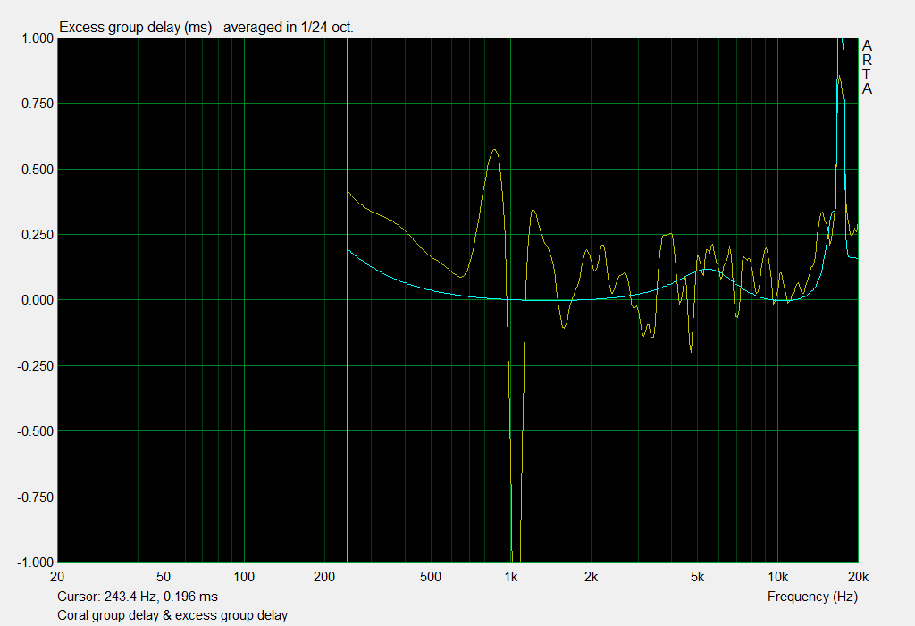

Here is the group delay (yellow) overlaid on top of the excess group delay: (blue)
attachment.php
I think this is very cool - in the group delay you can clearly see the group delay reflecting the resonances shown in the amplitude and phase response - the surround dip at 1Khz is especially obvious, but in the excess group delay (which is just group delay of excess phase) there is absolutely zero trace of any of these resonances at all. I think that's quite profound and it certainly shocked me when I first discovered this years ago.
All you see is a gradual hump at around 6Khz which is a result of the fact that the two cones have an mechanical/acoustic crossover at about 6Khz, so like any other crossover you see a peak in the excess group delay near the crossover frequency.
(This excess group delay measurement is in fact how I know what the crossover frequency between the two cones is, and this could be used to measure the acoustic/mechanical crossover frequency of any whizzer cone driver...and incidently, its interesting to note that the excess group delay minimum at 10Khz exactly matches the excess group delay minimum near 1Khz - which shows that the two cones are properly time aligned - which is not the case on some dual cone drivers I have measured)
If I were to repeat this same measurement on a single cone driver (which I have) you'd find the excess group delay is basically flat through the majority of the drivers bandwidth, with it just curving up at both ends due to measurement error. I used the dual cone driver as an example as otherwise I'd just have a boring, flat line...
So at least in this measurement there is proof that all the cone resonances are minimum phase as they don't show up even slightly in the excess group delay response. Which also means that even though the driver as a whole is not minimum phase, because the resonances are they can still be corrected by standard individual minimum phase PEQ or RLC notches, as I'm doing in my crossover.
Of course - I'm not suggesting that all drivers are minimum phase - clearly there are some that are not - like the one I just posted above. And you should always measure it to find out if it is the case or not.
But I'd say in the majority cases, the resonances of all cone drivers are minimum phase. I'm yet to find an exception to that rule, and on the face of it that does seem surprising, but the measurements are hard to dispute.
I can see why people consider drivers minimum phase, simply because acoustics summation part in the measurements are considered part of the DUT. If we consider only up to the point of cone movement, then we actually see a single input multiple output system. This is why I would rather not consider trying to categorize normal measurements, but rather look at the result and see how to make the cone move in a more uniform manner. I think it would be interesting to use the Klippel scanner to visualize how the cone is flexing when using FIR filter to linearize phase and reduce CSD decay time.
