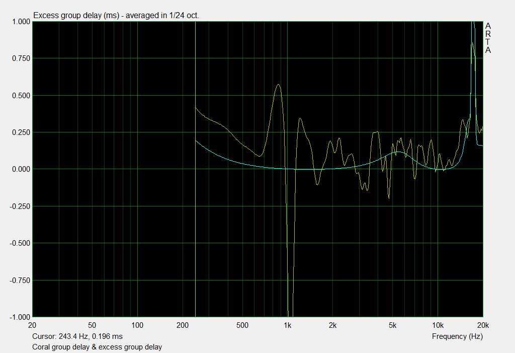

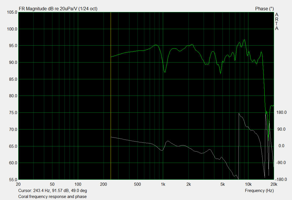

Here is an example for you, and I've actually taken the more challenging example of a large dual cone full range driver to show that even in this situation the cone resonances are still minimum phase despite the extremely high modal density that must be present on the cone at high frequencies for an 8" driver... First the amplitude and (measured) phase response.
attachment.php
Plenty of peaks and dips there - must be resonances right ?
Here is the group delay (yellow) overlaid on top of the excess group delay: (blue)
attachment.php
I think this is very cool - in the group delay you can clearly see the group delay reflecting the resonances shown in the amplitude and phase response - the surround dip at 1Khz is especially obvious, but in the excess group delay (which is just group delay of excess phase) there is absolutely zero trace of any of these resonances at all. I think that's quite profound and it certainly shocked me when I first discovered this years ago.
All you see is a gradual hump at around 6Khz which is a result of the fact that the two cones have an mechanical/acoustic crossover at about 6Khz, so like any other crossover you see a peak in the excess group delay near the crossover frequency.
(This excess group delay measurement is in fact how I know what the crossover frequency between the two cones is, and this could be used to measure the acoustic/mechanical crossover frequency of any whizzer cone driver...and incidently, its interesting to note that the excess group delay minimum at 10Khz exactly matches the excess group delay minimum near 1Khz - which shows that the two cones are properly time aligned - which is not the case on some dual cone drivers I have measured)
If I were to repeat this same measurement on a single cone driver (which I have) you'd find the excess group delay is basically flat through the majority of the drivers bandwidth, with it just curving up at both ends due to measurement error. I used the dual cone driver as an example as otherwise I'd just have a boring, flat line...
So at least in this measurement there is proof that all the cone resonances are minimum phase as they don't show up even slightly in the excess group delay response. Which also means that even though the driver as a whole is not minimum phase, because the resonances are they can still be corrected by standard individual minimum phase PEQ or RLC notches, as I'm doing in my crossover.
Under some studies, it is possible to assume minimum phase, but in the process of perfecting a device, one cannot assume such, but rather best look at the actual physical dynamics which is where the Klippel scanner is very useful.
Of course - I'm not suggesting that all drivers are minimum phase - clearly there are some that are not - like the one I just posted above. And you should always measure it to find out if it is the case or not.
But I'd say in the majority cases, the resonances of all cone drivers are minimum phase. I'm yet to find an exception to that rule, and on the face of it that does seem surprising, but the measurements are hard to dispute.
