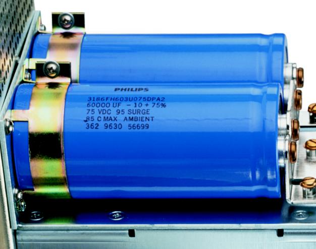

With regards to capacitor specifications,
I always read use "low ESR", "high ripple current" but no one ever quantifies that.
What is "low ESR" and what is not "low ESR", same with "ripple current".
Let's assume (cause this is what I am doing), a PS with a 300VA dual 36v toroidal feeding a 100 watt mono AB amp using four 10,000uf caps at 63v.

What would be considered good ESR and ripple current?
What would be bad ESR and ripple current?

The high speed decoupling should always be on the amp pcb(s) where its actually needed for stability anyway, there is no requirement for "speed" per se from bulk PSU caps, but you do want the ESR to be low enough for the load current involved (and this applies equally to the decoupling on the amp board which will typically handle the higher frequency current anyway).
Here's some good reading material from someone who really knows their stuff: Capacitor Characteristics
