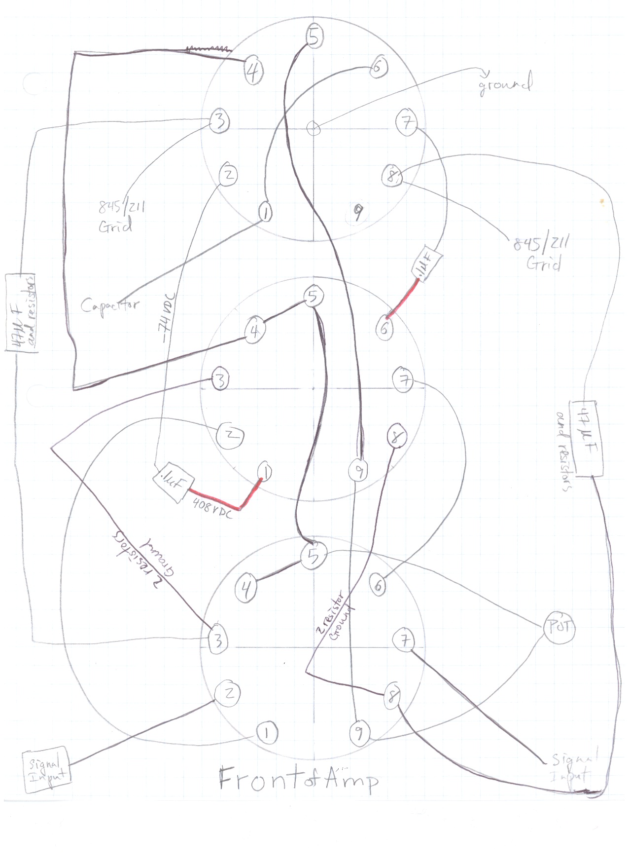

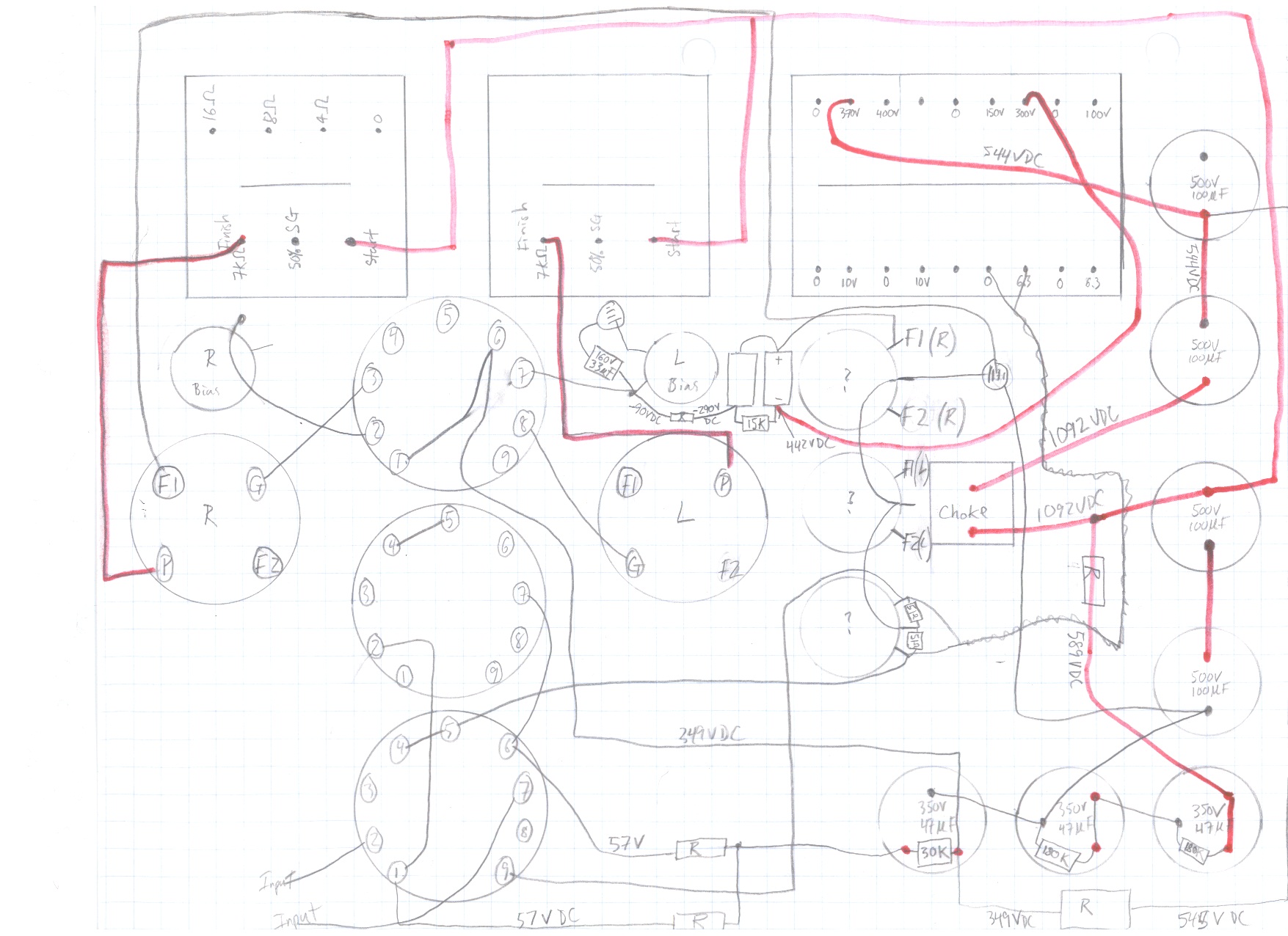

The grid voltage of the other side (Left) is -45 VDC with bias all the way up. This wouldn't work with the 211 at 1100 plate voltage. I don't think the 6CG7 is the right driver tube. Please help me figure out what driver tubes to use. I am working on the drawing, will post it asap.

I am drawing a more detail layout of the entire amp.
-45 VDC is too low for a 211 and way too low (dangerous) for a 845. Both tubes will be underbiased (= too much plate current) @ 1.1Kv plate voltage. For a 211 and with the correct driver tube in place a good target would be -60 VDC with the bias pot in midway position and about 20 VDC range above and below this reference (mid)point. Any positive bias value is suspect (wrong tube) as the designer of the circuit probably never allowed the bias adjustment for going into the positive region which is harmful for the tubes and surrounding circuits. Looks like the 6CG7 is not the original tube...
A detailed drawing of the circuit would be very useful...

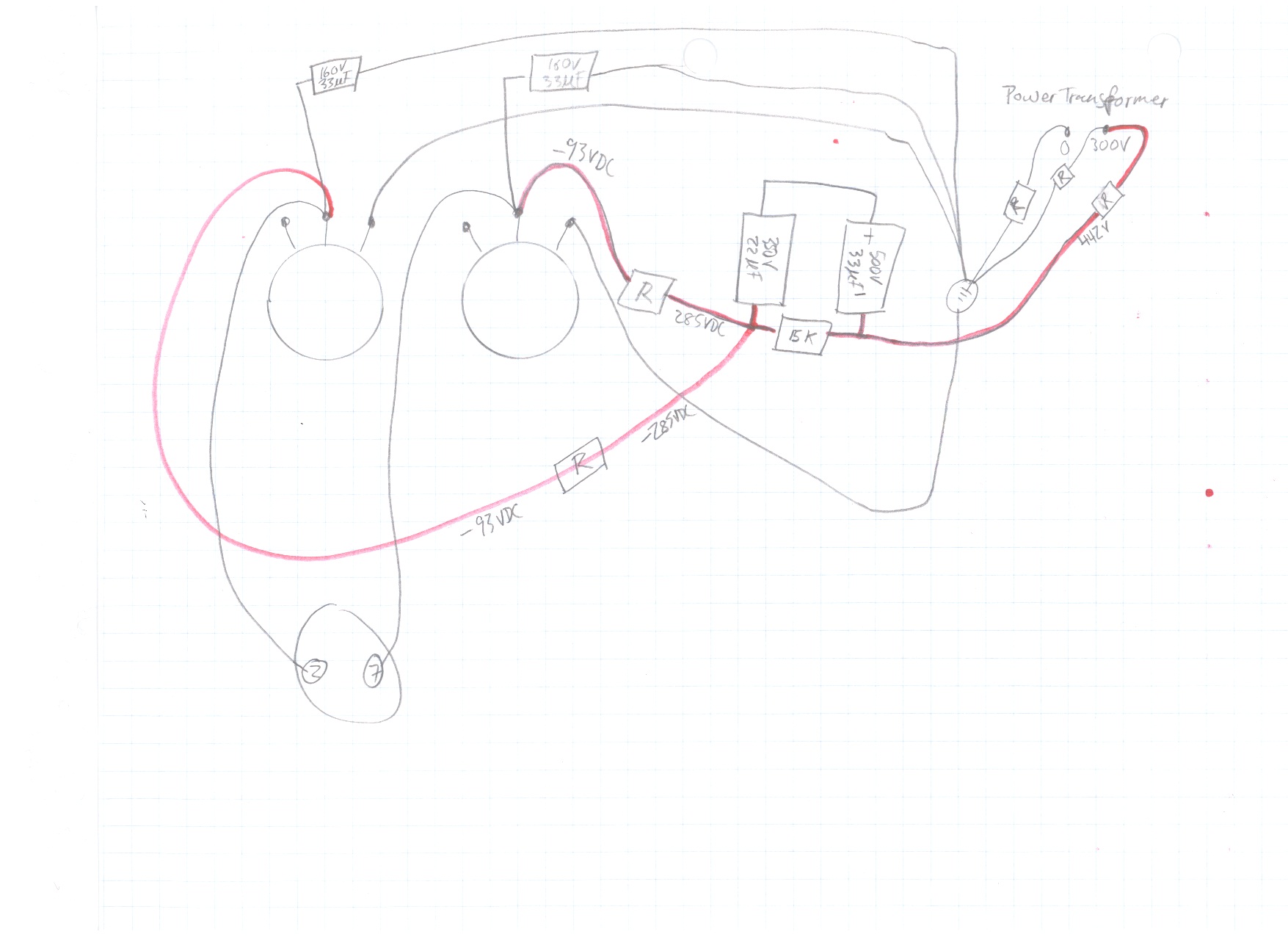

I am working on it.
Here is how the grid voltage is affected by the driver tubes:
- without any tubes, grid voltage is -392 VDC, unaffected by bias adjustment.
- with just the back tube 6CG7 (the tube that has the grid wire connected), grid voltage is +50 VDC at highest bias setting.
- with back tube 6CG7 + middle and/or front 12AU7 tubes, grid voltage is -55 VDC.
- with just middle and/or front 12AU7 tubes, grid voltage is -392 VDC.
The 6CG7 is changing the bias from -73 VDC coming in from the bias pot to +50 VDC going to the power tube grid. This is done without the other two driver tubes.

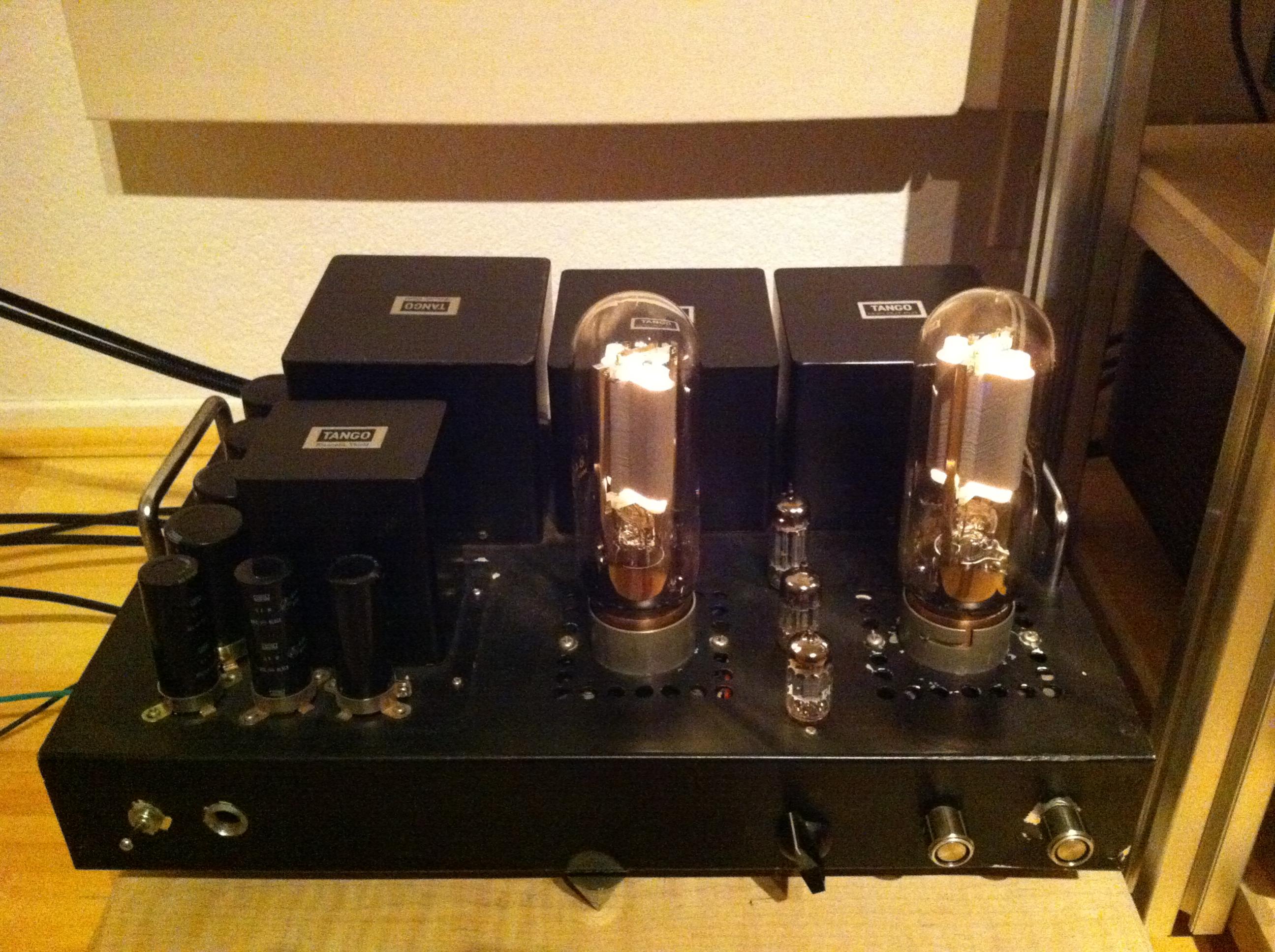

I got the amp working using the 845 tube.
I modified the grid voltage by changing the resistors. I got the Shuguang 845B running at about 70mA. The plate voltage is 1098 VDC and grid at -160 VDC
It is working great with 6CG7 in the back and 12AU7 in the middle and front sockets.
Thank you all for the help.
