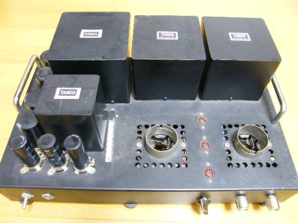

To measure the grid voltage, do I put the RED probe on the Pin 1 (Grid) and the BLACK probe on the Pin 2 (Filament)? Do I do this with the tube installed? If so, which tube should I installed? I do notice that the 211 and 845 have very different DC grid voltage, 211 is -61V and 845 is -145V at 1000V plate voltage.

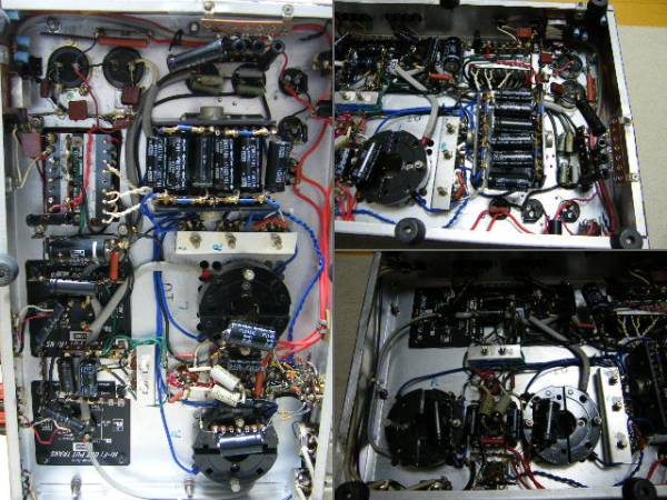

Put the black probe on the chassis ground and measure the grid voltage without the tubes. Don't try measuring the plate voltage. Most digital meters top out at 1KV and unloaded the supply will read much higher. Judging by the pics the amp looks homemade but well built. If the bias has enough range then you could run either tube depending on the transformer impedance.
