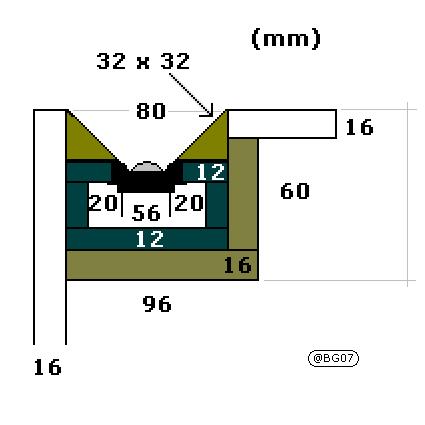

Bjorno:
I think your wave guide is ingenious. It looks great and allows crossover as low as 1300 Hz!
You reference the Dayton ND20TB-4 that is no longer available. Is the Dayton ND20FB-4 the same or similar to the “TB” model you used? http://www.partsexpress.com/pe/pshowdetl.cfm?&Partnumber=275-035
I cannot make out how you mounted the tweeters to your wooden wave guide.
Are they attached with screws?
What diameter hole did you use for the tweeter to stick through? My eyes are no longer good enough to see what the 20mm dimension in your drawing refers to. It makes it more difficult since I can’t find a dimensioned drawing of the ND20TB.
My eyes are good enough to see you have very little wood left between the tweeter holes. You must have a good drill press and steady hands. What center to center dimension were you able to achieve? Did the tight spacing require you to modify the ND20’s mounting plate?
I recall seeing another picture of this array in a horizontal center channel array with vented mid drivers mounted below the tweeter array. I also think I recall reading that you made the tweeter array so the angle could be adjusted. How did it turn out for actual listening? Did you use the adjustment feature to fine tune the array direction? What is your impression of the ND20 tweeter for a line array?
Very nice work!

Hi redi,
… Bjorno:I think your wave guide is ingenious.
Is the Dayton ND20FB-4 the same or similar to the “TB” model you used?…
http://www.partsexpress.com/pe/psho...tnumber=275-035
Thank You redi for your appreciation of the looks.
I have compared data and all the available numbers for both T drivers and found that they are exactly equal; only one letter difference doesn’t make a physical or performance difference at all.
Concerning the 1300Hz I must emphasise that it is a possible acoustical crossover point but its below fs = 1.7kHz where the phase makes a jump.
I think it’s better to crossover at or best just above this resonance peak for easy crossover integration reasons.
…I cannot make out how you mounted the tweeters to your wooden wave guide.
Are they attached with screws?…
Yes and from the rear side of the array.
…What diameter hole did you use for the tweeter to stick through?…
The wood thickness (mounting depth) is 12 mm (MDF)(actually exact ½”) = the height of the cylinder and the diameter of the hole, the cylinder diameter is 36 mm.
The c-c distance is 39 mm leaving a wood thickness between the holes of 3 mm, the square bottom plate (39x39x2 mm) is the guide for how close the T drivers can be mounted and if 1.5 mm on the sides is cut away (I didn’t), the minimum c-c will exactly be 36 mm.
…My eyes are no longer good enough to see what the 20mm dimension in your drawing refers to.
It makes it more difficult since I can’t find a dimensioned drawing of the ND20TB…
I regret the dim picture and sorry, I never made proper drawings, as this project was a special design for a friend.
The 20 mm is misplaced and is actually the clearance height shown = about 13 mm for the soldering lugs + 7 mm cabling clearing behind the T drivers.
If this distance were made 13 mm, then it would be difficult to solder the wirings and route the many paralleled wires that’s needed for the array.
…You must have a good drill press and steady hands. What center to center dimension were you able to achieve?
Did the tight spacing require you to modify the ND20’s mounting plate?…
I marked up precisely the c-c positions on a 1.05m x 12mm x 80 mm piece of MDF, then I used my Dremel Moto-Tool and pre-drilled perpendicular guidance holes = 1 mm for the later use of a rotating hole saw dia 36 mm (actually an 1.5” dia, 1 mm saw blade thickness) that I shrunk to 36.0 mm by pressing a ring of soft steel wire around the saw blade.
I then drilled through half of the distance (6 mm) via both sides.

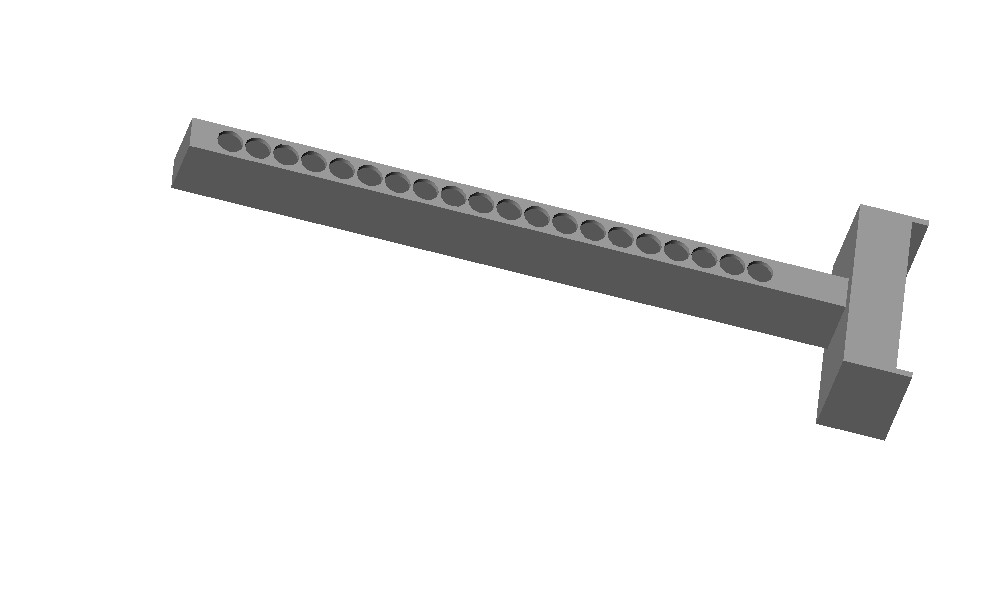

This is what stage 1 might look like!
The new thing in this plan is that the "foot" is supposed to be a sealed ~18l enclosure for an 8" Peerless SLS-213-830667 facing downwards. I might end up with a totally different shape as well, this is just one possibility.
nasty standing wave?
Will the standing wave really be a problem? The box will be stuffed with dampening wool. I was considering the 20 3" drivers being equal to one larger driver in the same volume. Since the drivers will be placed very closely together, there isn't much room for separating walls...
I was actually considering building separate tube enclosures for each driver, but stuck with the single volume enclosure idea since I was curious about what aperiodic venting might do to the lower end.

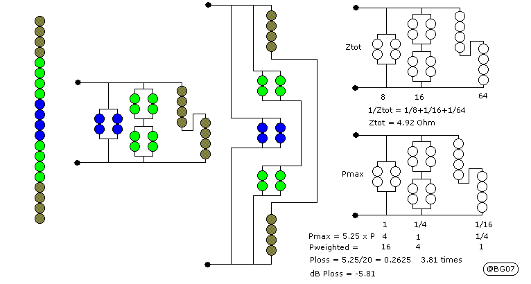

power tapering? Post #92 I'm just about to buy the boards for making the cabinets!
Will I run in to trouble using one single cabinet for all 20 drivers? I'm sure it will be fine for "straight" wiring, but what about if I want to "power taper" them?/Magnus
Hi Magnus,

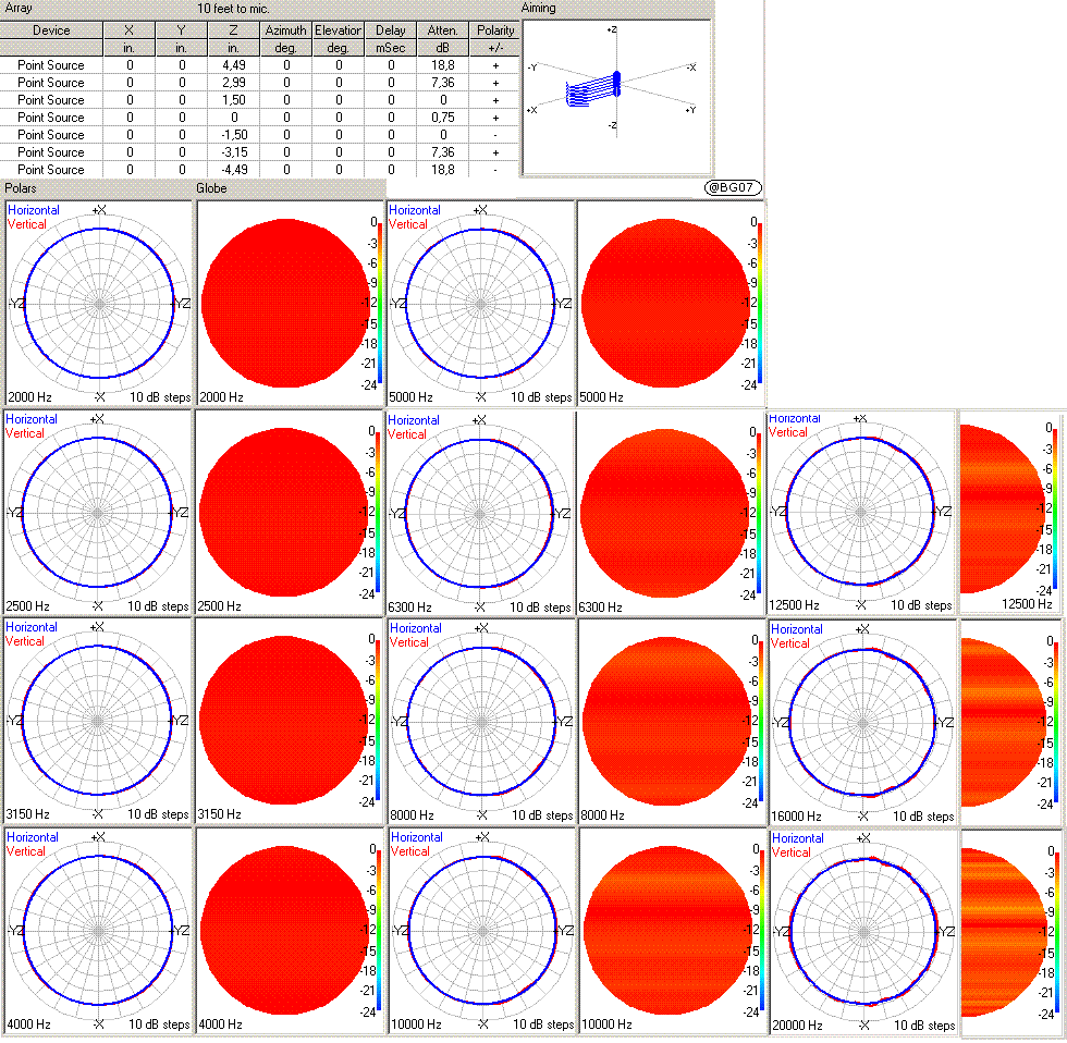

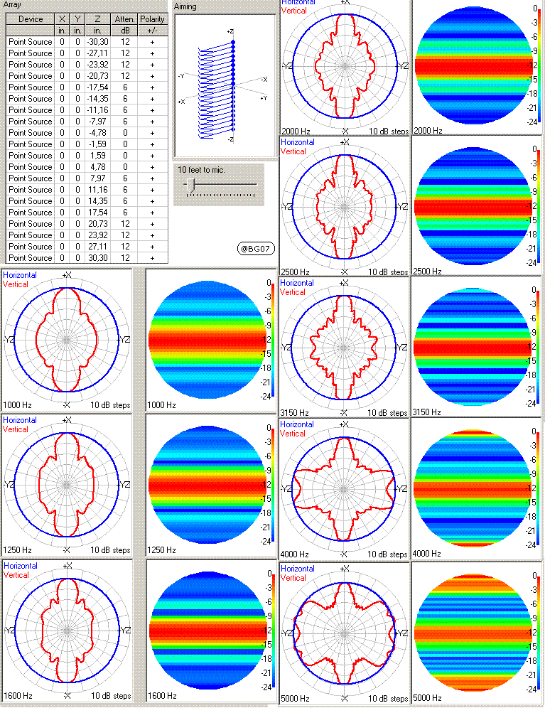

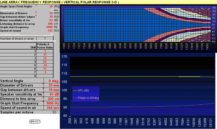

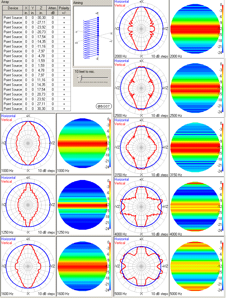

I recommend not using a single cabinet for all drivers, if you want to power taper 20 drivers, you must use separate compartments.
Power tapering with 20 drivers, see pictures 1(6) to 3(6), and my suggestion with 7 T drivers to compliment the 3” drivers; revised picture 4(6) to 6(6).
