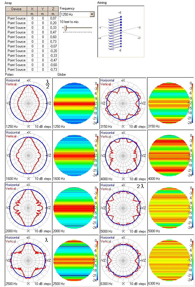

Bjorno said:
Magnus,
The first two drivers you brought up in your post #15 are members of the lowest quality scale of drivers you can find in Sweden.
The size of this driver is 13.5 cm# and you mentioned to use it up to 2580 Hz.
Using Jim Griffins paper and the rec. c-c= lambda/2 criteria for this driver you get: 344/(2x0.135) =1274 Hz to crossover to a tweeter line with ordinary 12 dB filters.
What you will gain with this set-up is some lower upper bass (160 down to 80 Hz), maybe some weak mid bass (40-80 Hz) but never the room filling low bass (20-40Hz) replacing the impression of a sub.
No simple passive filter at 2548 Hz will suffice if using the Rila 5.25” driver as W+ M driver in a Near field line array, only a 3”driver would integrate easily with a horizontally wave guided Dayton ND20FB driver.
Here is a inexpensive driver, the 3” Aura NS3 194 8E that work very well in a Nearfield line array together with the Dayton ND20:

Bjorno!
Thank you for the very detailed investigations! I'm afraid my level of skills is not quite high enough to fully understand it all, but I do think I got most of it.
The Rila speaker might very well be a poor choice, it is the very cheapest 5,25" driver I have found in Sweden.
The reason I thought about these 5,25" drivers and a 2580 Hz crossover was because on page 16 in James R. Griffin's paper, it sais that 2582 Hz is the maximum, with 130mm C-c distance, to avoid "increasing directivity" and "comb lines".
I'm not saying that anyone of you are wrong, but you seem to tell me something else, or do you mean that the crossover must be at a much lower frquency since it only falls with 12 dB/oct?

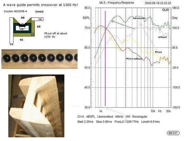

The tip about the wave guide is very interesting!

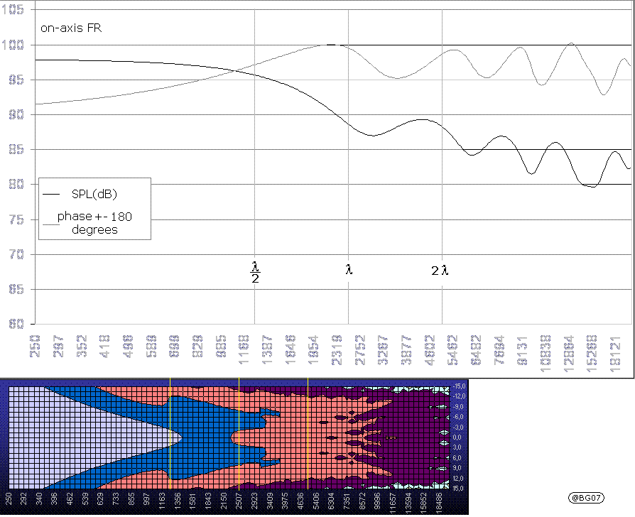

Hi Magnus,
2580 Hz is the maximum usable frequency that if used would limit further directivity because the directivity drops steeply down just above c-c=lambda and how fast and deep depends on how many drivers is used, a very steep filter is needed. J. Griffin does recommend to crossover below lambda but not… how… low, J Griffin writes:
…As the crossover point… approaches… 2582 Hz, then a more aggressive 3rd or
4th order filter slope would likely be needed to yield acceptable performance...
J.Griffin does not recommend to crossover at lambda, he merely points out the consequences with his example and the action to be taken if crossing over…below… lambda and how close depends on driver characteristic dispersion quality but the criteria’s he shows is Urban near and Ureda’s far field criteria that its recommended to stay within.
I wonder how Nearfield line array builders are interpreting this:
J.Griffin: Given these two different center-to-center criteria (half or one wavelength spacing), the practicality of the line array must also be considered before adoption of a specific guideline. For the line of woofers the highest operating frequency of this line is assumed to be at the crossover point. Hence, for one wavelength separation and if you use the Urban, et al [1] goal is to limit the off axis nulls in the far field, then off axis nulls would be as close as 30 degrees in the far field vertical plane. While a 30 degrees null in the far field vertical direction would be above or below the listener at typical listening distances, so likely this would be acceptable in most home line array usage as we assume that all listening is done in the near field, which would minimize far field imperfections.
Of course the nulls will point at other directions than straight ahead, but nulls are nulls what is left out here is that strong side lobes appears pointing mirrored at the floor and ceiling, stronger than the main frontal lobe corrupting the vertical scene sense.
Look at the polar plots and globes for 2500,3150 and 4000 where it’s evident that all the second sound lobe emissions is stronger than the main frontal (they exists for most 3-5” drivers).
Most cheep drivers have also cone break-up at lambda making it even more undesirable to crossover at this region and leavening the whole crossover region corrupt.
The FR drop close to lambda creates a plateau difficult to cure if not an equalizer is used (see the on-axis FR plot).
Worse is the drop in directivity that means a huge increase of the side lobes that is characteristic for a newbie array or arrays that have a very coloured soundstage, array sound artefacts that arrives from the array design not from the inherent driver quality.
It’s my opinion that the dispersion artefacts should be eliminated, attenuated using good design practise.

Yes, If you are intending to use a 12 dB/octave filter i.e. acoustic 12 dB slope for the 5.25” drivers, use the lambda/2 criteria.
The tip about the wave-guide is very interesting!
The wave-guide is very easy to build and recesses the tweeters to align acoustically with the M drivers.
