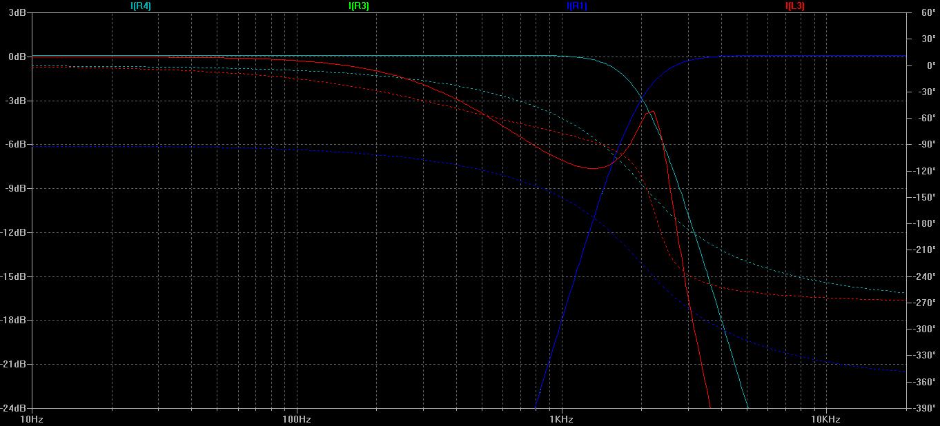

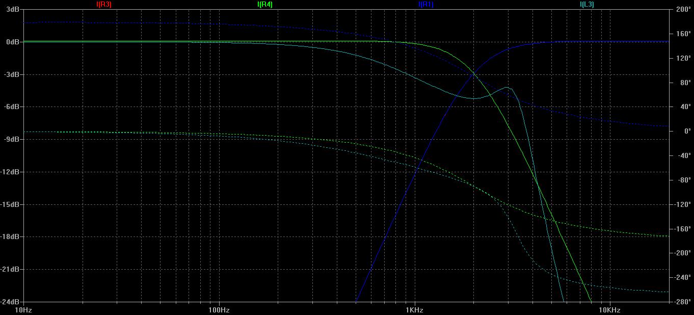

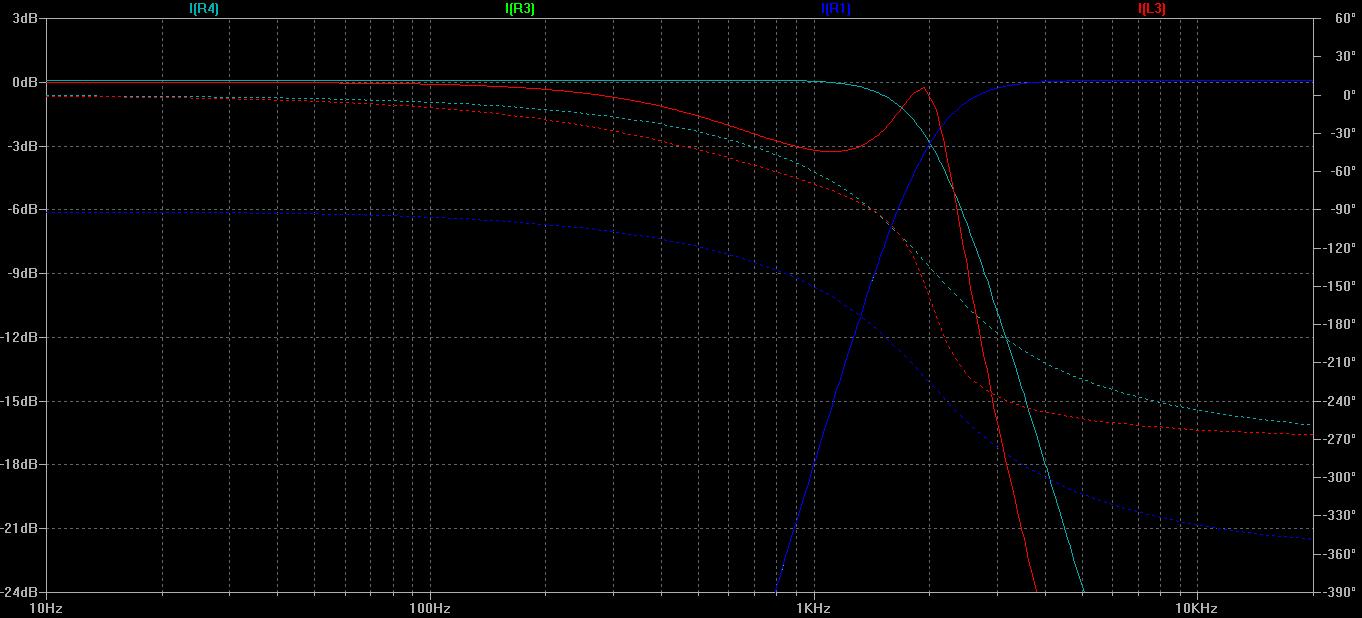

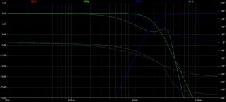

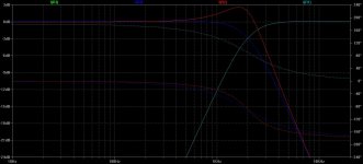

I ran simplified simulations of a symetric Butterworth crossovers at 2000 Hz as follows:
- 1st order with values for 8 ohm loads loaded with 14 ohm load in the LP section;
- 2nd order with values for 8 ohm loaded with 14 ohm in the LP;
- the same as above, but instead the resistor, the LP is loaded with a 0.45 mH inductance with dcr for 6.2 ohm;
- 3rd order with values for 8 ohm, LP section loaded with 0.45 mH 6.2 ohm dcr;
- and in the end, the same 3rd order as above but with values of the LP section for 14 ohm load.
On all simulations are shown the curves of the response of ideal 8 ohm loads and the close to real load for comparison.
(a typical "8 bass driver with not very long 1.5 in (37-38mm) two layer voice coil would have about 0.45 mH Le and 6.2 ohm Re)
As it becomes obvious, you can't avoid Zobel networks and if you take the impedance at the crossover frequency it becomes worse.

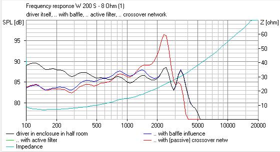

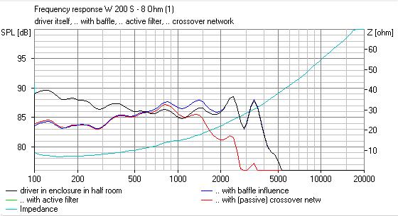

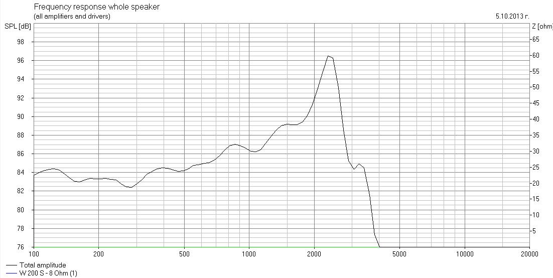

I have Visaton's free software Boxsim. I took the first 8 inch bass driver which happened to be W200S, put it in 30L sealed enclosure and applied a textbook second order Butterworth crossover for 8 ohm load.

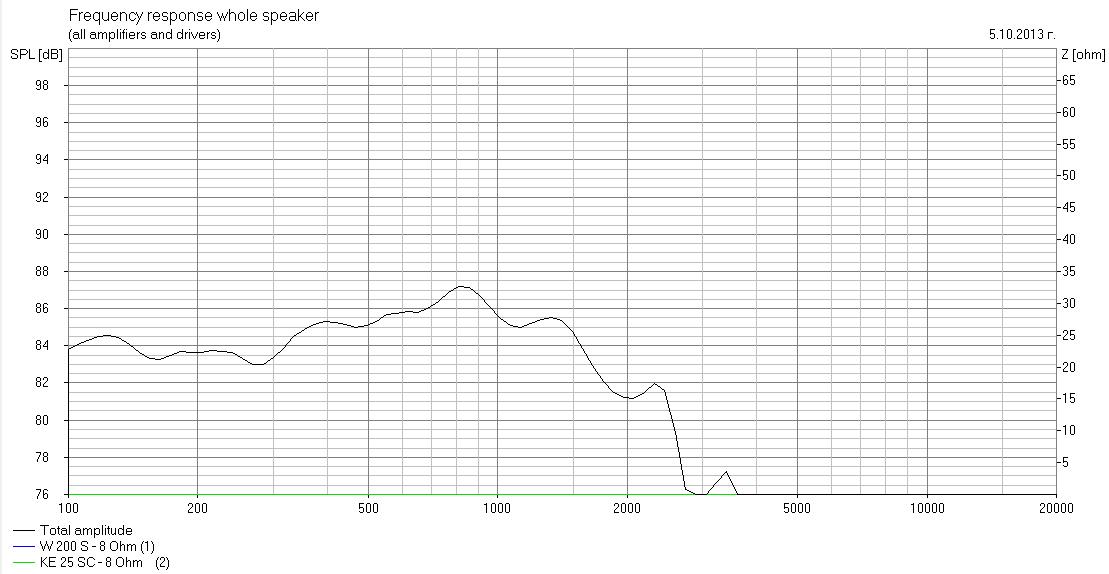

See what happened... I apply SPL curve and another simulation showing the exact influence of the crossover. The scale of the simulation is the same as the ones from LT Spice.
Optimisation is nonsens yet for another reason, it means that the crossover quality factor would be altered. Then the syne wave response might be satisfactory and the curves and phases might seem alright as well, BUT the impulse response and the crossover induced distortion would be unacceptable.
Now let us see what will happen if we design a Zobel and apply it without any other optimization or whatsoever. I designed it with this calculator: Impedance Equalization (L-Pad) Circuit Designer / Calculator using the published data: W 200 S - 8 Ohm
Wow! The ugly peak disappeared!
Values: LP Butterworth crossover 7.03uf and 0.9 mH, Zobel: 7.5 Ohm and 39.1 uf.
