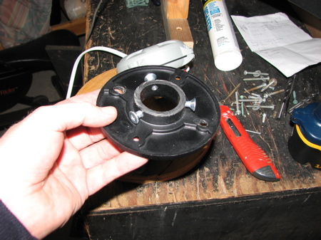

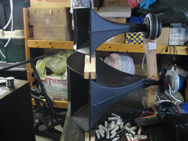

Here's a real budget driver from Selenium. I use it XO'd at 650 Hz on an Altec 511 horn. It's only a mid so you lose some high end but with the money you save you might afford a tweeter. It's a little hot in the middle so you'll probably want a notch filter and maybe some padding.
Parts-Express.com: Selenium D250-X 1" Phenolic Horn Driver 1-3/8"-18 TPI | compression driver tweeter horn driver high frequency 1" exit 1" throat midrange PA driver tweeter driver selenium083108
It's the driver on the lower horn on the right. You'll notice I had to make an adapter for it as I attached it to a bolt on flange.
