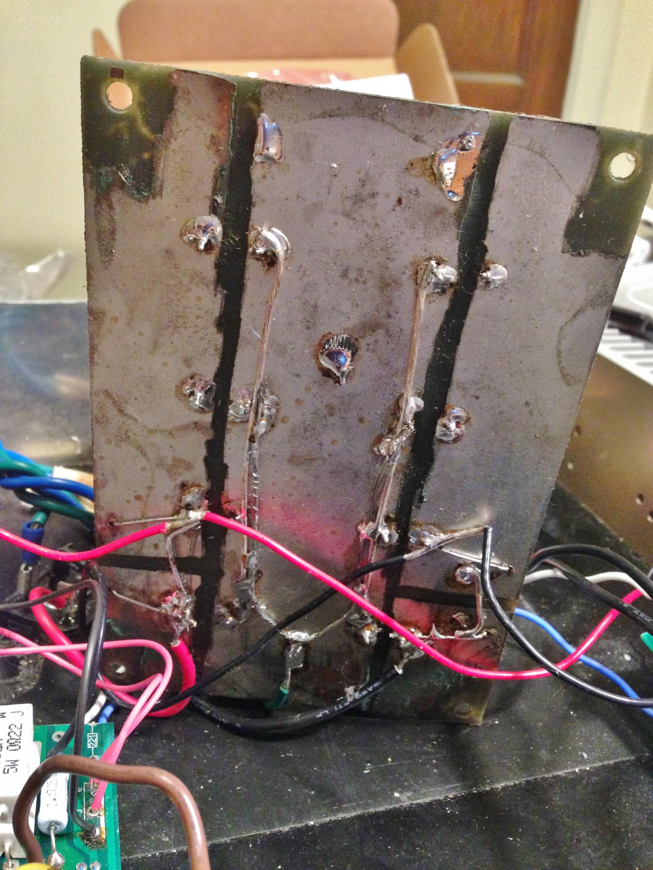

...I thought I'd post some shots of a Rawson I picked up for parts this summer. I know this thread has been silent for a few weeks, but after a friend sent the link to me, I can't resist.
I appreciate the love of building and TR's passion for it (he must have a passion or else there wouldn't be so many of his amps out there), but as I said to my friend, it's a shame because it doesn't take that much more time to do it right. And safely, I might add. Mine also had no mains AC ground, and that rat's nest was the power supply board.

Let's take a moment to consider this for a second -
Look at this photo;
And realize that all of this poorly constructed and assembled metal/wire/trace/solder of this PSU is sitting open and exposed to the chassis with only the standoffs for insulation...
And there is no AC mains safety earth.... :eek::eek::eek:
:whacko::whacko::whacko:
:h_ache::h_ache::h_ache:
Again, we have an excellent example of why these amps are just plain dangerous.

to be frank - taking poor soldering aside and wire takeout points , that psu pcb is just ugly , but completely functional
I never objected when someone's work is ugly ........... only when something is plain dangerous and/or unethical , as is the case with TR's
however , I'm sure that he doesn't care what we are saying around :roflL

as I said - taking poor soldering aside and wire takeout points
as always - great made amps are sum of many great details , while bad made amps are sum of many flawed details ..........
