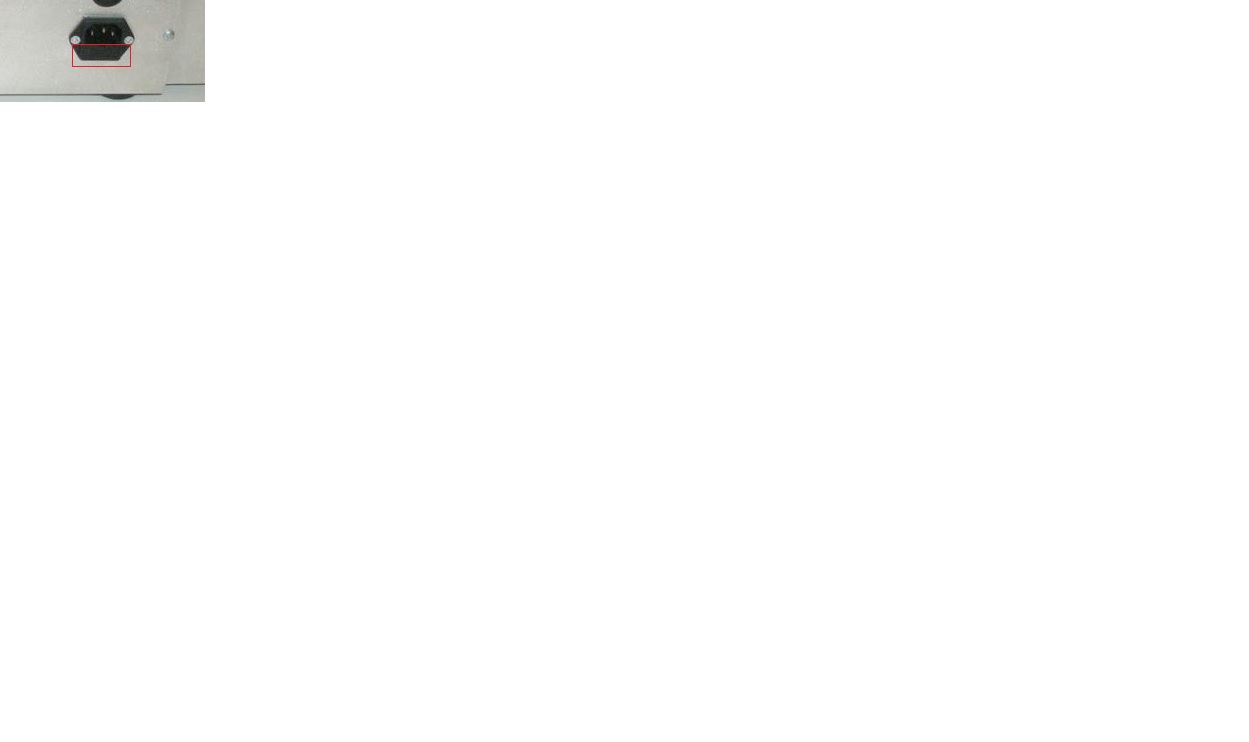

My concern here is that, having seen these photos before, it looks like that the
Thermistor which may be the AC inrush current limiter has no insulation on its
long leads, and may be a hazard.
If it is not the inrush Thermistor, but the ground isolator, then it still looks to
be misplaced, as the chassis must be directly attached to AC Earth.
And did someone say that there is no fuse?
The only important thing here is to confirm that this build is not a shock or
fire hazard.

Are these your amps?
Ok, let's look...
First, the inrush thermistor is not connected in a way that is immediately obvious from this photo, but what I can see doesn't look safe, as one end of it appears to be attached to the primary only by the thermistor lead. It kinds looks like the lead is wrapped around another primary wire on the IEC for a bit of support, which if so is a fire waiting to happen. I would like to see a better photo.
2nd, it's not immediately evident of the fuse is wired in the circuit.
3rd, and this a biggie, there is no 3rd-wire mains earth to chassis. Let me repeat that - chassis is not connected to AC safety earth. Correct that at once, right now, before you use the amps again. If there is a wiring fault live AC will be on the chassis. Which is even more scary as there doesn't appear to be a fuse.
- The transformer centertap is attached to chassis... but not AC safety earth... WTF??
- Woefully undersized filter resistors.
- Is there solder on the black wire attached to the bridge?
-Why, on God's green earth, is speaker black attached to ground through a 3ohm resistor?? Did he ground-lift the amp through the speaker terminal? if so, then it runs back to chassis at the screw where the orange and green attach, completely un-doing a PSU lift, and making some utterly uncomprehensible grounding scheme, all while the transformer is connected directly to the chassis, and AC earth is completely ignored.
If these are the amps you bought, please understand, this is dangerous. Genuinely, seriously, I'm not kidding, I'm not exaggerating, PLEASE DON"T PLUG THESE IN AGAIN until it's set right, Dangerous.
