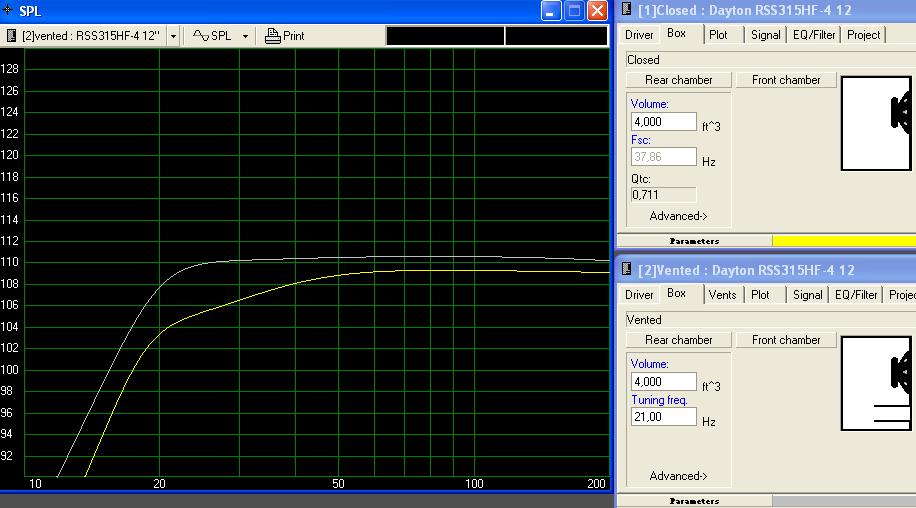

A box suited to a Linkwitz transform is almost always sealed (i’ve not seen any vented ones) so with no hole it ultimately rolls off at 12 dB/octave. Put a hole in it and that becomes 24 dB/octave. Initial rolloff may be slower, and if you are tuning really low a modeler may not show enuff down low for you to see the ultimate amount. Those are laws of physics.
Personally i thing tuning too low to try to get LF extension is a waste of time. If you need max extension then a TL of some sort.
I have a good modeler (WinISD does not easily run on my computer and it is kinda crude) and have been using it for more than 2 decades with 100s of different drivers).
