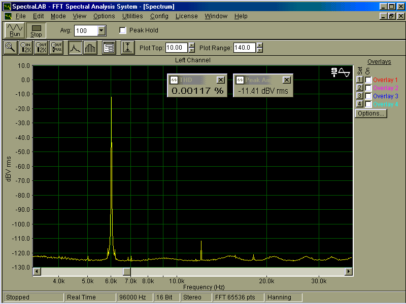

Re: Re: 100mV Line Level
Michael,
this one is measured by Sound Blaster Live! 24bit/96kHz external USB. Only 16 bit resolution used. The FFT noise floor is then
6.02N + 1.76dB + 10log(M/2)
where N is a number of bits and M is a number of samples in the FFT record. For 64k samples, the theoretical noise floor is -143dB. The generator is a special low distortion one developed by a colleague of mine.
Pavel
Ultima Thule said:Pavel,
What kind of Soundcard etc. do you use for your measurements?
Michael
Michael,
Pavel
FFT is a narrow band analyze, according to number of samples you analyze noise bandwith of less than 1Hz. Just read the specs of opamps to see what are the numbers related to sqrt(Hz). This is above the range of DIY forum, try to study a bit about FFT. Remember that the graph does not show the rms quantization noise level.
-120dBVrms = 1uVrms
-140dBVrms = 100nVrms
-120dBVrms = 1uVrms
