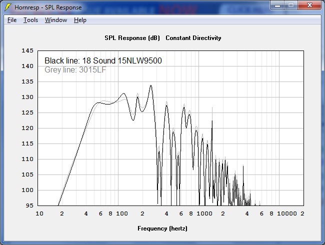

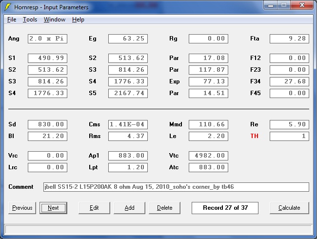

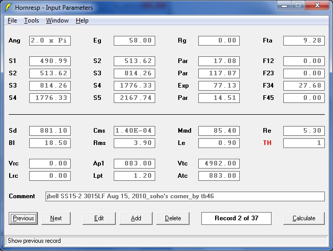

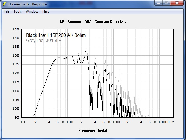

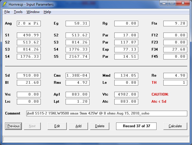

Other Eminence Kappalite 3015lf (‘old’ version) replacement suggestions for SS15:
Neodymium magnet system:
18Sound 15NLW9500 4Ohm (335Euro – Xmax 9,0mm - Note: only the 4Ohm version)
B&C 15cl76-4 (200Euro – Xmax 7,0mm - Note: only the 4Ohm version)
Eminence Kappalite 3015lf (190Euro - Xmax 9,6mm - Note: new version)
Faital Pro 15FH500 (185Euro – Xmax 9,3mm)
Faital Pro 15FH520 (250Euro - Xmax 9,0mm)
Monacor SP-15/500FH (194Euro– Xmax 9,3mm)
Traditional magnet system:
18Sound 15W700 (175Euro – Xmax 6,5mm)
Monacor SP-38A/500BS (170Euro – Xmax 6,0mm)
P.Audio C15-600EL (180Euro – Xmax 5,3mm)
RCF L15P200AK 4Ohm (245Euro – Xmax 9,8mm – Note: only the 4Ohm version)
Eminence Definimax 4015LF ($200-9mm)
BMS 15S330 ($180-10.5mm)
BMS 15S430 ($222-10mm)
P.S.
The JBL method of measuring x-max is not known to me, the 6.5mm figure in post #22 may be higher with the +(1/4)GH method.
BMS, I added +(1/4)GH to the data sheet values.
Faital Pro, they use +(1/3)GH, so you need to subtract a bit from their numbers to compare.
Eminence, the old method (several years now) was coil overhang only, new method includes a percentage of GH.
P-Audio, coil overhang only, you need to add +(1/4)GH.
RCF and 18Sound both use + (1/4)GH
JBL originally never added anything so maybe you could add + (1/4)GH with their Xmax (depends on how you want to compare)
Monacor doesn't produce any drivers themselves (at least 5 different third parties) and it's very difficult to get hold on reliable information. Probably you have subtract (1/3)GH for the drivers mentioned in my earlier post.
