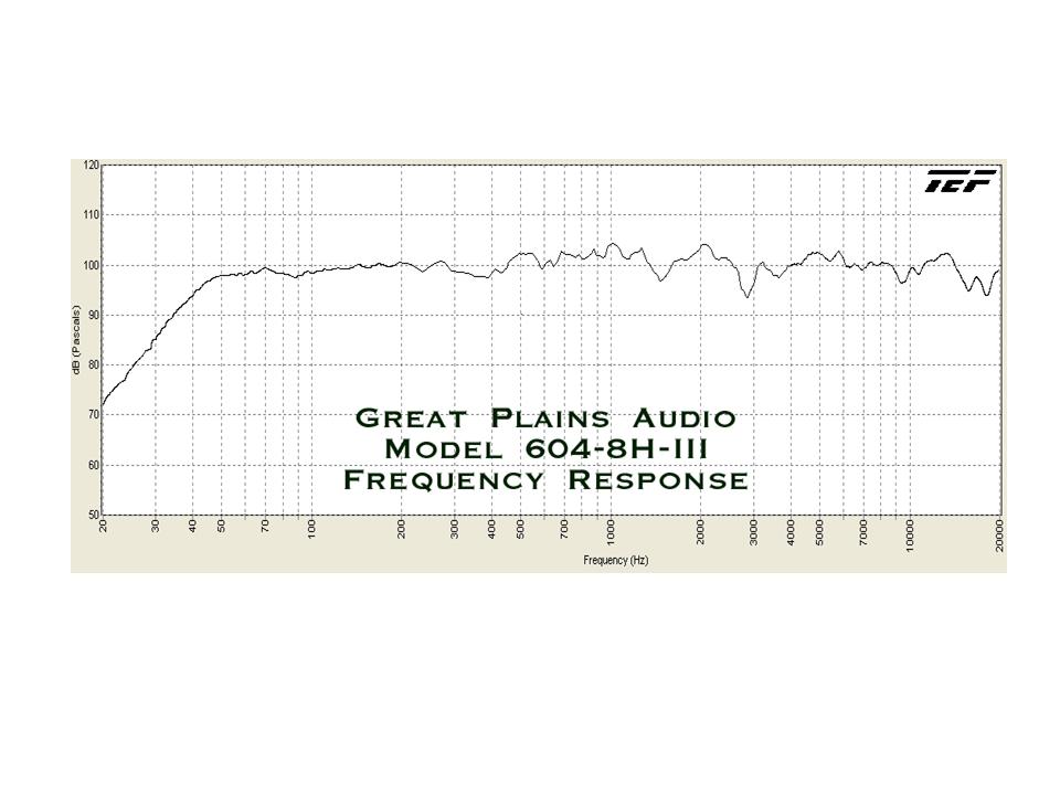

norman bates said:And not even a frequency response graph ?
aluminum diaphragm ? Mylar would be better...........
Norman
Great Plains Audio 604-8H-III frequency graph
http://www.hostboard.com/cgi-bin/ultimatebb.cgi/ubb/get_topic/f/3729/t/3779
Personally, I only build 3-way dipoles using a midrange that can cover 80-1,500+ Hz human voice. 95db/watt seems to get the best combination of sound quality and dynamics.
Looks about 1/3 octave. Typical Altec quality. I like 'em. Ever since I first heard / saw a 604 a year or so back, I liked it. People praise it, and it's a classic for a good reason -that they've heard a lot of other options, and it still comes out favourably. I don't think the BO$£ analogy is particularly apt in this case, if you'll forgive me for disagreeing with you. Sure, there'll be a few sheep around who can't / won't think for themselves; there always are. But the 604's reputation wasn't made by them. It's certainly far from perfect, nor to all tastes, but then again, what is?

AFAIK, the GPA driver is actually a newly manufactured Altec 604, for which they purchased the original tooling. Which means that it's a drive unit that many regard as one of the greatest (if not the greatest) of all time. Especially with the Mantaray CD horn that the late models had.
Yeah, I was thinking that, tho decided to give it a miss based on the considerable efforts taken by a lot of DIYers in trying to take some zing out of them (lots of x-over work) and some comments raise some concern that their presentation may not be to MY liking. I'd still love to hear them, but I think there may be speakers better suited to me at this stage. Hell, a Pi 4 in top spec with their wood horn and new x-over could well be a speaker more to my liking. Of course, none of these are true wide-rangers.
BTW, the new version 604 (III) with the Urei (?) horn 'should' be 'better' than the prevous version with the Mantaray.
Cheers
