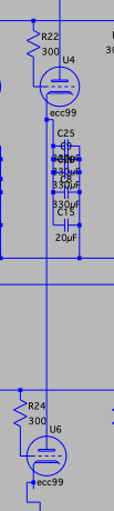

current hogging with paralleled tubes of very high transconductance is the issue with such tubes, so cathode resistors are used, you can use higher valued resistors and then capacitor bypass them so as not to reduce tranconductance.
i know that tubes like the 6c33, 6336, 7242 are prone to this issue of current hogging, but for tv scanning tubes, i am not so sure, perhaps the tube gurus will chime in...
sorting tubes by cathode currents can be costly too, unless you get the for a dollar each and you have lots of them...
You mean like this? It's also possible to run a separate line for the feedback. It doesn't matter too much which tube (ecc99 here) but these are kept in siloed pairs.
I did that just for solving the variation of tube tuning!

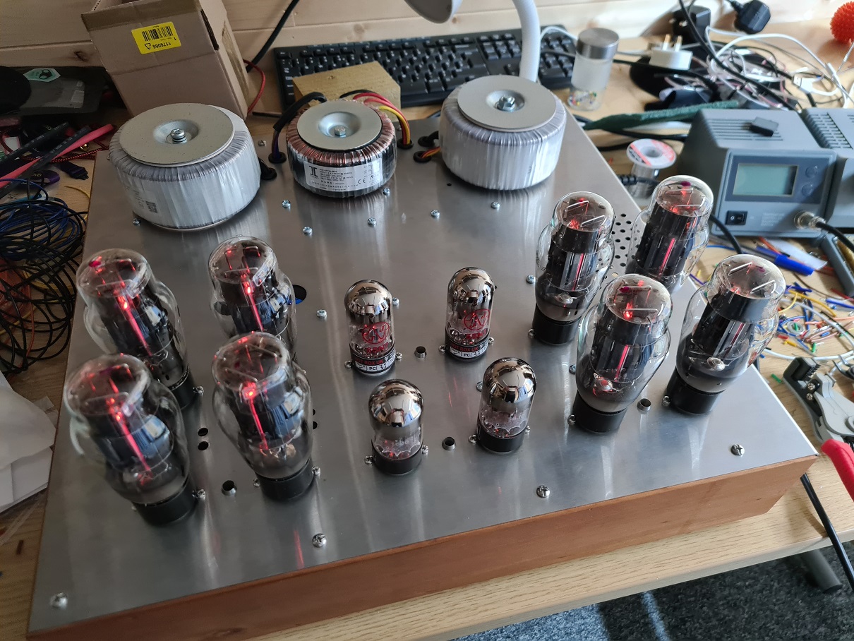

Well, after a few delays, amp No.2 is now alive and pre-conditioning the output tubes. Amp No.1 is now ready for having the HT wired up, having spent a week with just the filament supply connected, so will hopefully get that on the test bench this weekend. So if all goes well, it's music time next weekend :D
Steve.

Ooops, forgot to ask.
Will be putting fuses in the +ve rails for each output stage. What value is recommended? I assume they should be slow blow types.
Thanks.
Steve.
I would not fuse the rails of the output section! If one fails but not the other the amp can push DC.
Instead fuse the primary of the B+ transformer. Depending on how much capacitance is present you might be able to use a fast blow fuse. But generally we use a 3A slow blow.
you can not have current hogging with just a single tube, it has to be two or more tubes in parallel....
but bias runaway with single tubes is also possible......
Agreed. That PP stage has 4 of those stages (4 tubes) for class A operation as a small headphone amp with a CCS for each pair plus the danger becomes the output caps. I remember Broskie’s making a point about cathode resistors (10-30R) for the 6as7 being needed for stability.
Amp No.1 is working
Have now got the first amp up and running. Measuring around 17V RMS at the onset of clipping, so getting around 40W out of the amp which I am happy with. All appears to be OK. Easily managed to zero the dc on the output, and there is very little variation once it has settled down.
One thing that I have noticed is that the frequency response starts to roll off above 10kHz. I am assuming it should extend significantly beyond this, so can some-one point me in the right direction to look at what may be causing it.
Apart from that all looks really good. The tubes measure up reasonably consistently in terms of quiescent current at idle. Voltages across the 5 ohm cathode resistors are generally between 0.25 and 0.3V so we've got 50 - 60mA running through the tubes.
Looking forward to getting the 2nd one running and listening to some music.
Steve.
