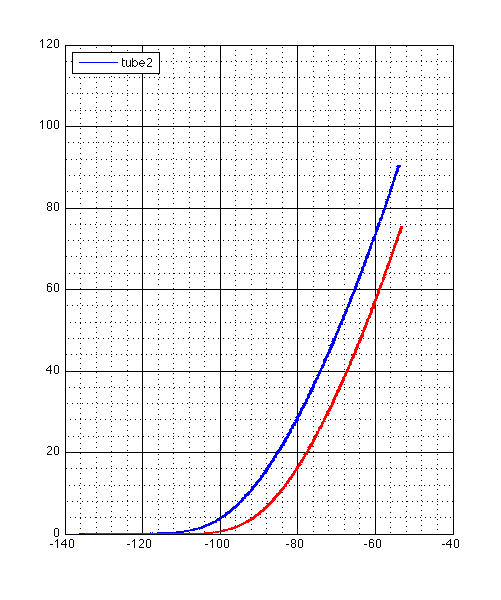

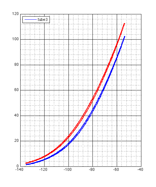

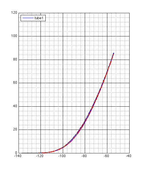

3. When matching tubes, what criteria should one use, matching on a certain input giving a certain output or a certain change in input giving the same rate of change (steepness?) in the output of the two tubes? Or both perhaps? I understand that matching is not an issue with the M-60 but I had to grab this opportunity as there are so many people here that would know the correct answer.
I'm wondering just the same thing. I've begun to measure the curves of some 6H13C and I'm not sure how to match. Similar slopes makes sense to me, though I can see how this will compromise distortion levels as the power is ramped up. I attach a few tube curves where I compare the two triodes. x-axis is grid voltage, y-axis is cathode current, the cathode resistor is 100 ohms, so some degeneration is going on. Plate voltage about 160 V.
Good, so the question has some general interest maybe.
I agree the slope is probably the most important parameter. If the steepness is the same then maybe if they start rising a bit apart, is perhaps not that important. This statement is probably dependent on in which circuitry these two tubes are being used.
Nice curves!
